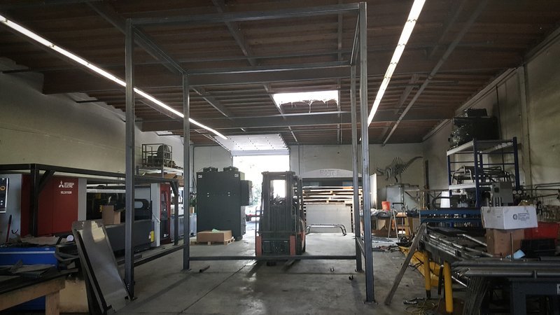

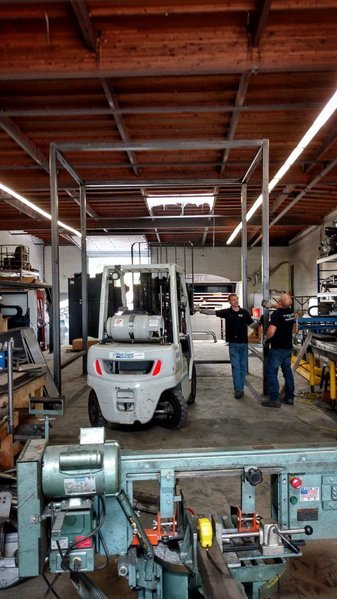

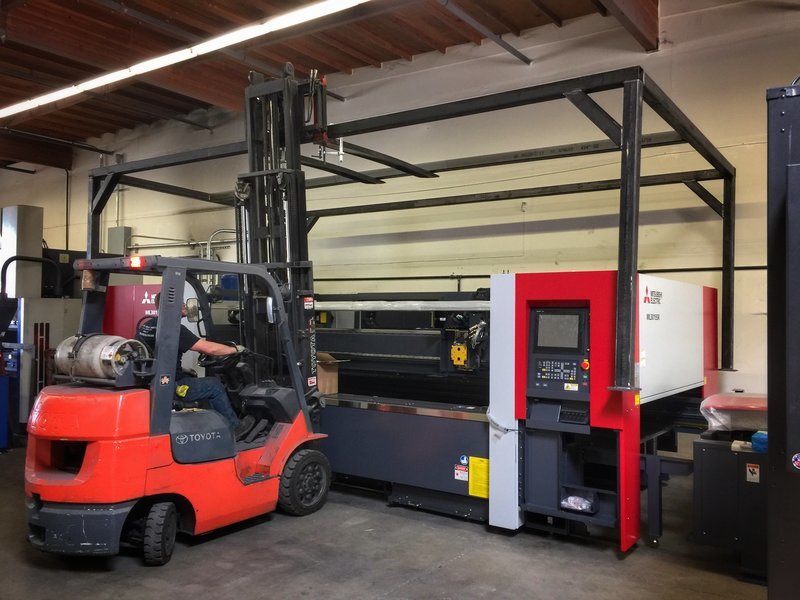

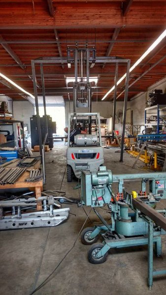

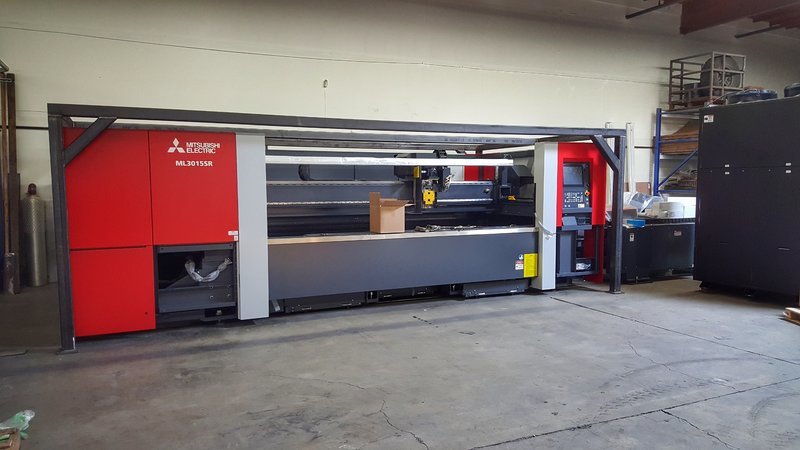

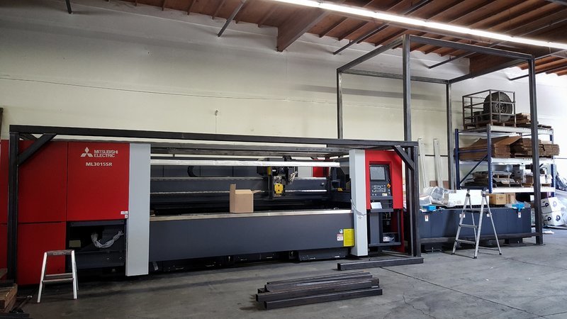

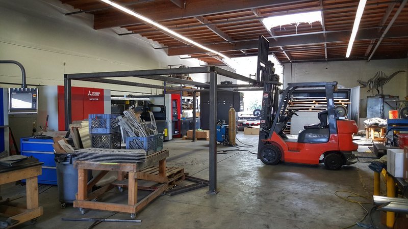

    The mezzanine and sheet storage rack is just about complete. The mezzanine is 21'x11' and 7 feet tall the cooler and dust collector will be mounted on top of it. The plate storage rack is 12x9x14 feet tall to store all of our sheet material.
    It was pretty ass puckering lifting the mezzanine over the machine but we got it on without a scratch.
    There is still a lot of work to do but we should have it all ready in a day or two.

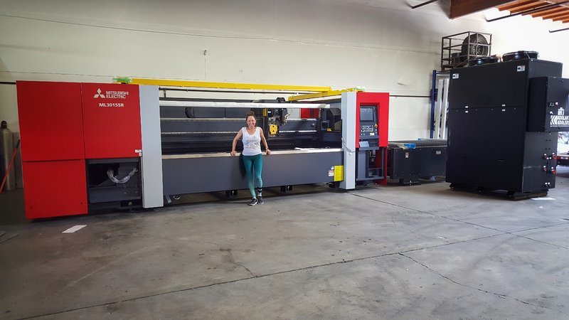

    my wife is tiny also.
    but my machine isnt..

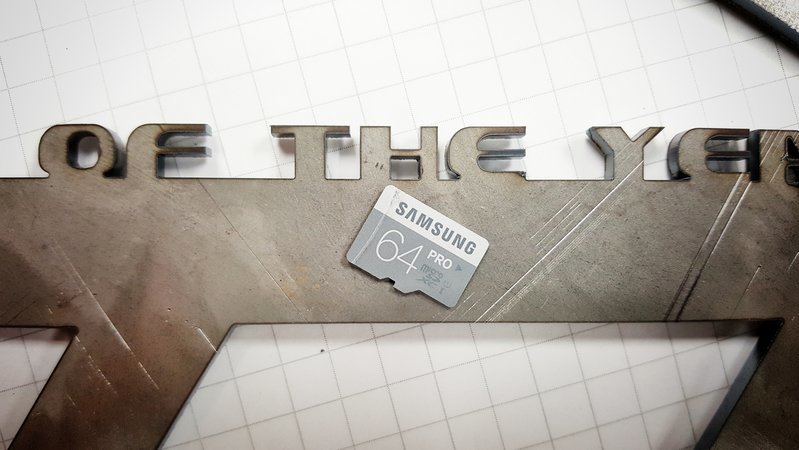

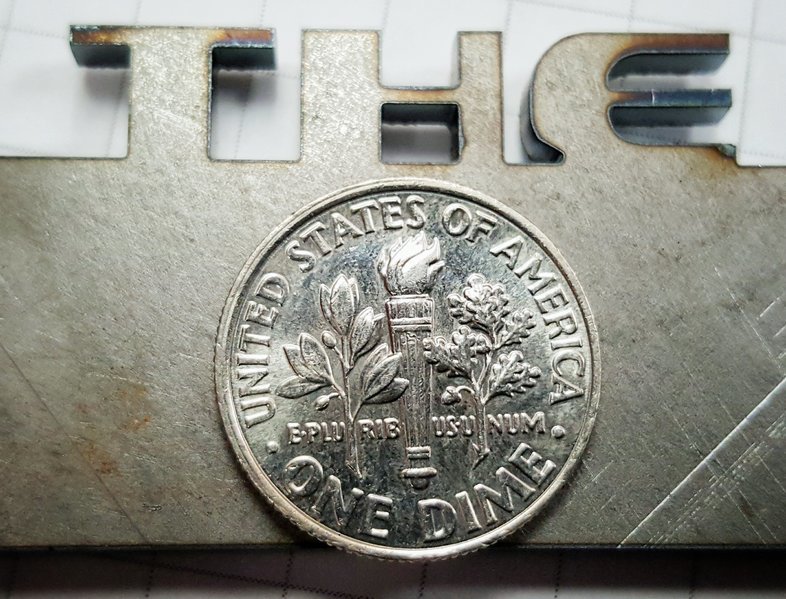

    Finally running testing on the machine. Testing the capabilities cutting tiny little letters.

    Judging by the size of the letters, I'd say it's thinner. Them some tiny letters. I might need your services Jerry. I want a small stencil made for my fab garbage.:thumbsup:

    It's a micro SD card (even smaller). :eek:

    11 gauge so .117" thick the middle of the E is .035 the thickness of welding wire. The Micro SD is there for comparison I figured just about everyone has one in in this day and age.
    Here it is next to a dime.

    Yeah even the installer was impressed with the outcome. The machine is very new so the installers don't even know what's it capable of I'll be sure to test it to show them. it's one of three in the US and number 18 in the world.
