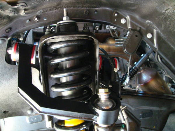

    or coil inserted wrong?.... anyone have pic

    I installed the lift a week ago and immediately had to order new UCAs...not because of alignment issues, but because the UCA hits the coil on droop. New UCAs fixed it all and even on complete droop with front lifted on a jack, no rubbing and plenty of space.
