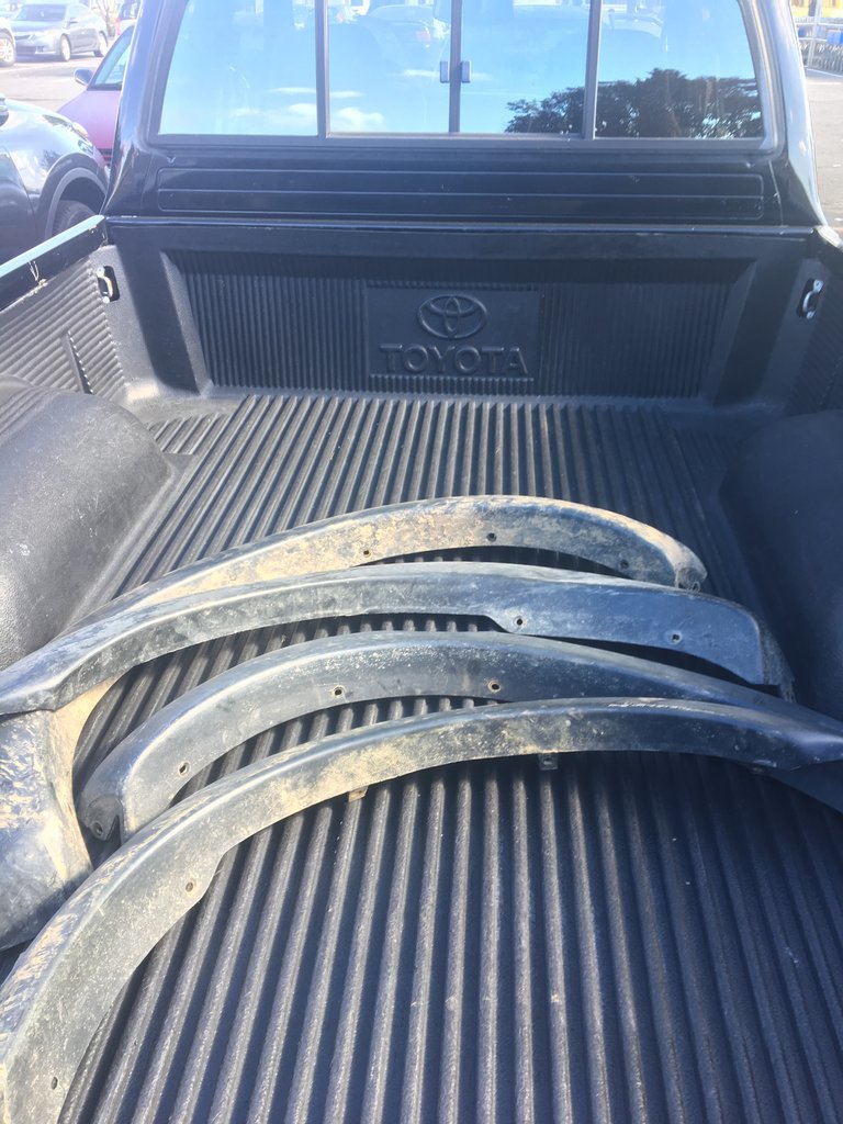

    Picked up some '01-'04 fender flares off Craigslist for $100. They're a little beat up, but with some paint they'll look great.

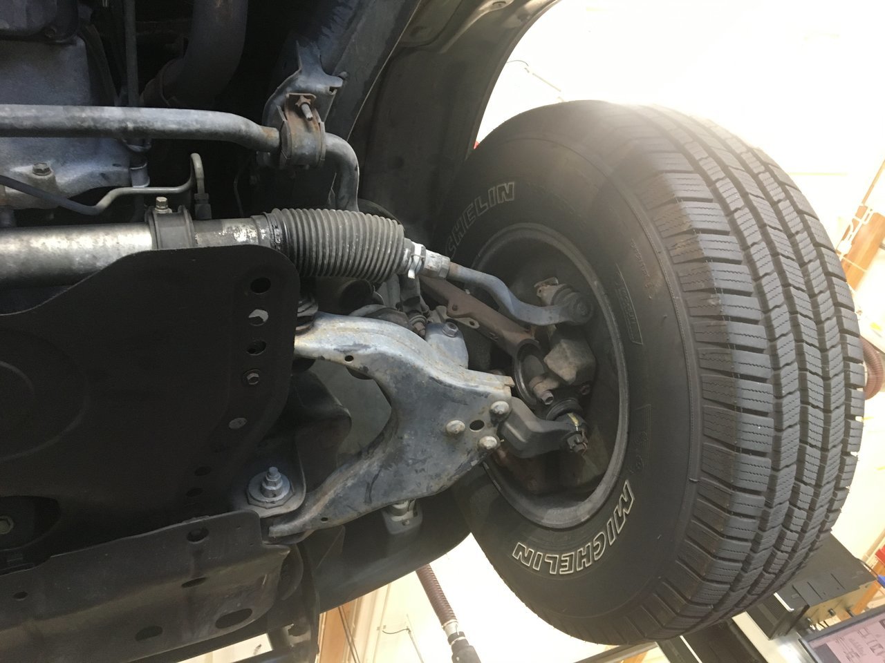

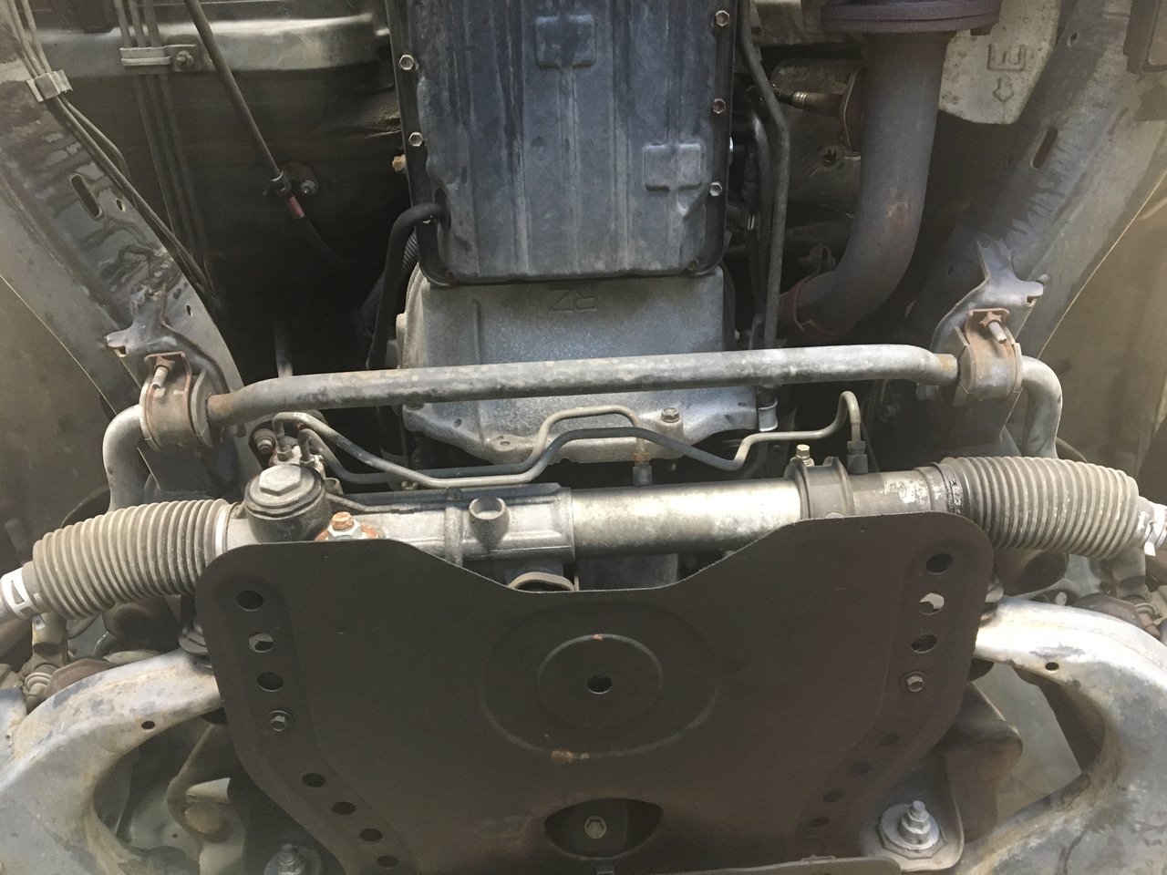

    Lifted the truck on a rack today to inspect the underside. Gotta love California and the non-existent rust. Carrier bearing/driveshaft has zero play, no oil leaks - nothing out of the ordinary.
    And yes that is the original 1998 dealer provided full sized spare. If you look closely you'll see a green sticker on it that says "DEALER".
    I'm planning on flushing the rear differential fluid since soon since I have access to this great shop at my college. Anything else I should do while I have access to the lift?

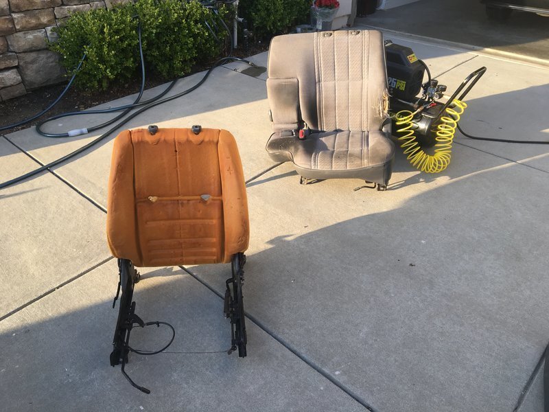

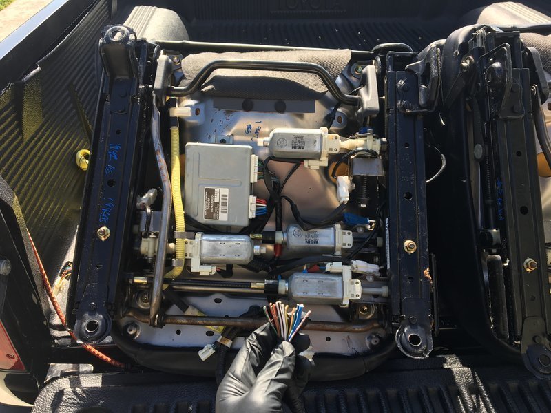

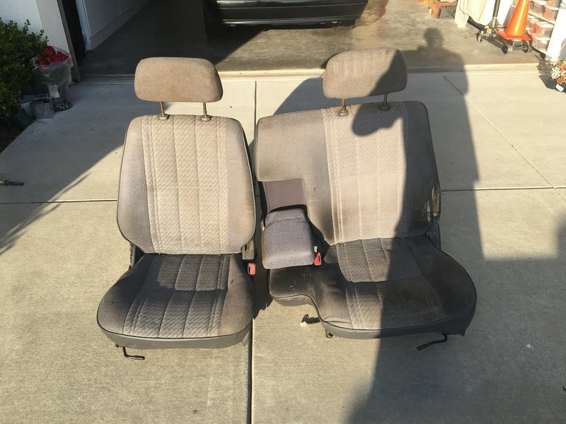

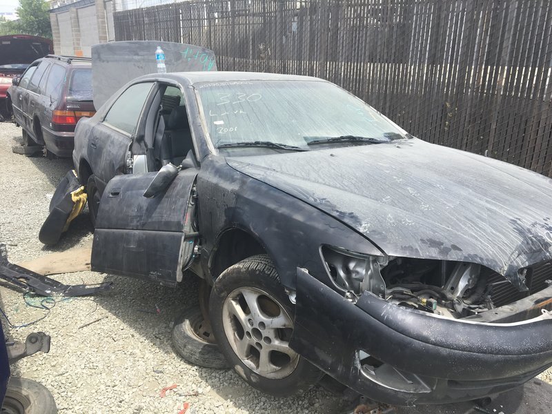

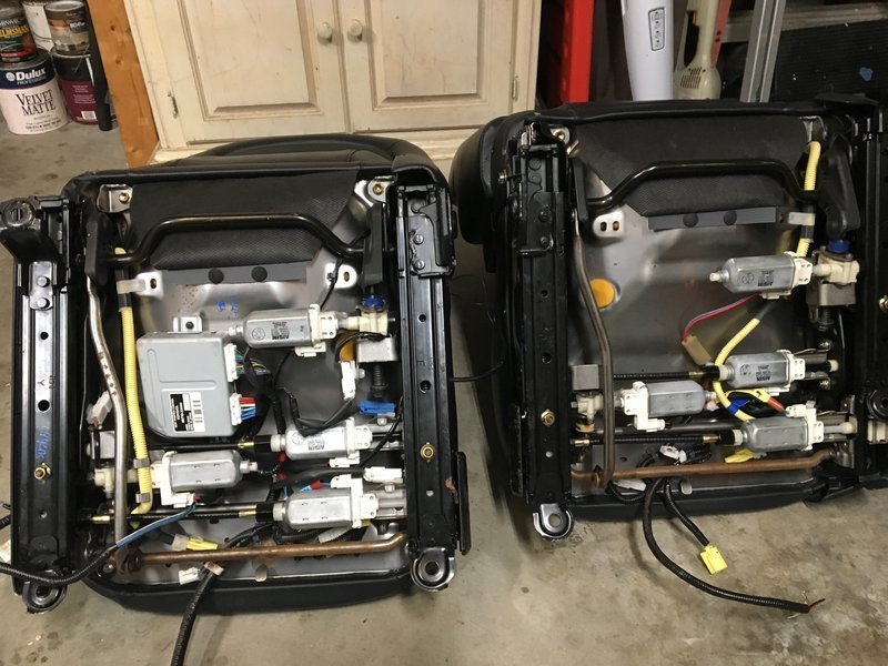

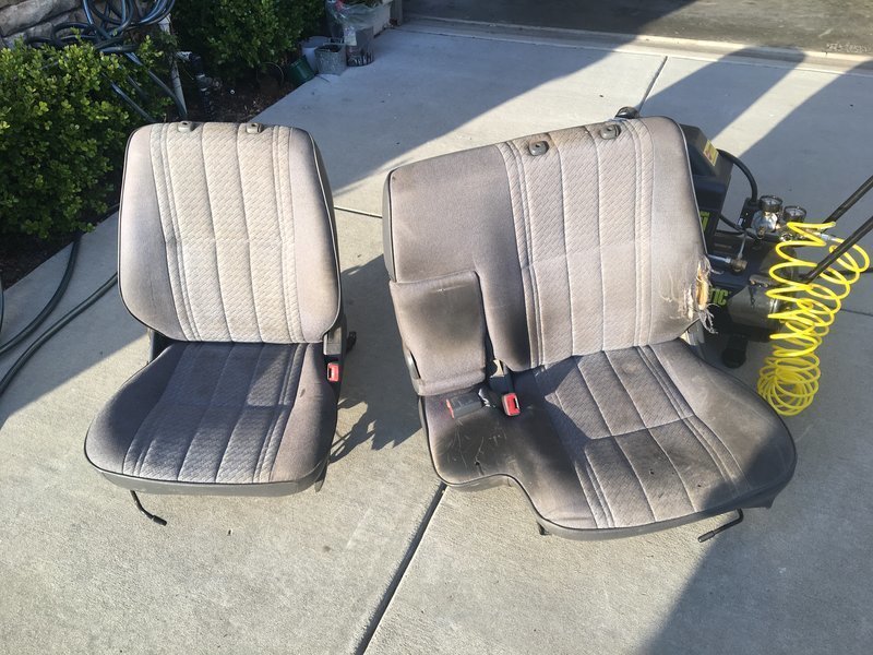

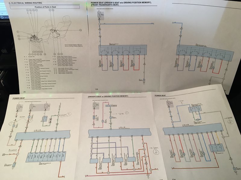

    Here are some photos taken from my Lexus ES300 Power Bucket Seat retrofit thread. I bought some old 60/40 Tacoma seats (beat up as hell) and ripped them apart until I was left with only the mounting rails. My plan is the cut off the feet of the Lexus seats and weld the Tacoma rails onto the Lexus rails while attempting to keep the original Toyota sliding mechanism intact.
    The hard part is the wiring, finding the FSM was hard enough. Trying to figure out what the hell all these wires do is even more difficult.
    IMG_2035.jpg IMG_2036.jpg IMG_2042.jpg IMG_2049.jpg IMG_2134.jpg IMG_2148.jpg IMG_2197.jpg IMG_2145.jpg

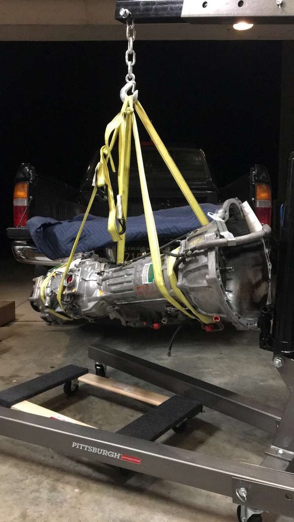

    Well, looks like my PreRunner conversion is happening. I'm driving up to Nevada this Friday to pick up an A340F, 4Runner 4.30 Front Carrier, and some other small parts. Hopefully I can get this done by the end of the summer.

    Nice! Is that a little extra something between the tranny and transfer case?
  17. Jul 22, 2017 at 1:43 PM
    #17
    BartMaster1234
    BartMaster1234 [OP] American Auto Horns
    Aug 21, 2016
    #195197
    42,605
    Tyler
    San Francisco, California
    Flux Capacitor
    Is there? I don't think so.
    I bought this as a package deal, the t-case came attached on the tranny. It came off of a 1999 Tacoma 4x4 2.7l, so it had the same drivetrain as me. Hopefully nothing changed between 1999/1998 which is my truck's model year.
  18. Jul 22, 2017 at 1:44 PM
