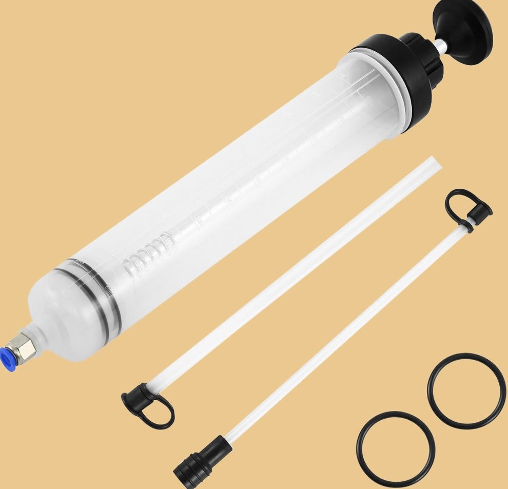

    I see - the current fluid in there is definitely brown/black now. How difficult is it to suck the fluid out? Does it need to be drained from the bottom somehow like oil? Is it then not recommended to add new Dextron III fluid to the old, dirty fluid int he tank?

    You just find a suction gun that can get in and you suck out a bit, put in fresh red fluid while its running.
    Cycle the fluid until you use a quart/liter, call it good.
    It's just a hydraulic pump so it needs to be running during this process.

    I see - so you're saying the Dextron stuff is dyed red when new?
    Why does the engine have to be running when using a suction gun? I've never used one before.

    The factory is dextron but no dye.
    Transmission fluid is a detergent and it needs to be cycled through during the process, or it would take ages to clean out.
    So you suck to the "low/min" line, fill it up to full, and turn the wheel a few times. Repeat.
