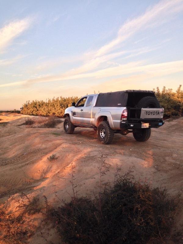

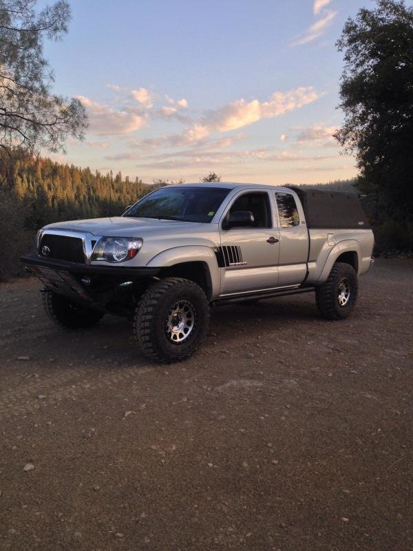

    Softopper plopped on

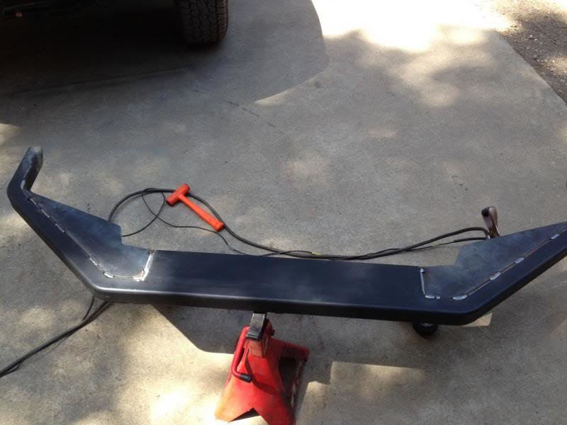

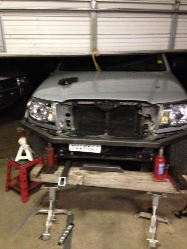

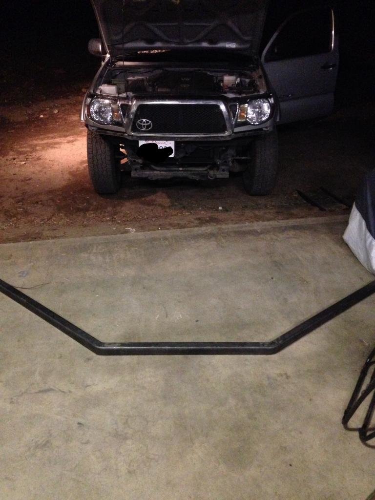

    I made a bumper, deer creamed the old one

    When all u got is a nice tig welder, a cutoff wheel and a ratchet strap to make those nice bends in square tube, time consuming but final product is bitchin

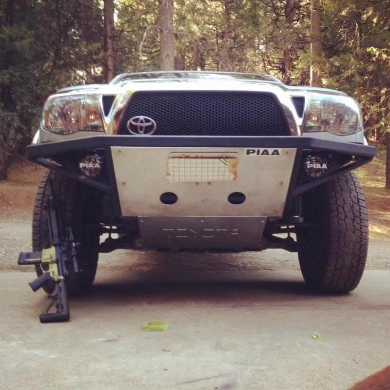

    Got my new lights mounted up today PIAA 510s

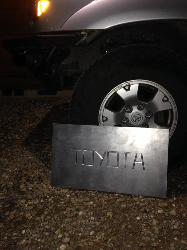

    Machined up a lower front skid, welded the mount tabs today

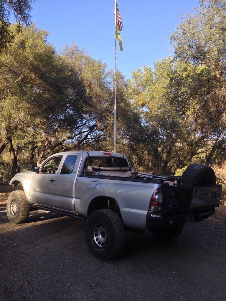

    took her up to service today

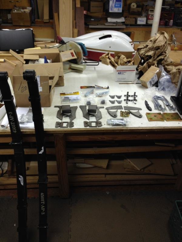

    imagejpg1-4_127bb86971e49954dd3142c42653a105b6039aa9.jpg, came home from work, had a bunch of stuff show up while I was gone, springs, u bolt flip, limit strap clevis', resi mounts, bamf shock tower kit, cab chop plates, kings should be here maybe this weekend, and waiting for new bumps but that wont stop me from the big stuff

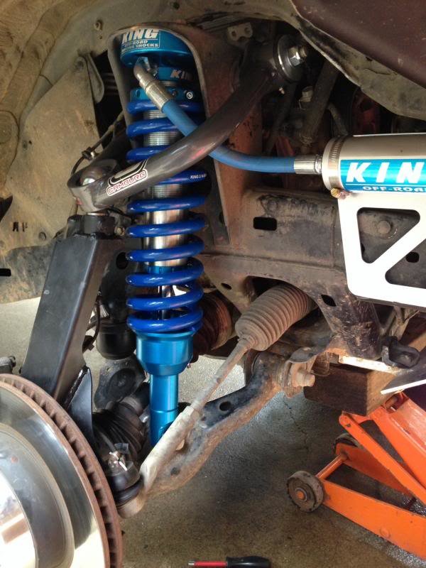

  11. May 30, 2014 at 6:53 PM
    Basikbiker
    Basikbiker [OP] Well-Known Member
    Sep 21, 2013
    #112968
    3,963
    Trav
    09 AccCab 4x4 spaceship
    My doors are the only stock things left besides the headlights
    Just showed up today king 2.0 12" resis, for the back

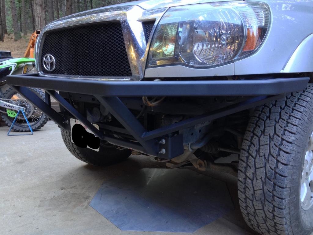

    Do you have anymore pics of your bumper showing the build process? Also, do you have pictures of how you relocated/added a new cross member?

    SIIIICK! Lets see them Kings installed in the back with your rotation kit :drool:

    No pictures, but it wasn't difficult, sawzall right below the frame rails, be very careful not to touch the radiator. Get sum square tube(I had sum extra 1" left from bumper) trim to fit in between the rails and weld er up. And if your mig welding cover up your radiator!!, but if you TIG:D much more peacefull, sorry if I'm not scientific, if your competent with power tools it's really easy. Also, my bumper is braced between the two mount points as well so it's like a removable doubler. And if I'm not mistaken prerunners don't even have the crossmember on the front?

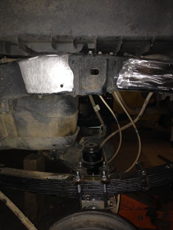

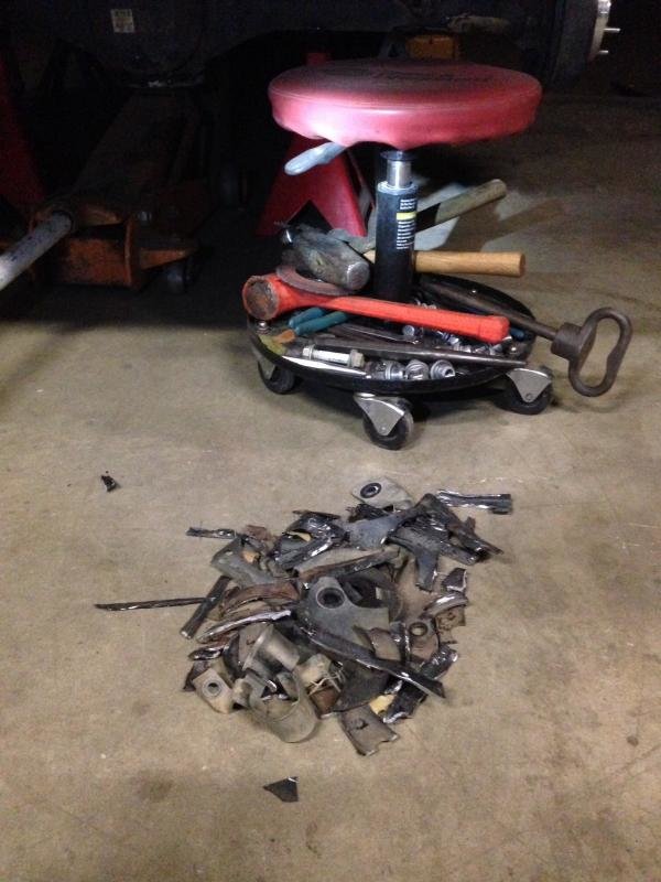

    Progress so far on the rear, been workin on this steady for 2 days now, pain in the butt getting the old towers off the frame, axle mounts were easy to cut off
    I'll have the shocks mounted in there today I think

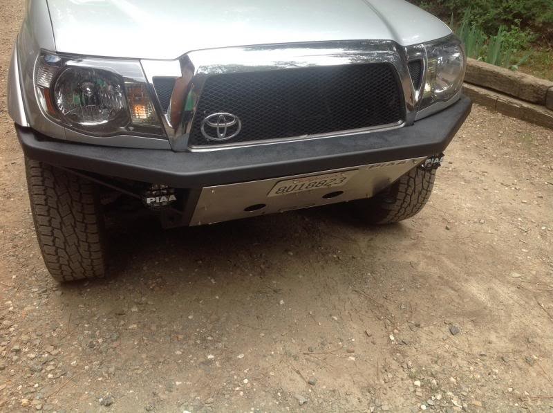

    Bumper build up:
    And just throwing this out there, if anyone is interested in having a bumper like this made for them, I'm willing to fabricate (sum money included of course :)
