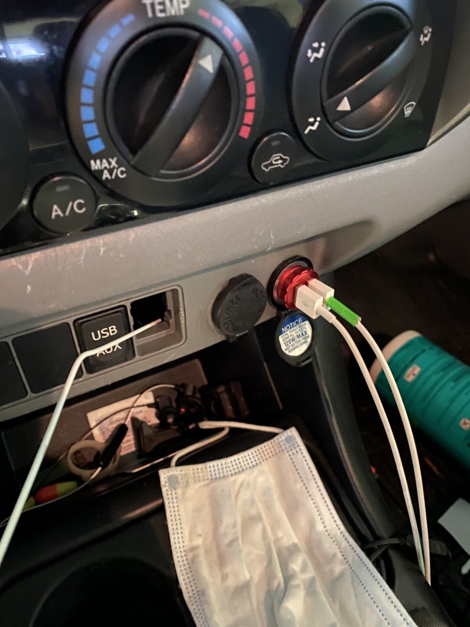

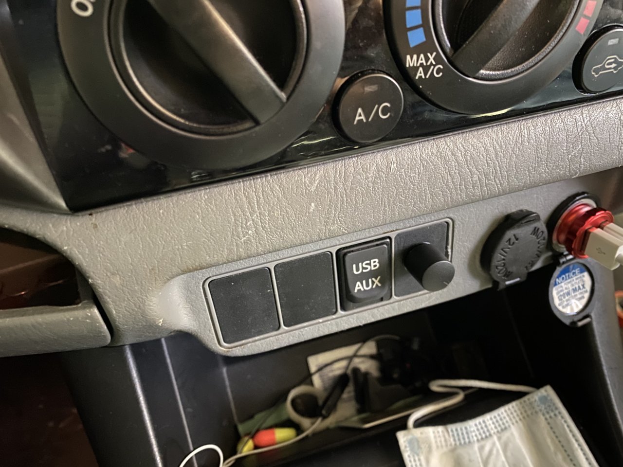

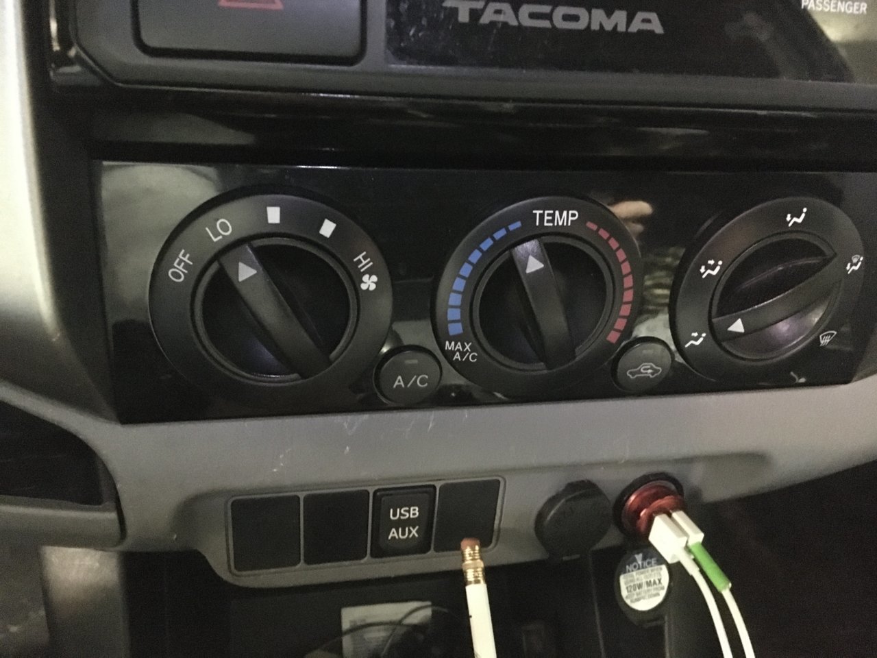

    Looking for ideas on where to mount an amplifier level knob. I’m wanting to mount it in one of the blank switches below the climate control area in the center console. Somewhere that the passenger can reach also. Any thoughts and pictures would be great.

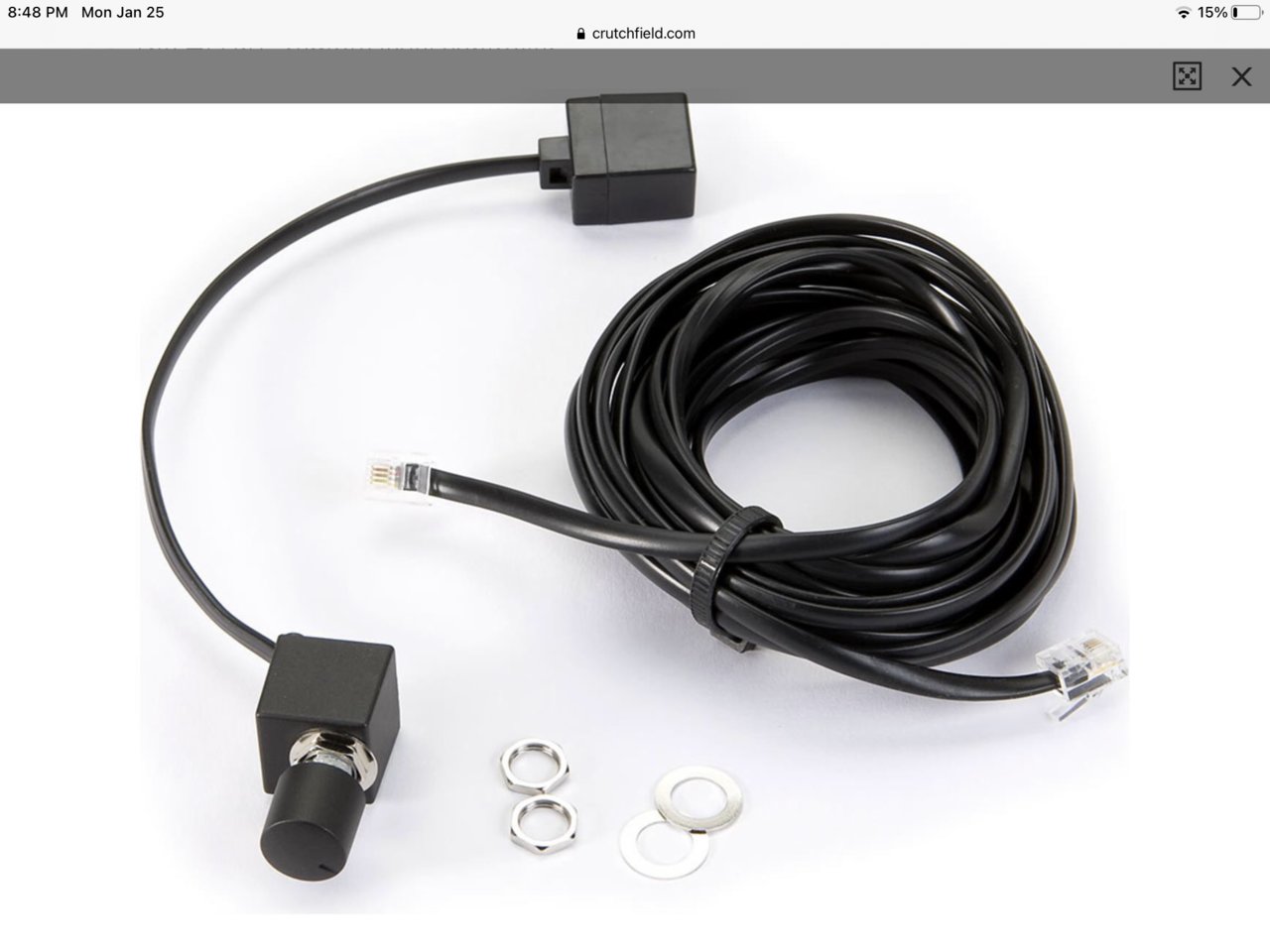

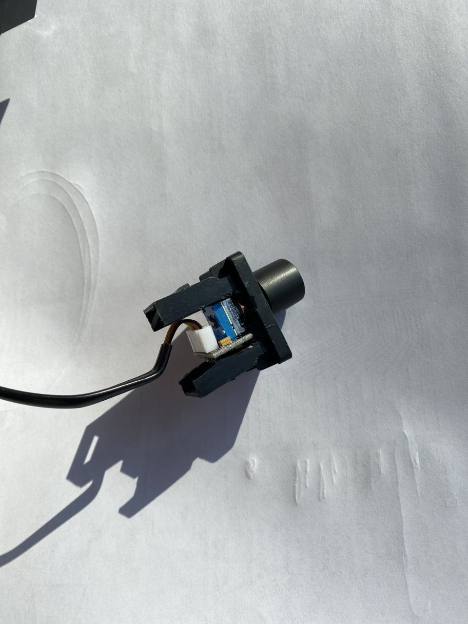

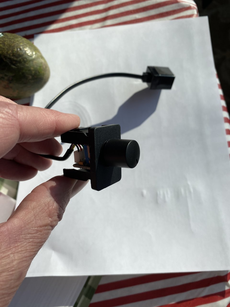

    I trimmed the empty switch with a box knife and took the knob out of its housing just to make it fit easier. It’s a JL Audio HD-RLC. My amp is really a marine amp.

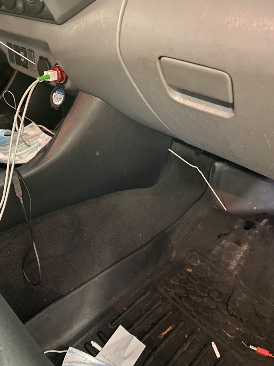

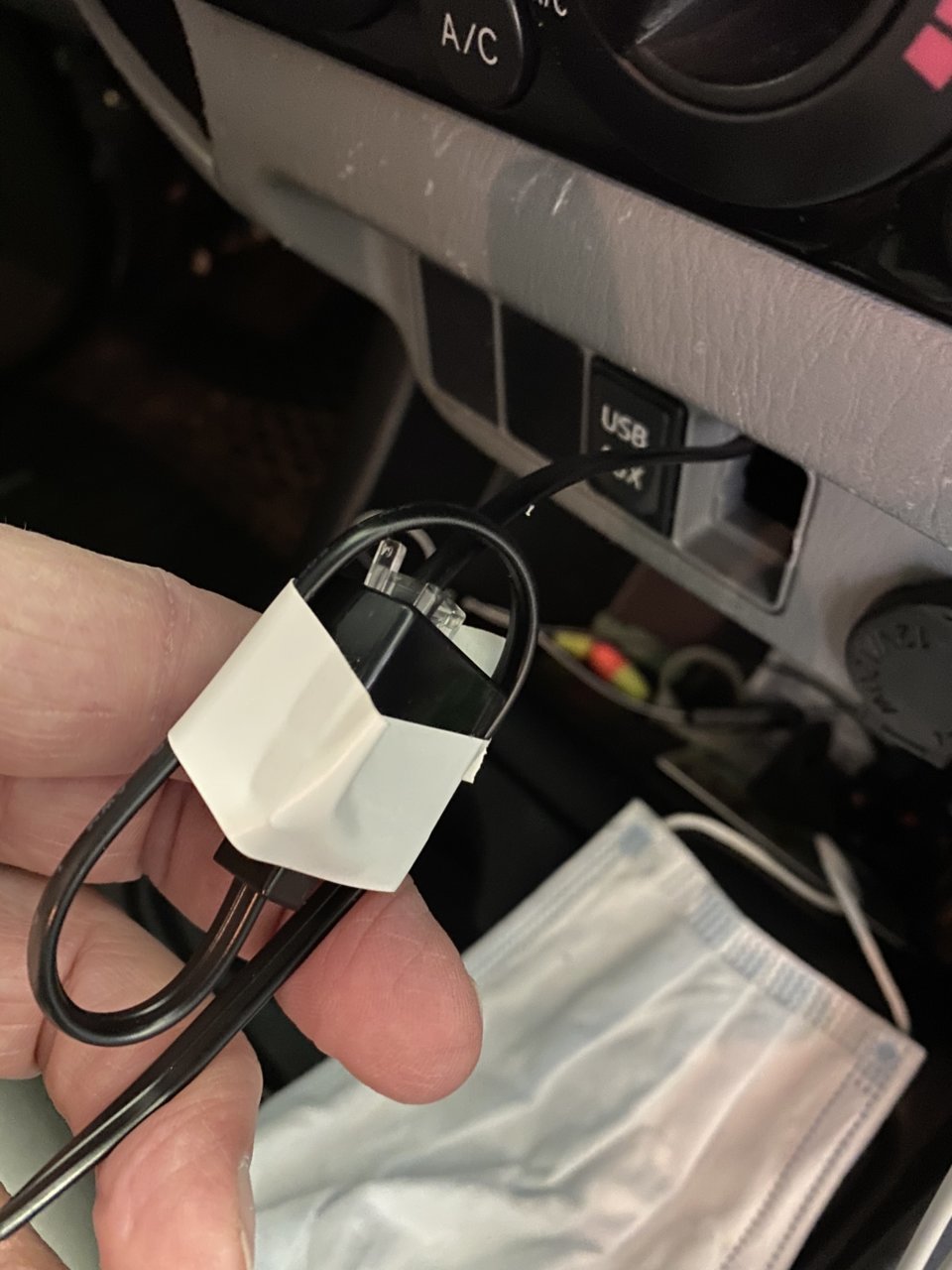

    I put a coat hanger wire from the switch side toward right side of console and it was super easy. Then pulled cable up and plugged it into the control knob.

    I am glad I am not the only one who has stray face masks all over the floor of my truck LOL
