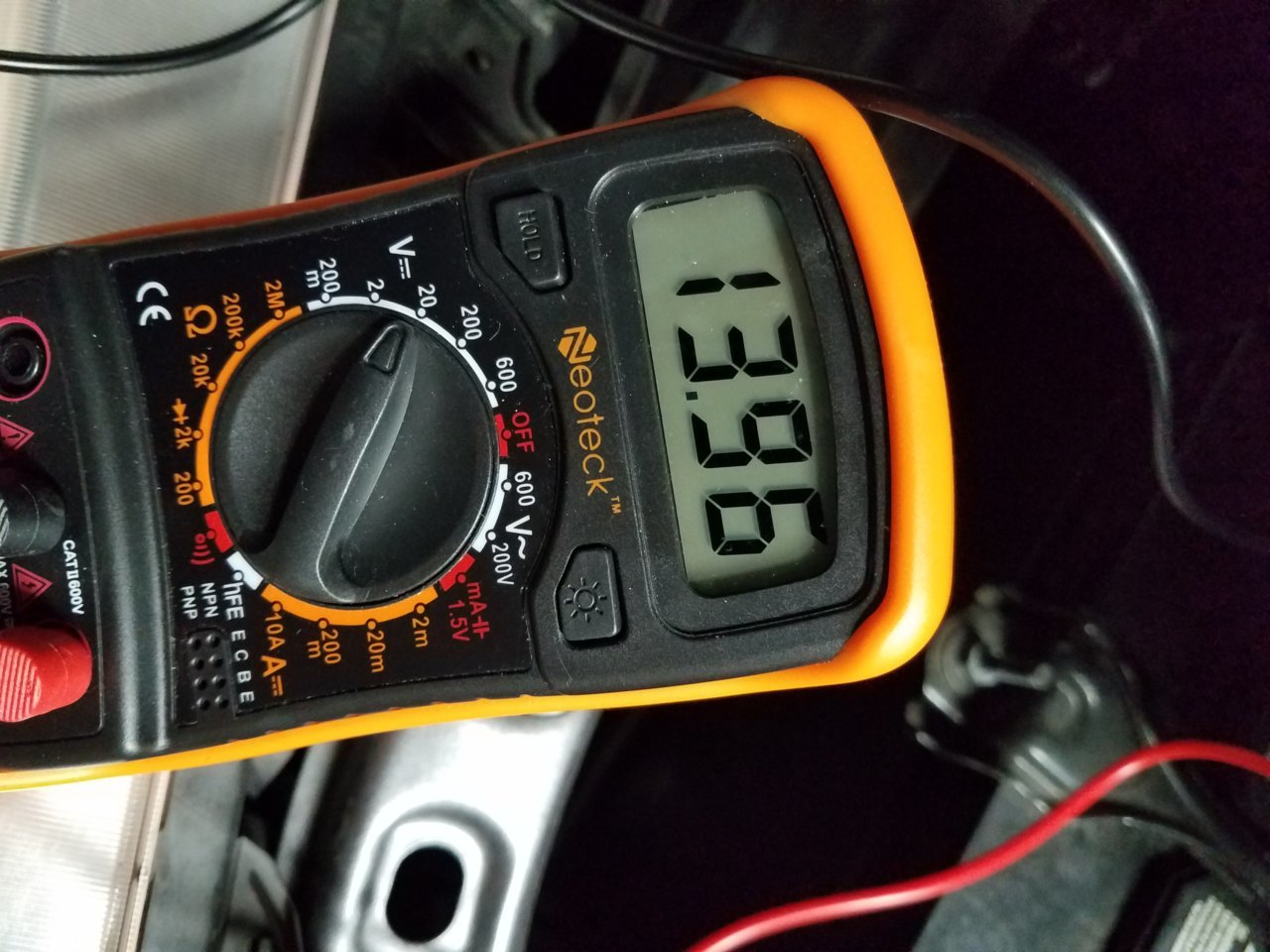

    20191204_174537.jpg My truck puts out about 14V.

    There’s always a wee bit of sway. But rare to go above 14v hot. (cold they will put more colts out)

    That looks about right, immediately after a cold start. Depends on ambient temp, engine temp, etc. but the voltage will drop as the truck warms up and the battery recharges whatever small amount of capacity was used to turn the engine over.
    Pulled directly from the Northstar site: "we have set charging the charging parameters of between 14.1 volts and 14.8 volts as an acceptable charging range"
