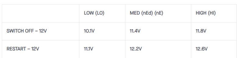

    If you want to avoid damage, have you set your Fridge's shutoff voltage? There is usually 3 settings. When the fridge reads a certain low voltage, the fridge shuts off instead of killing your starting batteries. Dometic does it, and I thought ARB did too.
    This obviously isn't solving your issue, just might set your mind at ease.
    Looks like ARB and Dometic match for these settings now. This is for the ARB Zero, which i think you said you had. Also looks like HIGH still shuts off pretty late... dang... i'm surprised it's that low of voltage, lol.
    Shellshock likes this.

    Ours does include the battery shutoff - I have ours set to the “medium” protection.
    Seems like I get conflicting info when trying to to figure out how low I should be letting voltage on these batteries get… Generally if it get to 12.2 or 12.1 I’ll go ahead & start it up.
    Medium protection from ARB is all the way down to 11.4 before it auto shutoffs.

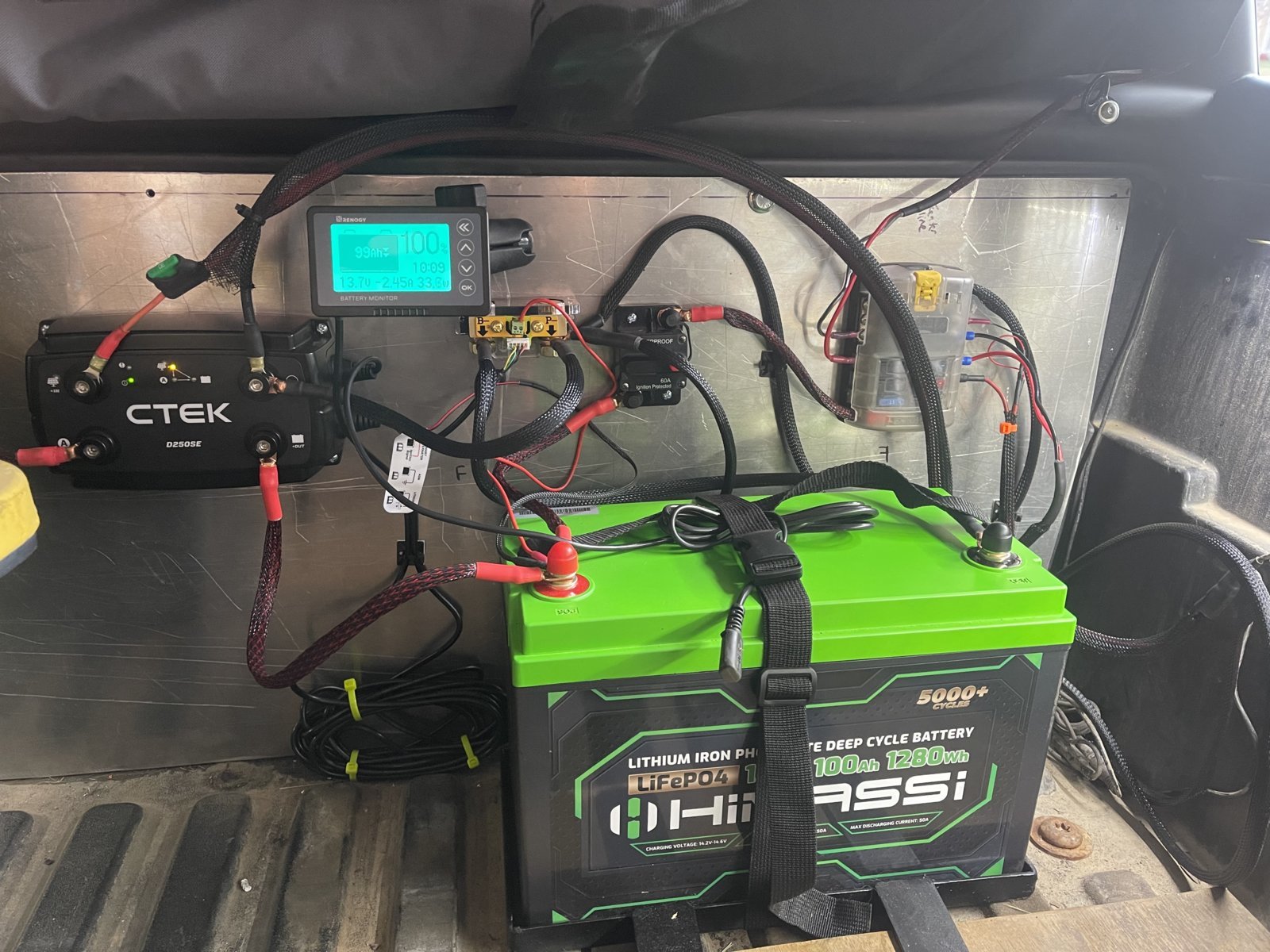

    Chiming in here about lithium. Ive had my setup for about 3 years, and no issues. I have dual inputs solar (200w) and alternator. I have an Iceco VL60ProS fridge thats newer, but about the same age as the dual battery setup.
    I wanted to say that you don't necessarily have to get the best lithium, if you are going that route. When i bought mine, there were more expensive options.
