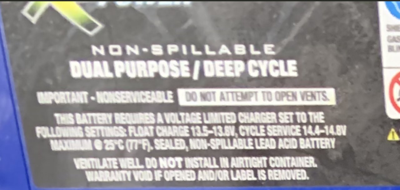

    I have an X2 Power 27F AGM battery from Batteries plus. It's a store branded Northstar. Great warranty on them. I have Baja Designs ditch and fog lights to go with a 60L fridge. I've gone 3 days without having to hookup solar or run the truck. Highly recommend. Never got close to getting down to 50% which is the lowest you ever want to get AGM batteries down to. Weather was 70-40 degrees for reference.
    On another note. If you go with an AGM battery then you have to do either of two things due to the increase voltage it needs that a stock truck cant do:
    1. Increase the battery charge voltage via a tuner since its controlled by the ECU. I got it done from a local guy when he did my OVTune
    2. Periodically charge the battery with a battery charger to top it off.

    What did you increase your battery charge voltage to? I am most likely going this route and will be getting a tune shortly so correct the horrendous shifting this truck does and sluggish acceleration

    458
    Danny
    Orange County, CA
    2017 TRD Off-Road 4x4
    He bumped it to 14.5 but every battery has a different range. It will clearly state it on the battery
  18. Mar 25, 2021 at 11:27 AM
    #58
    714reyesj
    714reyesj Well-Known Member
    Aug 10, 2017
    #226521
    458
    Danny
    Orange County, CA
    Example
    Prjct_Vodo[OP] likes this.

    I think it's 14.5 or something like that for Group 31F batteries. Most VF flashers know the correct setting, so when you go see them who's preparing your ECU tune, they'll take care of it.
