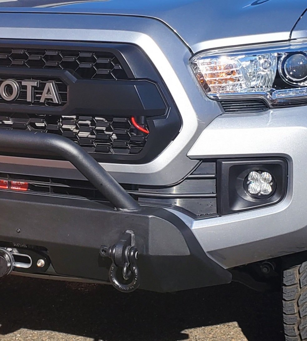

    I have a pigtail for each of mine for connect/disconnect convenience. I use the ring connectors on the battery, splice in an extension, then the quick connection as the pig tail. I leave the unit on the shelf. Unplug at the pigtail and off I go.

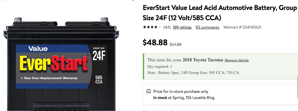

    Mine made it almost five years, never failed or left me stranded, but I replaced it because the cells were getting weak.
    I got the cheapest one from Walmart, not because I’m cheap, but because of the good probability that it will last as least as long as the oem with same maintenance I gave the original.
    Moreover, I put it on a trickle charge for a day and a half before putting on the vehicle.
    Choose wisely, good luck

    Good stuff, I just put a two pin off the battery and tucked the end in the grill. Also, had to get a couple extensions since 2.5' wasn't quite long enough.
