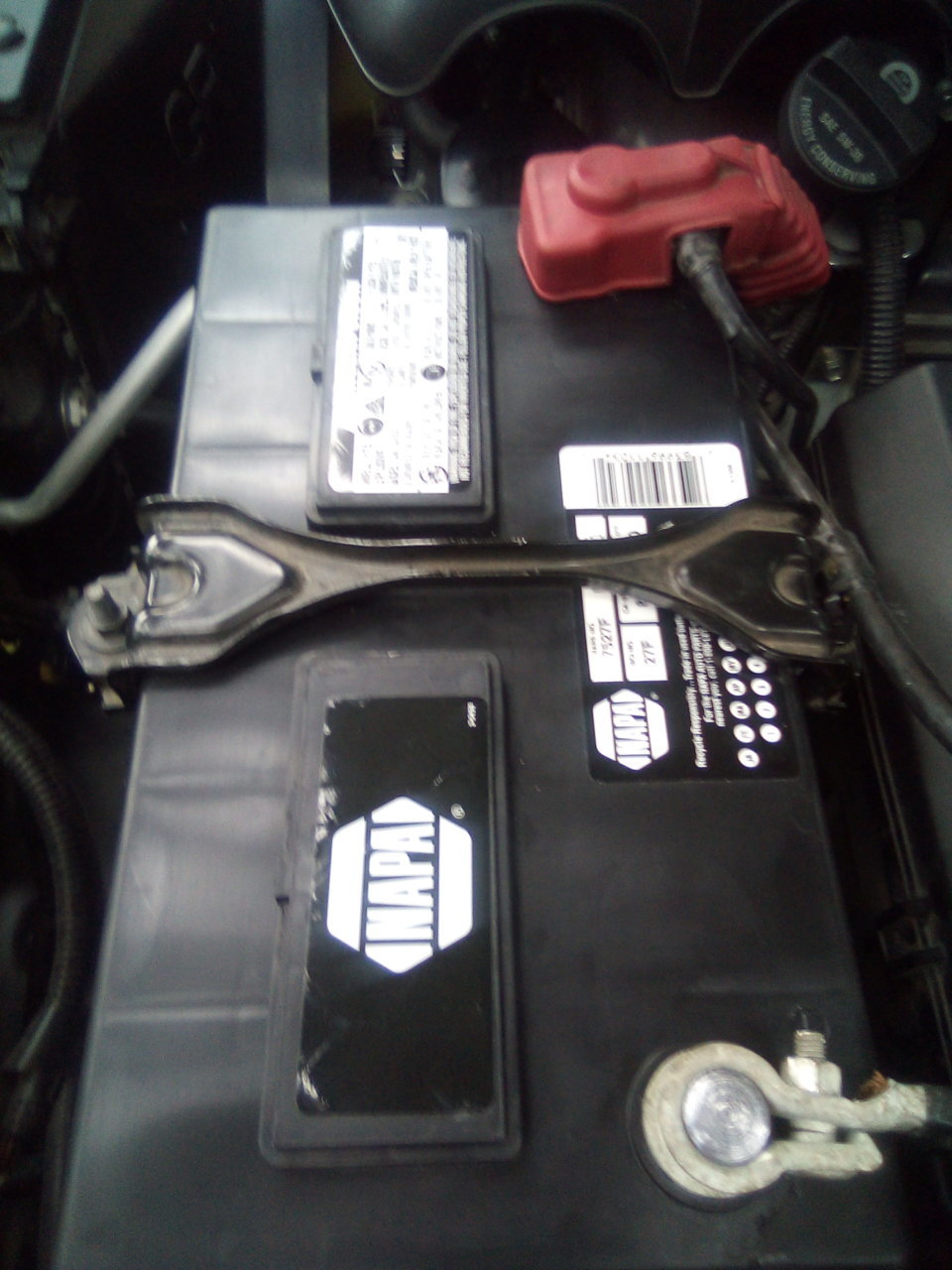

    An old thread, but another 27F to add to the list that fits the 4.0L engine w/o battery hold down replacement. Someone recently indicated the Advance Auto 27F as well as Auto Zones Duralast fit as well. There are others I'm sure:
    NAPA 27F Legend Lead Acid Battery.
    The battery this NAPA 27F replaced was the factory original 27F - 49 months old. Rated CCA = 710A. Midtronics MDX 225 measured 507 CCA. Winters coming - not going to chance squeezing another yr. out of the original.

    The claim is definitely true. The Duracell 27f I bought from BatteriesPlus was about 1/2-1” too tall for the factory hook bolts. They weren’t long enough to compensate and thus had to make my own hold down and get new hook bolts.

    just removed a factory Toyota 27F from 2013 trucky, and replaced with NAPA Legend 710 27F
    the NAPA was just a hair too tall to be easy to tie down
    and I had to press hard on the tiedown metal strap to make it
    connect. once I got the 10mm bolt onto it I had to press with my hand to keep spinning
    the bolt. I checked the 'fulcrum end' where the fixed j-hook was and did not see any stress
    of the battery casing (I was fearing bending or cracking the casing) but all good so far...it is cinched
    down and I cannot wiggle battery and no cracks or visible bending or visible overstress of the new battery case on the j-hook side
    I reckon Toyota idea of '27F' dimensions are pretty much lowballed and all our
    replacements are fine, it is Toyota that is messing up.
    basterds
    anyway, napa legend 27f fits 2013, but it's tight on the j-hook side, factory strap OK just tighter

    My Napa fit the same way, I too was afraid of it cracking. Nothing yet, had it for about 4 months.
