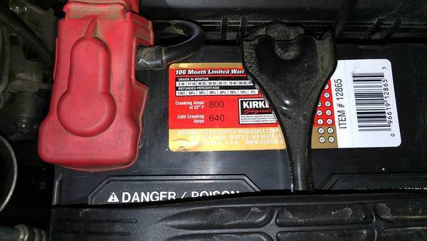

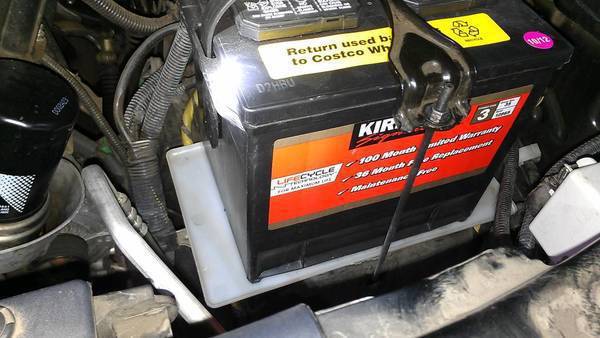

    Starts up fine as if it were brand new factory 27F. No sluggish feel or anything. the cca is 640 and ca is 800. Not sure what the factory battery was for the 27F.
    Here are some pics i just took. as you can see it is definitely smaller than the stock 27F. A bit taller too. only by a 1/4inch but that makes it so damn hard to put the battery holder on top back on because for some reason they made it only where 1 side is adjustable.

    If it fits securely either will be fine.
    In general...
    The 27F has more reserve capacity but less CCA
    The 24F has more CCA but less reserve capacity.
    Either way as long as you're not leaving your headlights on for extended periods of time without the engine running, you'll be fine.
