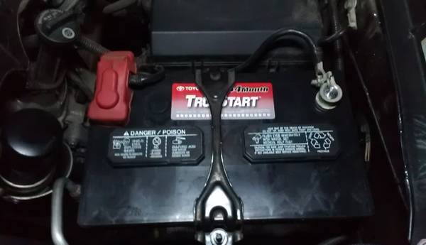

    Yeah 24F battery is secured with the tie down directly centered. Definitely won't be moving anywhere, its tied down good and tight. Who you are getting a hell of a lot of usage out of your stock battery. i would switch it out now if i were you. My battery was fine one day and just out of the blue no start, just like that it happened. so start shopping now for one while you got time and not like me and rush to the point there i had to get what i could at the moment.

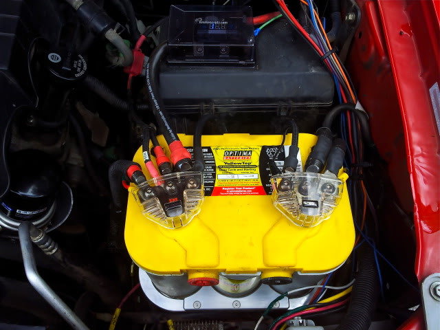

    Battery tray copycat... :cool:
