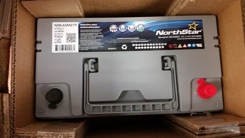

    The Nyloc self locking nuts are a nice touch.
