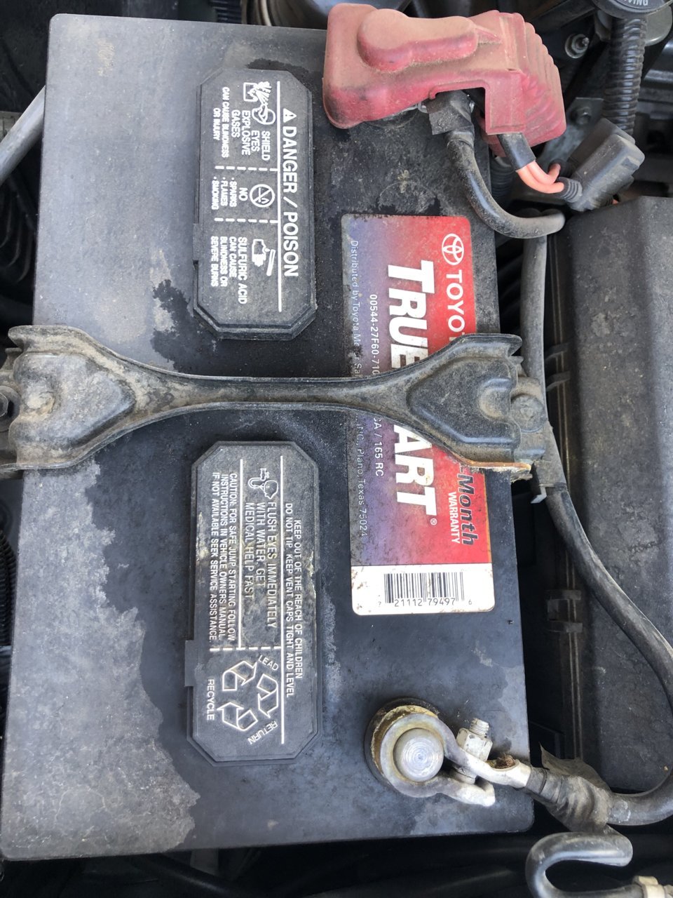

    I bought a Tru-start battery from the dealer in November of 21. Looks like a leak forming. Is up for a replacement?

    Unfortunately that's very common for flooded lead acid batteries and most battery manufacturers won't warranty them for that.
    Mix some baking soda in a cup of water and pour it over to neutralize the acid then rinse it off with water.

    The way yours looks, I wouldn’t be concerned. Take the bracket and terminals off, use a battery brush on the terminals and posts, wipe the battery top off with a rag slightly damp with soapy water, try not to get soapy water under the caps. Try to clean the bracket. The right (rear) side has some white acid forming. Maybe stick a felt pad between the battery and bracket there. The felt pads are like 99c on Amazon, about 3 bucks at Wally World.
    Keeping battery corrosion at bay is a thorn in my foot. I’ve tried many many different products.
    For when the acid is stuck to the terminals, nothing I’ve found works better than plain coke, the drink. Pour it in a container, dunk, leave it. Sometimes you have to do it a second time if the fastener is stuck to the terminal. Tap it loose, dunk again.
    The Noco products are all very good. Spray on cleaner, spray and brush on protector, felt pads.
    CRC products and baking soda are ok but not as good as Noco.
    I maintain a 50 vehicle fleet by myself. After putting felt pads on all the batteries, keeping them clean is so much easier.

    Clean it up to see where the leak is. It is likely from the posts. Them red/green felt pads can help with that. If leaking from the caps, you may need new ones.

    The dealership out of courtesy could have taken the extra minute to wipe it off at least. If they didn’t, you should. When the 2 terminals are connected by moisture like that, you could get voltage passing through the moisture.
    Batteries can seep a little through the post or leak through the caps. Some caps are designed better than others. This is why I’d recommend the felt pads.
    When I replaced my battery a few years ago, I did the swap at the place I bought it to save time not having to go back to return the core. I just moved the old felt pads from the old battery to the new one. A few months later what little acid that was stuck to the positive terminal grew into a semi neutralized booger. So I gave it a good cleaning, put new felt pads on. Then a few weeks later, wiped off the excess oil that tends to seep off new felt pads.
    Adding water to a 12v battery is most likely not necessary. It might need it once in its life. If you pop the caps off and the plates inside are fully submerged I wouldn’t add water even if you could fit some. It’s easy to overfill, then the leaking problem will be worse.

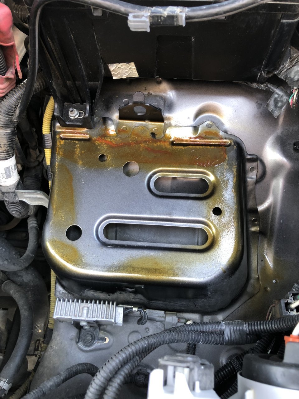

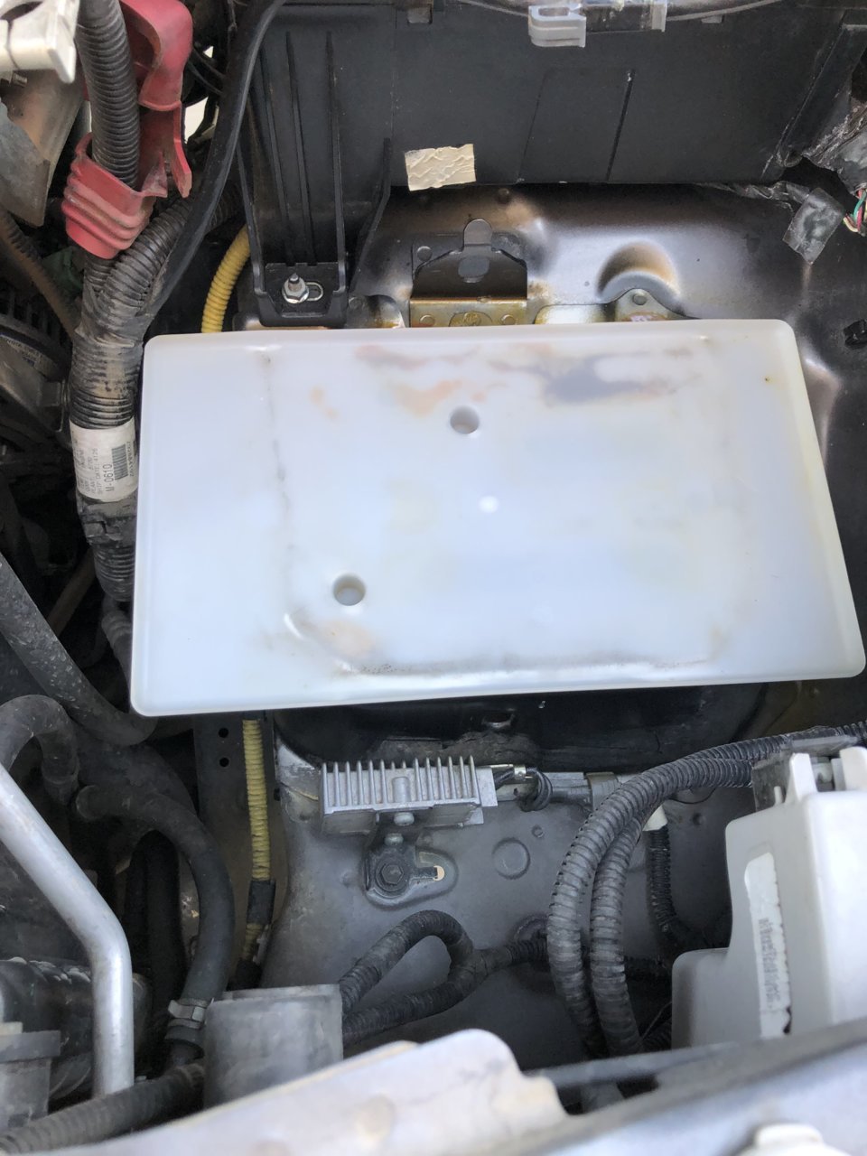

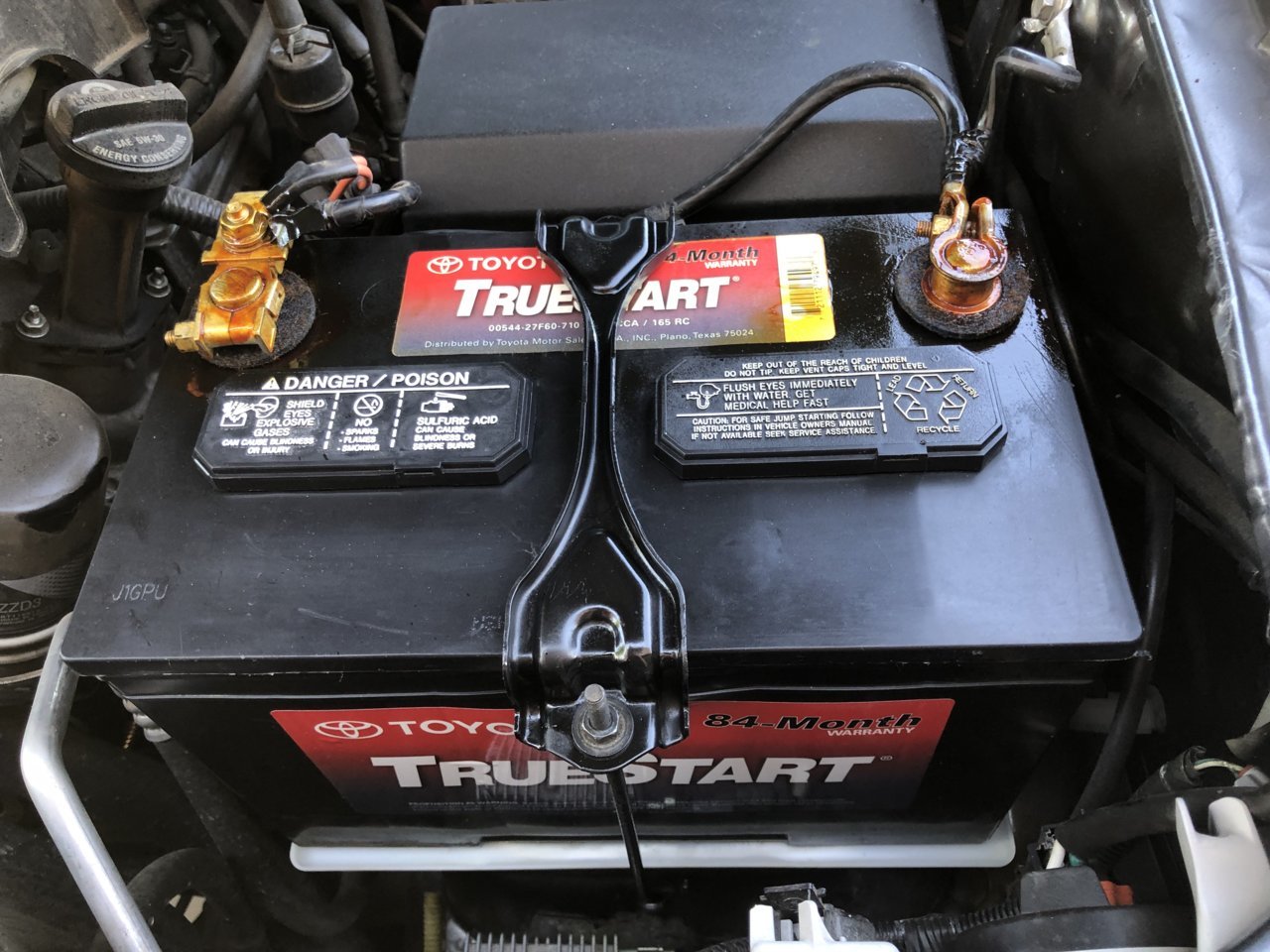

    I pulled the battery out this morning. Cleaned with baking soda/water. Cleaned the posts and cable ends. Battery was leaking from the caps/vents. Brushed and repainted the battery hold down. Reinstalled with Noco felt washers and oil spray. Have to keep an eye out for more cleanup.

    Those vent caps are removable and, if needed, you can fill up any low cells with distilled water. You only need to fill up to where the water begins to touch the plastic. (you'll see it when you shine a flashlight in each cell)
