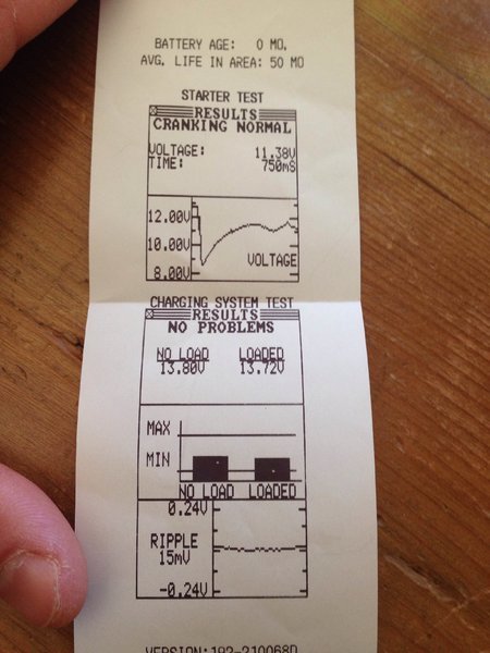

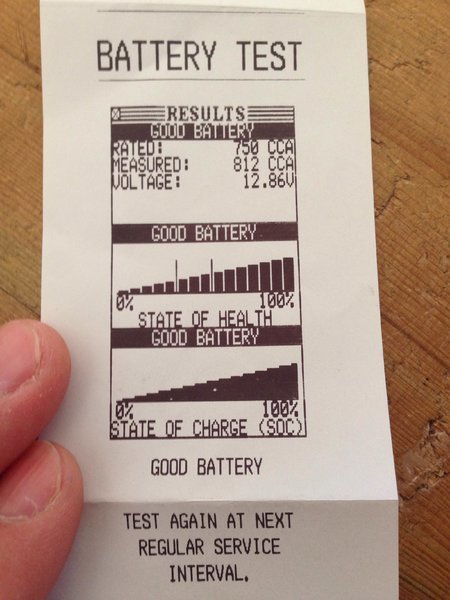

    So, they did run a charging test with the No Load and Loaded and everything came out fine...I believe these are the results?

    Maybe your battery light is stuck?
