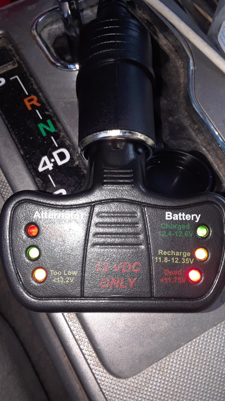

    The old/2nd alternator is charging around 13.4 volts.
    Ran by Harbor Freight and bought their cigarette lighter tester thingy.
    The yellow and green illuminate as they should, but when the battery light comes on the green light starts to flicker.
    Atleast I get to keep an eye on the charging status of the battery.
    I ran a single 12 gauge CCA wire from the body ground next the battery, to a frame ground and that hasn't help any.
    I guess my only other option is to go to the local Toyota dealership and get a new and hopefully not a rebuilt alternator.
    At Advance Auto, when looking up the alternators, the question is asked does it have the tow package. Which I just assume it does, since it has the tow hitch and the 4 point socket.

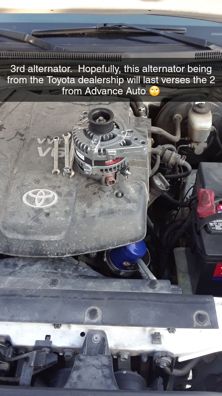

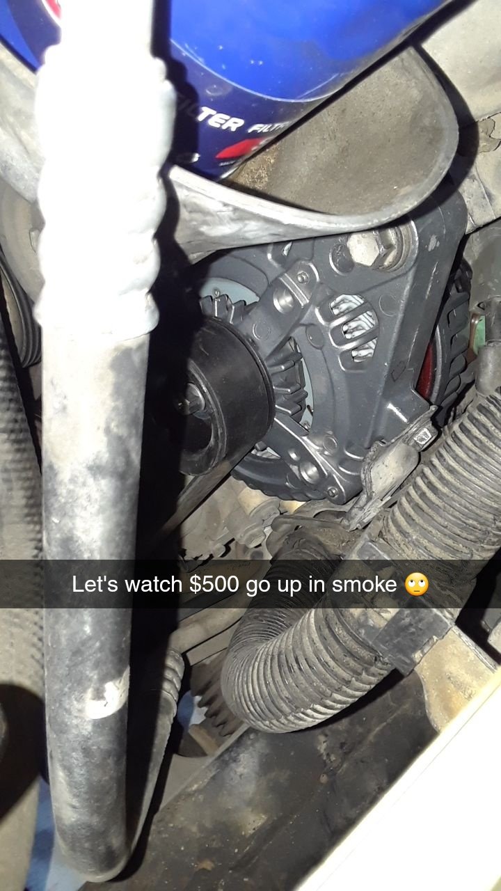

    Well, ran by the local Toyota dealership. The remanufactured Toyota alternator cost $371 and since I didn't have the original Toyota alternator I can't get the $70 core charge credit.
    Before I completed my question, the guy at the parts desk asked something like "was this due to my battery light being illuminated?" and I said "yea".
    He assured me it wasn't a wiring issue, that it is the alternator.
  9. Sep 30, 2019 at 3:04 PM
    #29
    wannabemtnbiker
    wannabemtnbiker Well-Known Member
    Nov 10, 2015
    #169189
    62
    Derrick
    Georgetown Tx
    2008 White Tacoma Prerunner
    I'm "knocking on wood" and hopefully not jinxing myself for posting this.....
    But it's been over a week now since I installed the alternator from my local Toyota dealership and the battery light has not illuminated any.
    I was even sceptical on my snapchat posts.
    I now can start and finish an alternator replacement including the skid plate and battery removal/replacement in just under an hour Snapchat-1406306137.jpg Snapchat-1447478968.jpg
