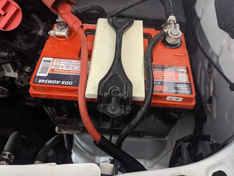

    Anybody have the part number for the larger battery tray? How close does the battery get to the oil fill neck?

    Did you ever get one?
