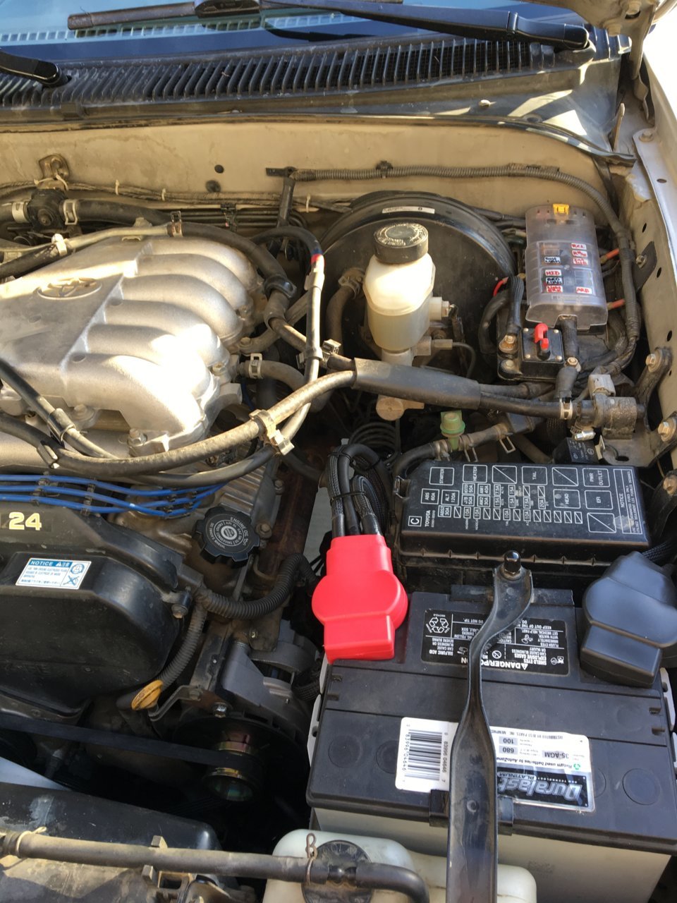

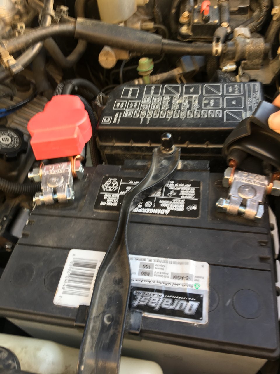

    Has anyone ever shallow drilled and tapped into the center of their top posts to add additional connection points?

    :crazy: Please don’t. Just buy the cable adapter listed above.

    All my vehicles I add one wire from battery to a buss bar under the hood to run accessories to. Keep multiple connection off the battery.

    I’m going with the military-style terminals.

    +1 for mil spec summit sells a kit with the covers and terminals and heat shrink

    Drilling and taping into lead I would wonder if the threads would strip before things were tight enough for a good connection.
    So many other better ways
