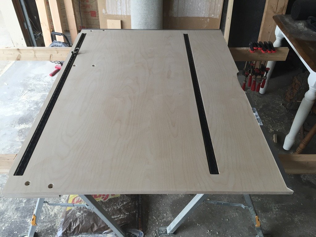

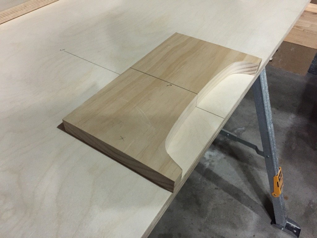

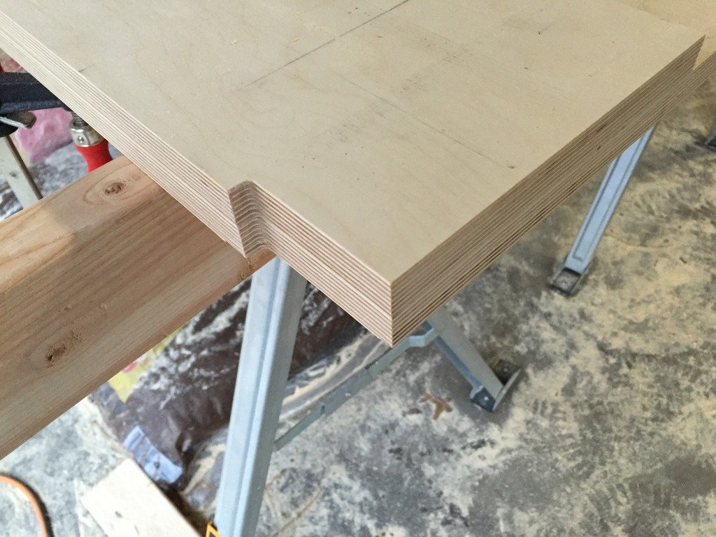

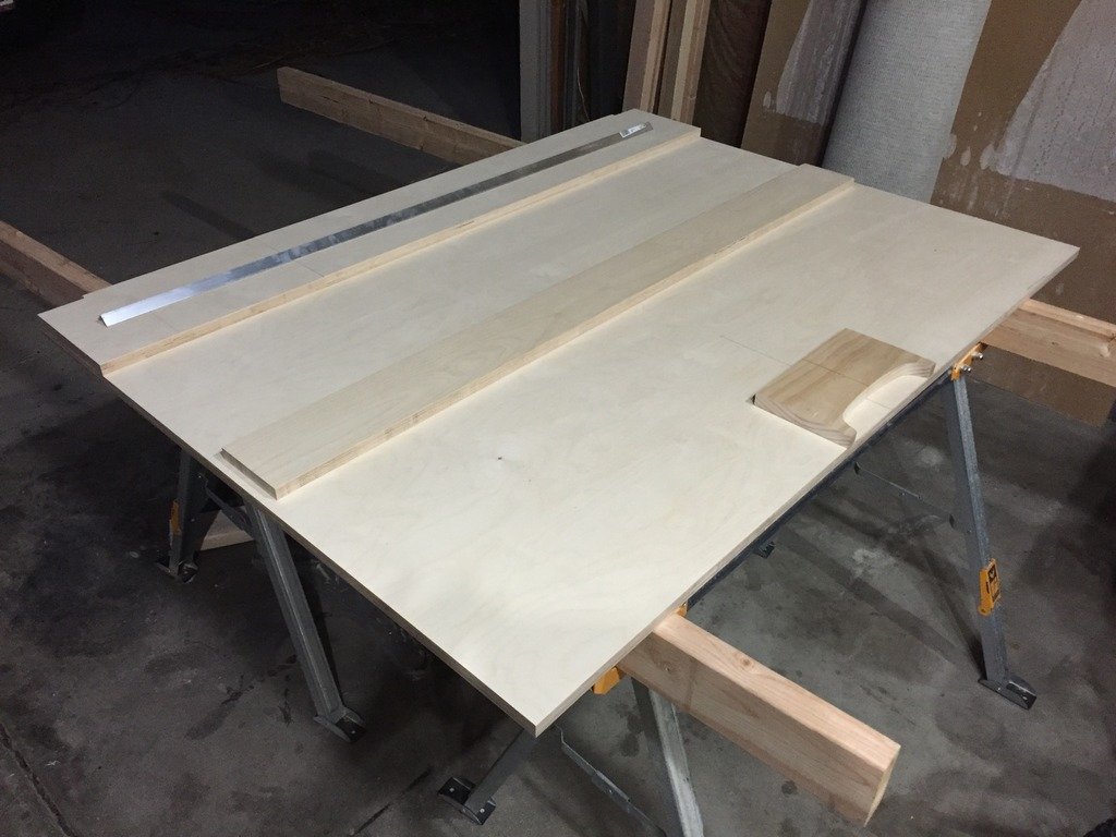

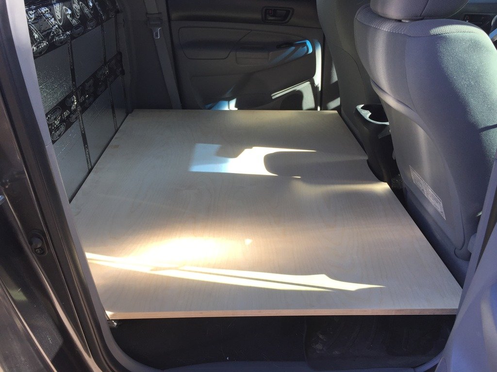

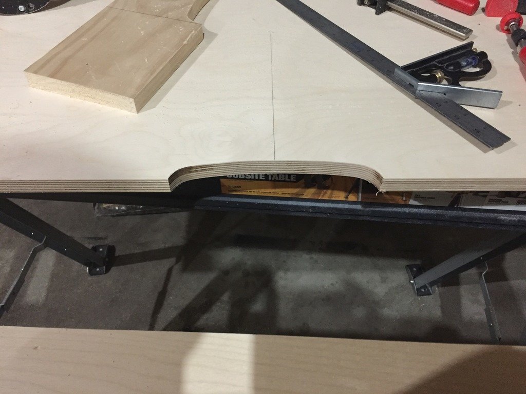

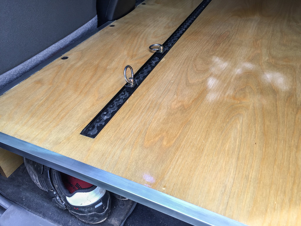

    Started the backseat platform last Thursday. I'm using 3/4" Baltic Birch plywood for all of it and must say that it is very high quality, solid feeling material. Certainly of a much higher quality than what can be found at Home Depot or Lowes. I can now see why it is the material of choice for all of the fancy expedition drawers.
    I don't profess to be a woodworker so some of my techniques and methods may be a bit unconventional. All of the work has and will be done with a circular saw, router, jig saw, random orbit sander, and a hand drill. The design will be similar to what was done in the Boden Build with the exception of a few details and dimensions. I will be using a full width two layer section along the back and will be taking the platform all the way to the back of the seats. Motivation behind doing so is to provide as much space as possible for gear and our two dogs.
    Step 1: Rip the 60" x 60" sheet of plywood down to 54.5" long by 39.75" wide for the main body. Rip an additional 54.5" by 8" wide strip for second layer at the rear wall. Rip a third piece 4" wide by 53" long for the second layer under the other piece of L-track. Get something that looks like this.
    Step 2: Route contour in the double layer to account for rear plastics still in place. Mess up when neighbor surprises you mid-router pass. Platform width now 53.75".
    Step 3: Spend an hour fabricating a wood template using the belt sander and hand sanding to get the contour of the rear portion of the center console perfected. Spend two hours explaining to the wife that you are just making a template and that this will be discarded shortly thereafter. Trace cut line onto cardboard and flip template over to see that it is not a mirror image. Back to hand sanding.
    Step 4: Measure once, measure twice, measure thrice and make a cardboard template to dial in proper positioning. Use newly acquired top bearing trim bit to cut contour into platform. Go inside to relax and get to thinking if all of the measurements were right. Run out to garage to verify that things are within 1/64 of symmetrical across the center line.
    Step 5: Glue on back reinforcement section and use literally all clamps available to secure.
    That's as far as I have gone at the present. I will be using the same sharpened bolt method as Mike did to locate the mounting points except I'm using the 6 M8 locations where the seats brackets bolted to the chassis. I would have to imagine that 9 total (6 at the back, 3 at the front of the seats) grade 8 M8 bolts should be able to withstand the forces in the event of collision.
    Next installment of the platform build to come at the end of the weekend. I'm hoping to have it completed by then so I can start the stain/poly process. I will not be carpeting/rhino lining afterwards and will instead choose to revel in the glory of the wood finish.
    Cubbies will come at some point to access the storage area under the seats and perhaps I will at some point do the same for the foot wells. For right now I will be leaving the sides of the platform off so you can tuck stuff underneath.

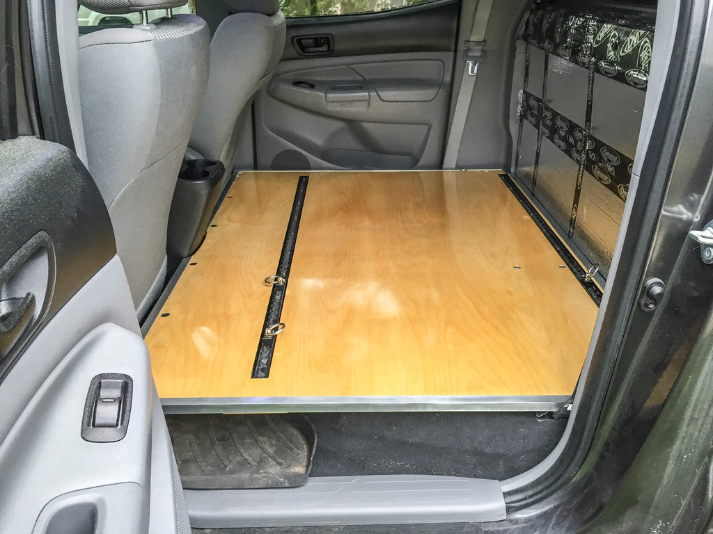

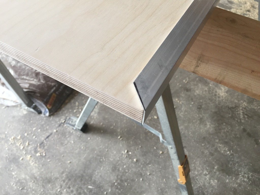

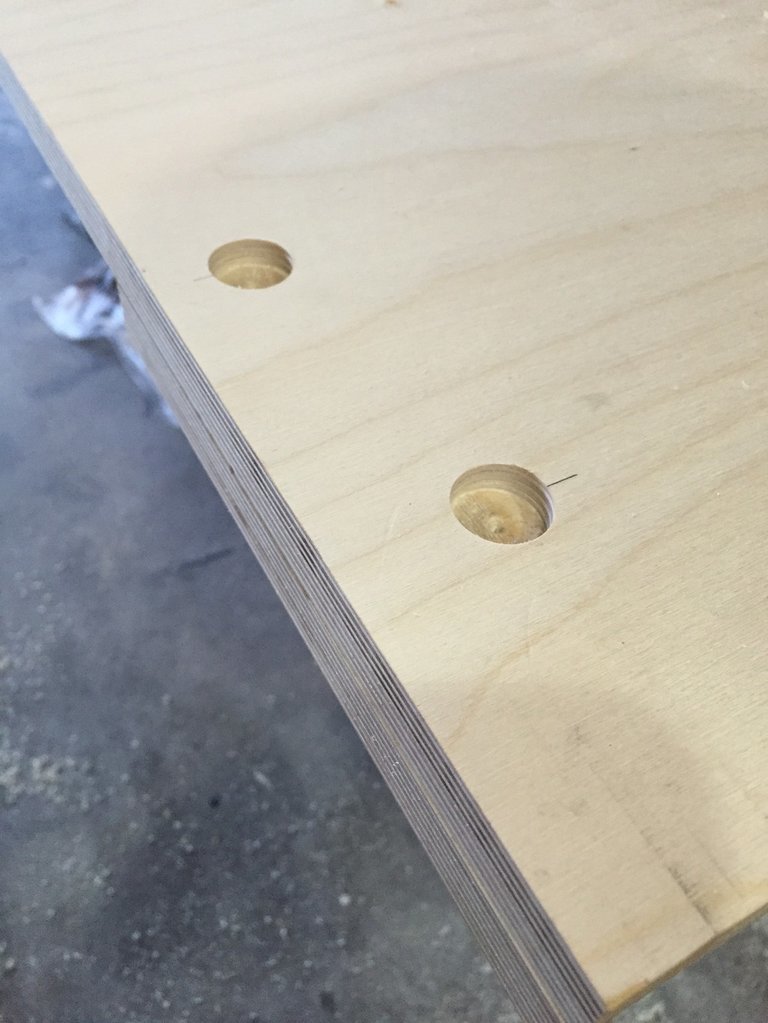

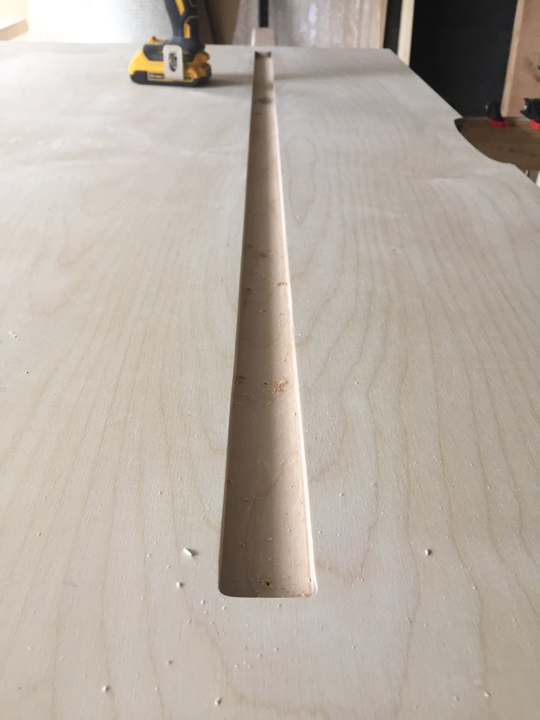

    Spent quite a bit of time at the end of last week and over the weekend putting a bit more sweat equity into the platform and have it in a good place at the moment.

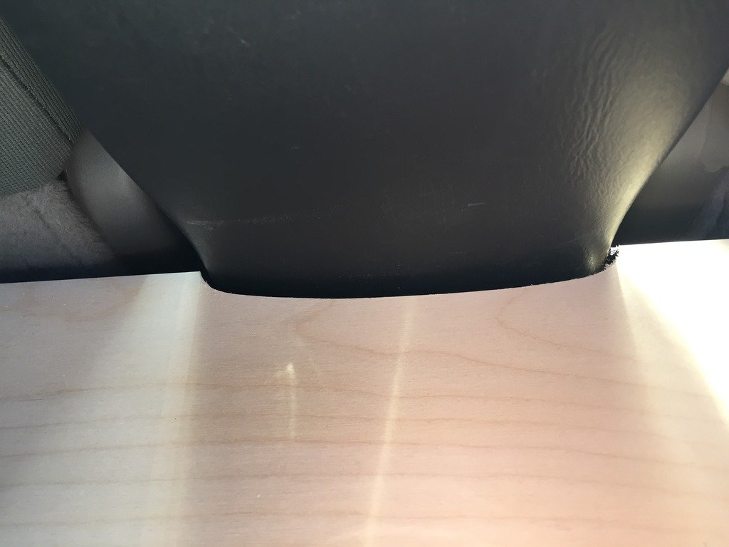

    After routing the relief for the center console the platform was finally in a position to chuck it in the truck for a test fitting. It is a bit of a bear to get in there but I managed to manhandle it myself and get it set in there. It's a tight fit, but it was designed to be that way. It was quite a relief to drop it in and see that everything fit quite snugly and conformed to the contours.
    I'll have to see if given the flex of the truck this is too little clearance. Things should be bolted down snug enough to minimize movement, but you never know.
    And then came the nerve-wracking stuff; all of the surface operations that could potentially sink the project. First up was the rear mounting points. Without knowing the locations of those I couldn't locate the L-track, so they were highest on the list. I did the Boden method of cutting the heads off of some M8 bolts and screwing them into my mount points. I tried this a few ways, the first being the platform good side up but this was non-ideal as my intent was to counterbore the bolt holes and forstner bits, at least in a hand drill, don't like having a hole already there. So I flipped it over and put the good side down with the sharpened bolts at a height to simulate the piece of re-inforcement ply. This worked well with the only problem being I had a mirror image. After transferring the dimensions across the center line and checking three times I went at it with the 3/4" forstner and drilled my bore, then took the hole all the way through.
    A post-drill test fit revealed that it was a great success! All bolts dropped in and bolted right up. Always a pleasant exercise when things work out like that.
    And then came perhaps the most challenging aspect of the whole project, the L-track slots. While it would have been easier to cut a channel all the way across the platform I preferred to sink a pocket into it to completely capture the L-track. Wholly unnecessary and probably added a good 5 hours to the process given the tools I am working with but I managed to construct a wood jig to mimic the pocket profile. After carefully centering it and making sure it was square on all sides I went at it with a 1/2" bit with a bearing on top and followed my jig around cutting. It worked pretty okay except for the fact that the 3/4" thick wood wasn't tall enough to prevent taking a healthy depth of cut on the first pass. I took it slow and chugged through getting incrementally deeper over the next 2 passes.
    Success! I had to get into the corners with a 1/4" bit to reduce the radius a bit so the tracks would sit in there and they are about 1/16" below the surface with 1/16" clearance around all sides. I am quite pleased with how they turned out.
    That pretty much covers where I am up to at the moment. Next up on the list is:
    1. Get aluminum edging on there, like so
    2. Drill countersinks and through holes for aluminum edging
    3. Fabricate brackets to attach to the front side of the platform
    4. Drill dowel holes to make front supports knock down detachable.
    5. Drill counterbores and through holes to attach L-tracks.
    6. Stain
    7. Poly
    Guess I have a bit more work ahead...

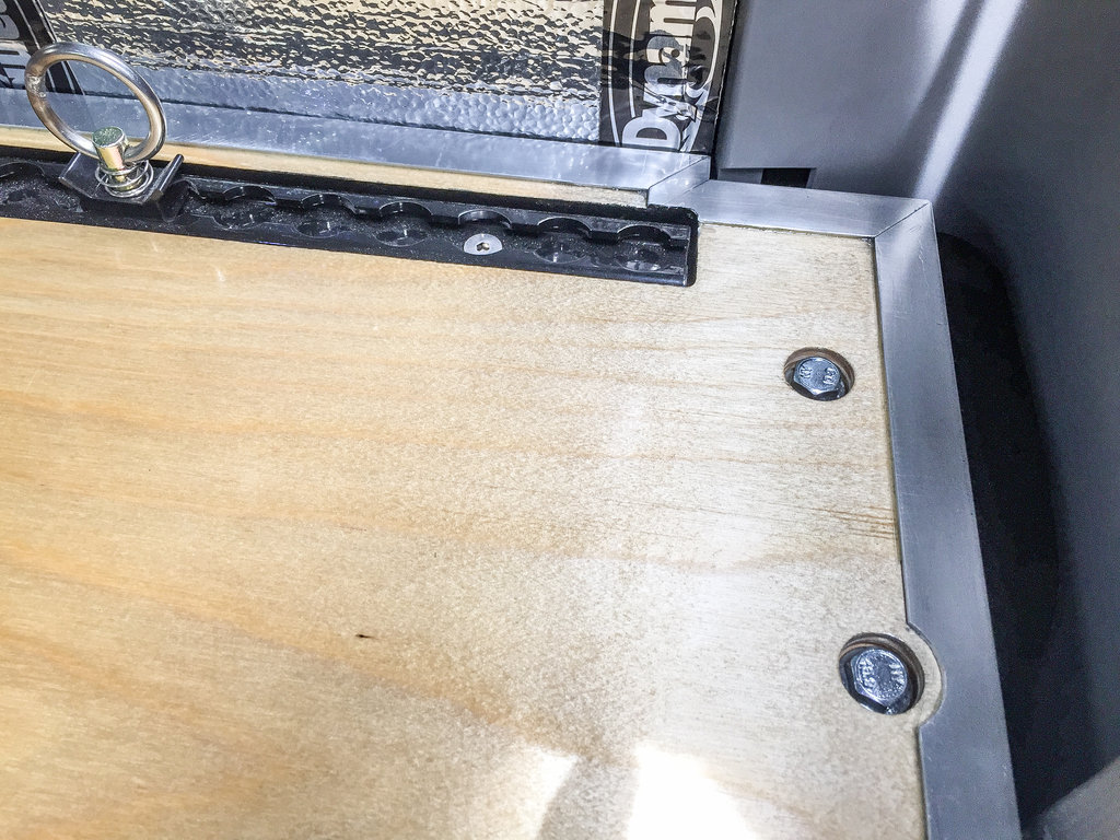

    The platform is done, installed, and we made great use of it this past weekend. I spent the last 2 weeks taking care of the last few details that included drilling the dowel connections for the front support pieces, gluing the aluminum edging on, finish sanding/buffing, painting the L-track recesses black, and getting 3 coats of polyurethane on everything. It all went off without a hitch and I managed to get things finished just in time. A few pictures of the finished product...
    L-track details with tie downs:
    Back corner details. The 5 miter cuts on the 4 different pieces were a real challenge to get everything to fit correctly and cleanly. I did a regimen of sanding with 400, 800, then wet sanding with 1000 grit, then 2000 grit, followed by the buffing wheel in my hand drill with some rouge compound. Turned out pretty nice I think.
    Of course now I need to do something for the back wall to match. Thinking 1/2" baltic birch with accommodations to strap items to the back wall, like say a fire extinguisher, perhaps a few tools with quick fists, we'll see.

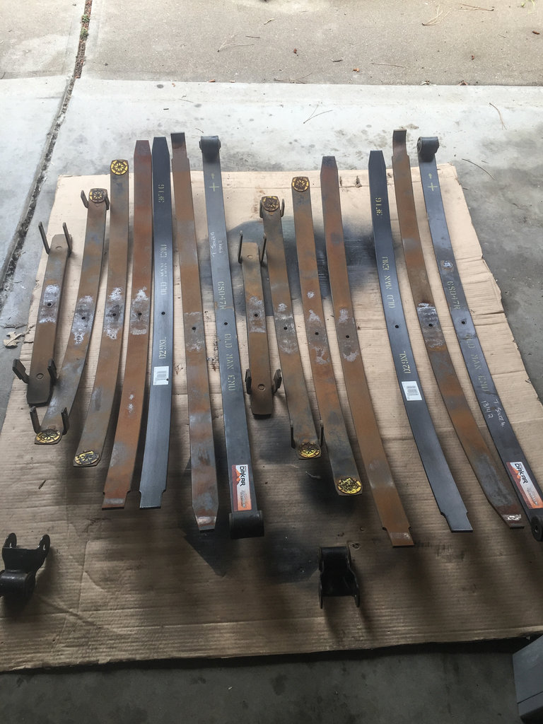

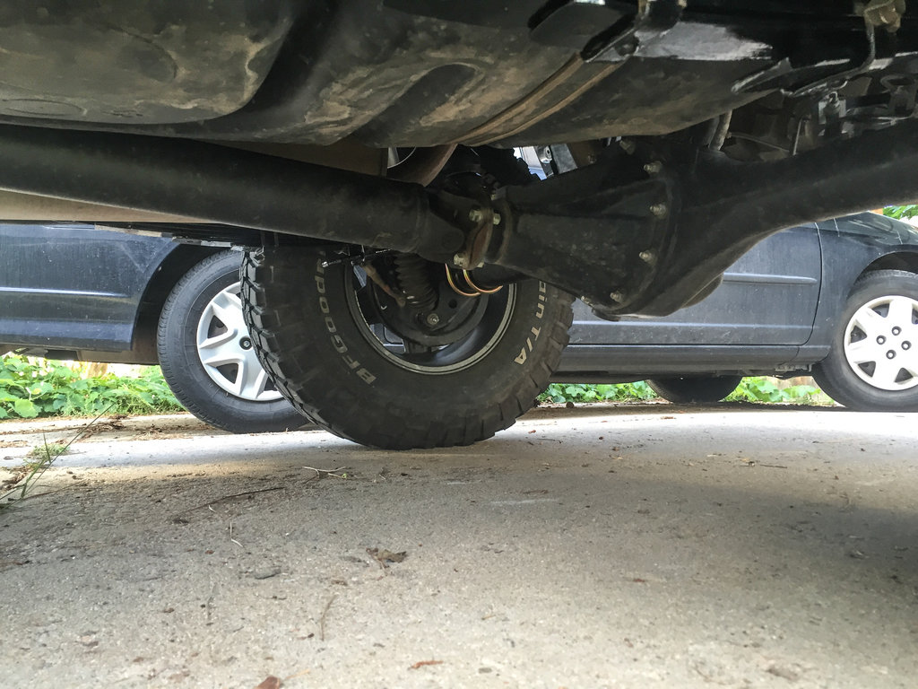

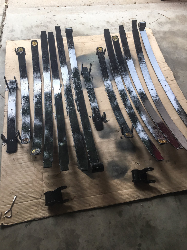

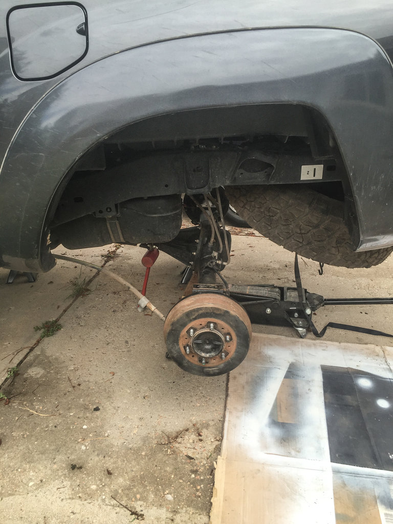

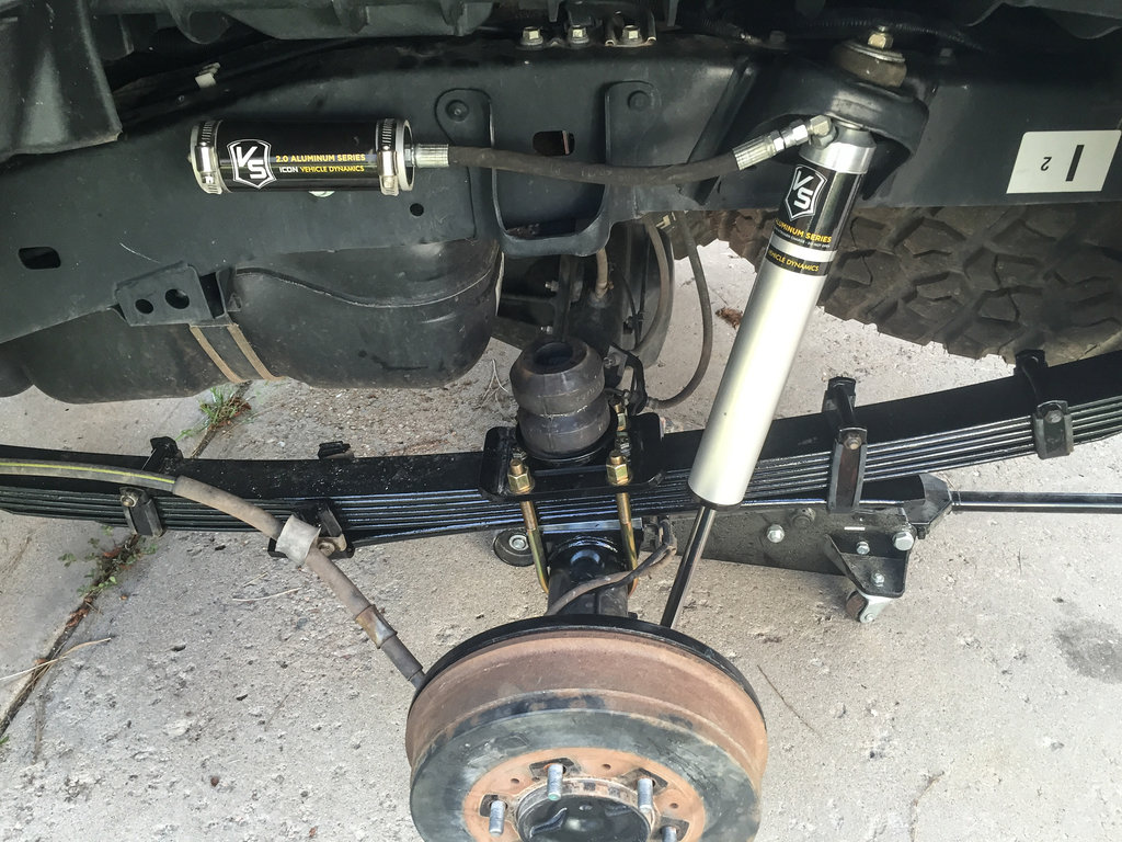

    After a year and a half the rear suspension on my truck needed a bit of refreshing. The Dakar leaf pack was rusty, had settled a bit with all the weight, and the leafs would shift and make a creak noise. So I decided to rip it apart, do the D29XL add a leaf kit, and install the pinion angle correction shim to bring things back in line a bit.
    So on Saturday I got up early and went to work ripping things apart. Everything came apart with no problem and within a few hours things were looking pretty empty back there.
    Once the leaf packs were out it wasn't too much effort until they were disassembled. Look kinda gross eh?
    I only wanted to do this job once so while I was at it I decided it was only appropriate to paint everything so I wouldn't be tackling this again in a few years. Along with rebuilding the pack I dumped the larger of the two overload leafs. A fresh coat of Chassis Saver and things looked quite a bit better!
    Given the higher humidity and temperatures the paint was drying very quickly, so I let things sit for the night then re-assembled the packs the next morning. It was a bit of a bear to get the centering pin through the whole thing by myself but I managed to get them both back together and wrestled into the truck. Things bolted back up easily but given that I needed new u-bolts after all that time I decided to do the u-bolt flip at the same time. I went with the Timbren Active Off Road kit, at $170 shipped I thought it was a pretty good deal for that setup. I did have to strip the paint off of the kit right out of the box cause the paint was chipping off, a coat of Chassis Saver fixed things right up though.
    I also scored a set of Icon 2.0 RR shocks off of the interwebz for a pretty penny so I jumped on it. Figure I can offset the cost by selling my current ones while scoring some shocks that will deliver better performance. If aesthetics are an indicator these things are sweet!
    Angle shims did exactly what they were supposed to. My pinion angle was off before though I didn't notice any sort of adverse effects; the angle shims can't hurt as they should help with seal and u-joint life.
