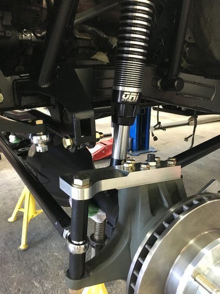

    SAS build starts here
    The Numbers!
    Wheelbase= 127"
    Frame height with 37" tires at 35psi =25.25"
    Skid plate = 22.25".
    Roof line= 78". 6'6".
    WMS front 67"
    WMS rear 65"
    Lower link length=
    Upper link length=
    Current parts list for the solid axle swap.
    Front Axle:
    Ruff Stuff custom 60/9 front with armor 67.5'' WMS
    Strange Nodular 9'' 3rd with ARB and 5.29's
    Solid spindles and hubs
    solid 6 hole keyed knuckles & inner c's.
    Artec ultimate steering arms and double sheer kit
    Yukon Hardcore locking hubs
    RCV axles
    Reid Racing bronze kingpin bushings.
    All pro 3 link bracket kit
    ballistic joint lowers and hiem uppers
    Rear Axle:
    Ruff Stuff "crate" 9'' rear housing with armor
    Solid drive flanges & full float kit
    disc brakes
    Engin/drivetrain
    Optima yellowtop with blue seas aux fuse block and circuit breaker
    URD short shifter
    LCE pro clutch and 38lb flywheel
    RAD triple stick kit
    Inchworm crawlbox and customized Trail Gear belly pan
    Suspenson
    ORI 14'' struts black, front 3 link.
    refurbished 4 leaf 63's with small AAL
    TG Creeper joints
    King 2.5 16'' smooth body remote resi with compression adjusters
    King 2.5 4'' bump stops in rear.
    Wheels/tires
    Current:
    Goodyear MTR Kevlar 37/12.50r17
    Stealth Custom Series "stealth 6" in matte dark Bronze machined to fit solid hubs
    Armor
    ALL PRO APEX plate bumper front
    B.A.M.F standard rock sliders
    Relentless DIY rear bumper with custom high clearance sides
    trail gear belly pan
    Recovery
    WARN m8000-s winch with wireless remote
    Viking hawse fairlead
    Viking safety thimble
    poison spyder tow strap
    Lights
    clear corner lenses from ebay
    PIAA driving lights
    42" LED bar with Relentless brackets
    daystar rocker switches
    3" flush mount lights in rear bumper
    The retrofit source retrofit lights, mini d2s
    Exterior
    diy satoshi with oem FJ40 emblem
    monstaliner DIY bedliner kit
    custom wrap
    Audio
    Kenwood DNX571HD DVD Navigation head unit.
    4 JL audio 5x7's
    Random
    Clutch pedal return spring mod
    Max out halon fire extinguisher
    ultragauge
    Custom pop out window locksredline hood shocks
    led under hood light kit
    Stuan tire deflators
    trasharoo
    SWAG offroad 50cal storage boxes
    Redline tuning hood strut kit
    Mastercraft Baja RS seats.

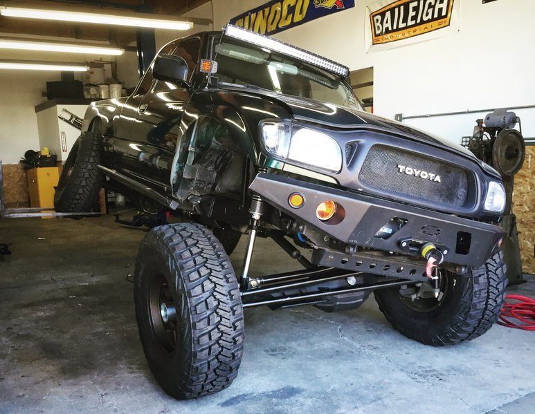

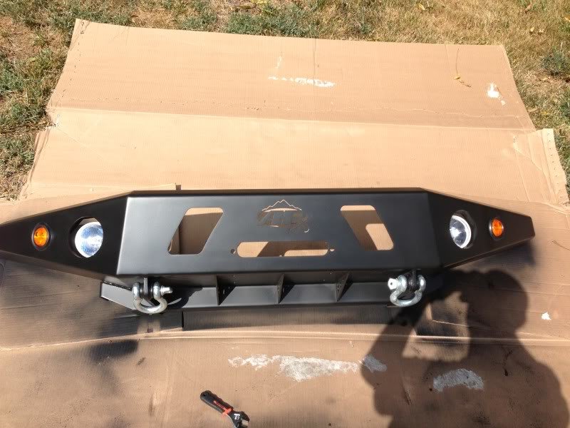

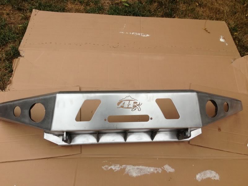

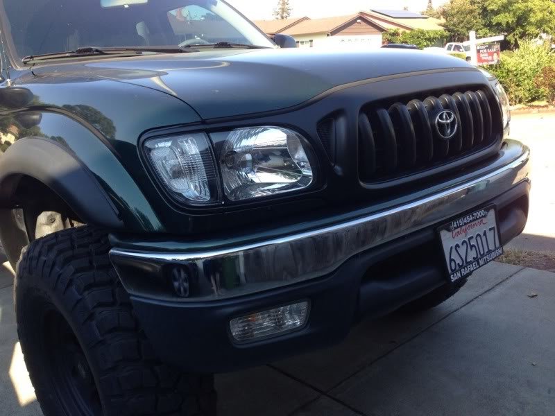

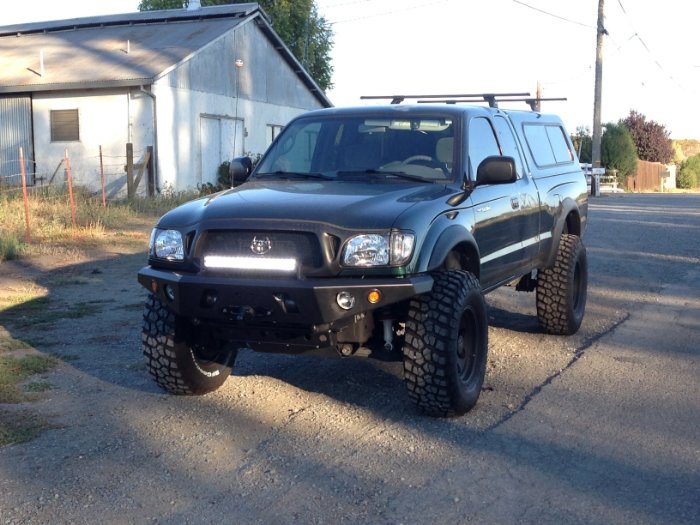

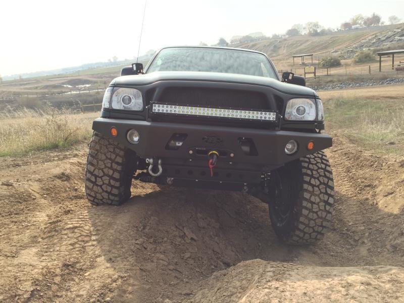

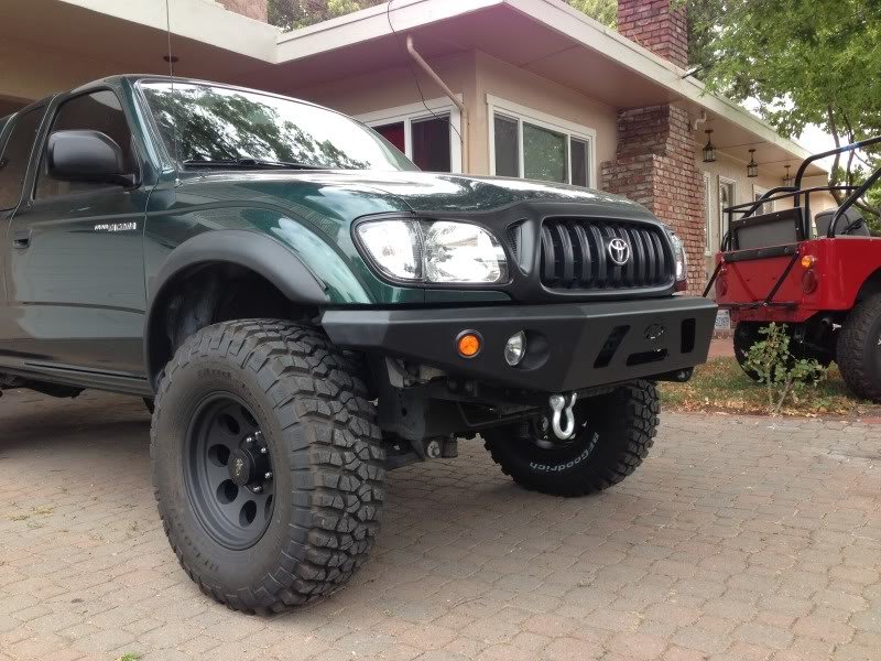

    So I finally got the apex plate bumper from all pro!! the bumper just bare is $649 , plus a few hundred for the PIAA lights, I decided to paint it myself instead of the $200 for powder coat from all pro. after shipping and everything it was just barely over $1000.
    Install was pretty easy, it says no modification at all on a 2001, yeah right, when I took the front end apart the support behind the bumper was smashed pretty flat on the passenger side, I was not aware of this damage so it was a bit of a surprise. anyways a few of the holes on the bumper did not align properly so I had to ream the wholes out so the bolts would line up. I guess it could be my truck but it could also be the bumper, it was only a few thousandths. Also had to chop off a small piece of frame horn thats in the instructions. PIAA were easy to install as well! No in progress pics sorry! it was late,
    after paint, i used a generic automotive trim paint.
    this thing is meaaaaan looking!!!
    next up is a winch, led light bar, and some wheel spacers.
