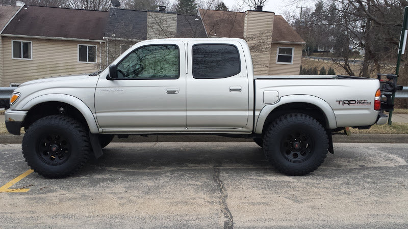

    Hey thanks for the advice! 4" backspacing with a 285/75 R16 was PERFECT! Not a single bit of rubbing!! Very happy about how it turned out. Now... to replace that rusting front bumper...

    nice truck :thumbsup:

    Looks great man glad I could help!
