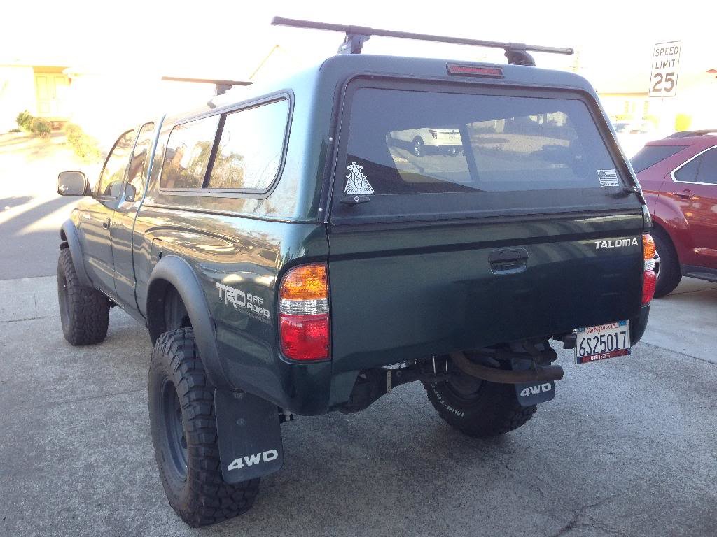

    I'm looking to go almost the same direction as you on my silver Tacoma. I may have missed this but will you be getting a rear bumper? If so, I'm curious which one you go with. I just finished building my rear. It is very similar to BoxRockets' phase one rear. It may get even closer in similarity in the future.

    That looks great, it looks super beefy. I actually have a relentless DIY rear bumper on the way I plan to modify it slightly and add a swing out. I have some cool ideas for the back that I have not seem anywhere else

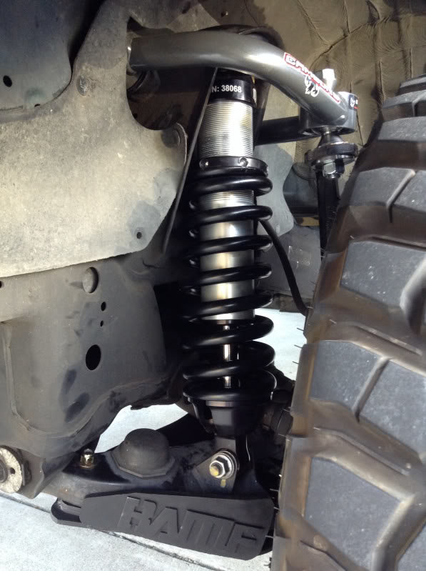

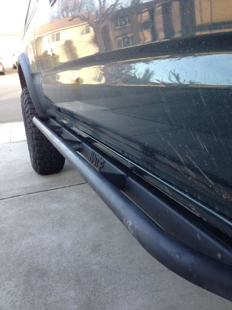

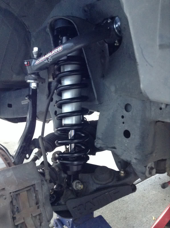

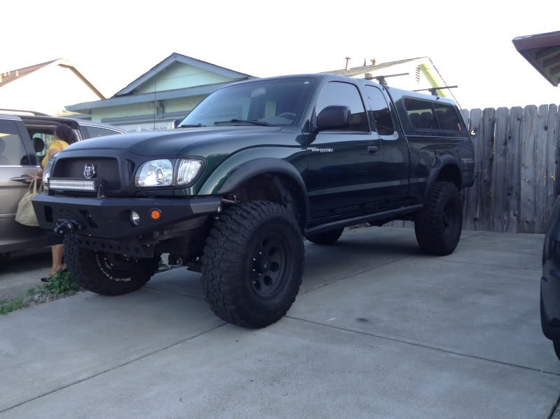

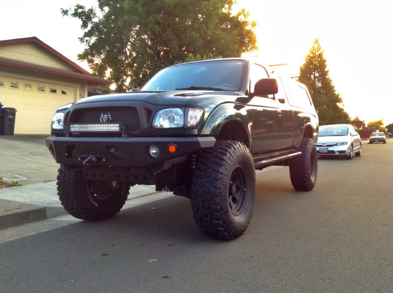

    Its been a while Since I have updated so Ill do a bulk update with the most recent mods.
    BAMF slider
    Suspension!!!!
    I went with a culmination of all the popular parts that I thought would work well together as a whole.
    Front:
    Icon extended travel coilovers
    Camburg 1" uniball upper control arms
    and some BAMF lca skids while I was there

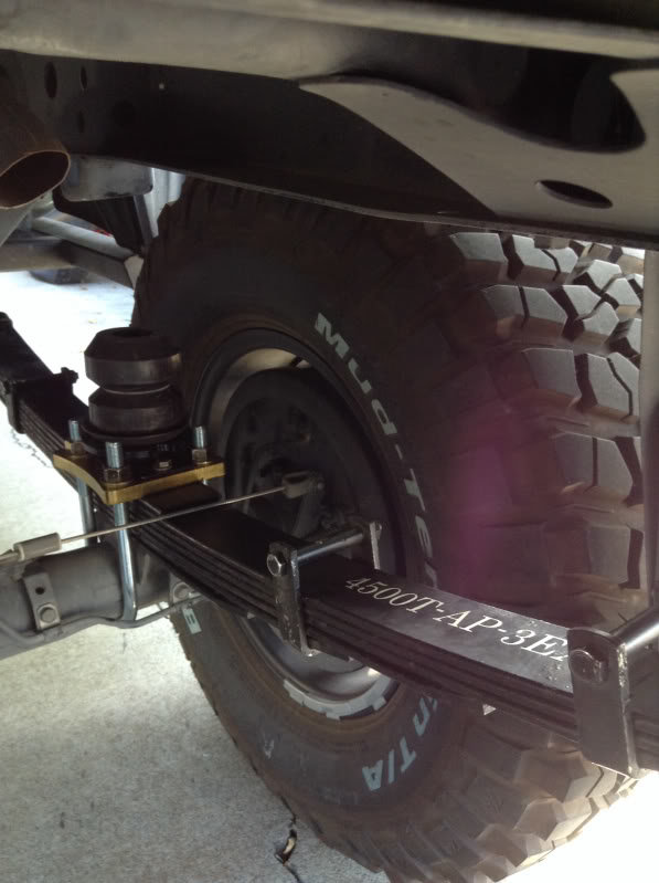

    Rear:
    All Pro Expo leaf pack.
    All Pro ubolt flip
    timbren bump stops
    All pro extended brake line.
    Fox 2.0 series resi shocks (still in process of building bed cage)

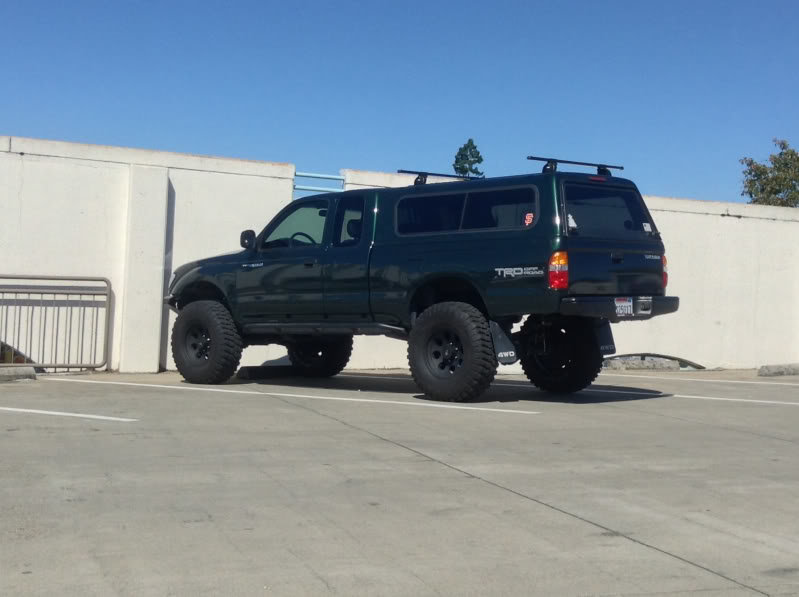

    heres a picture of the lift with 285's
    next up I wanted to step up a tire size, I sold my 285's to a local member and got a set of 315/75 basically a 35/12.50 (almost)

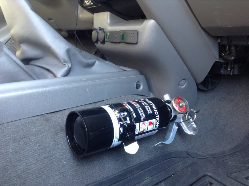

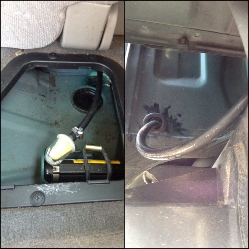

    threw a Maxout halon extinguisher inside for safety. I got it from poly performance
    rear diff breather

    Are they doing a little better finally?? Im a little more into the 49ers lol.
    Dayum bro suspension is looking top notch. Cant wait to see the bed cage your makin. Was curious what the model # on those timbrens are because my timbrens mount to the frame not the leafs.

    Thanks man can't wait to really test out the suspension, I'm sure they are the same ones, I bought them through all pro so whichever ones they sell that's what they are. All I did was drill and tap some holes on the ubolt flip top plate to bolt the bumps to.

    ah thanks for the info. I think after looking at the AP kit i can fab something up w/ the timbrens i have to mount on the u bolt flip.
