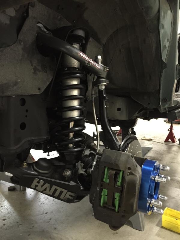

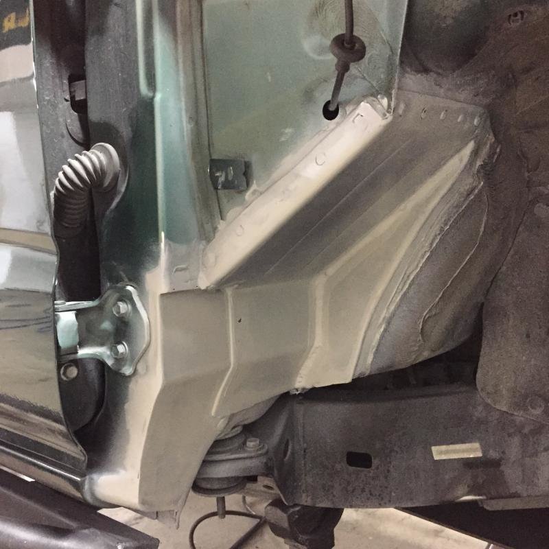

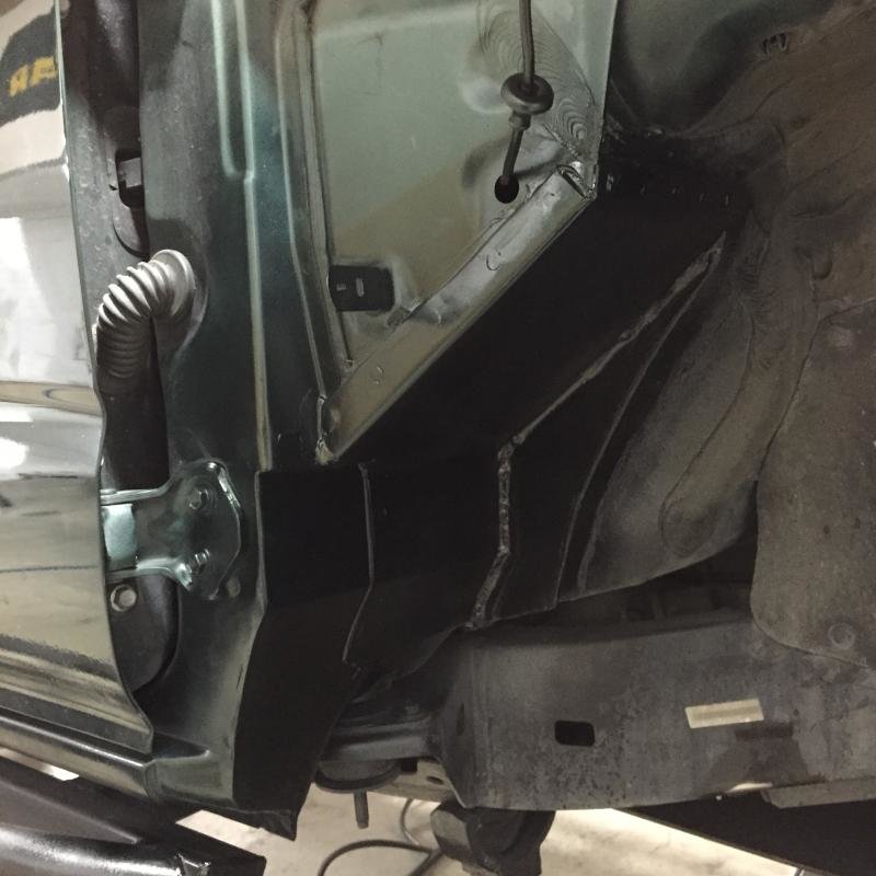

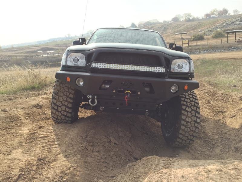

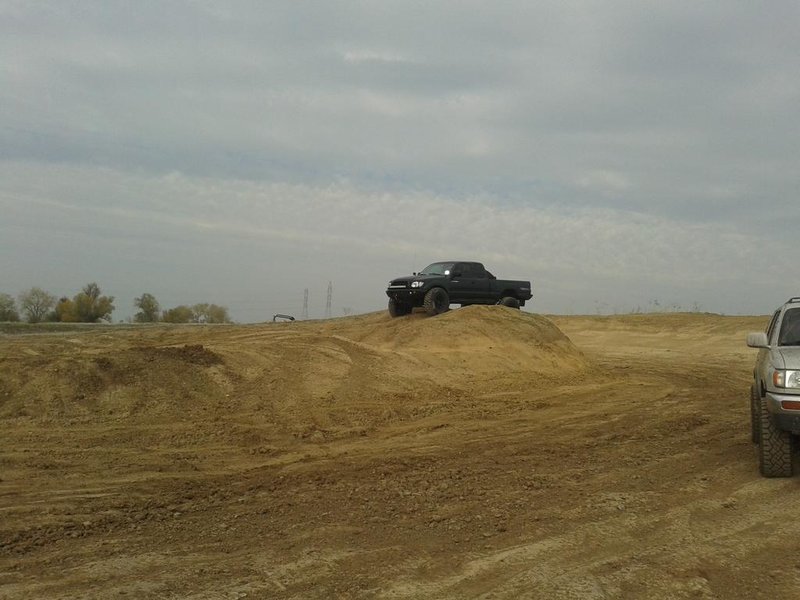

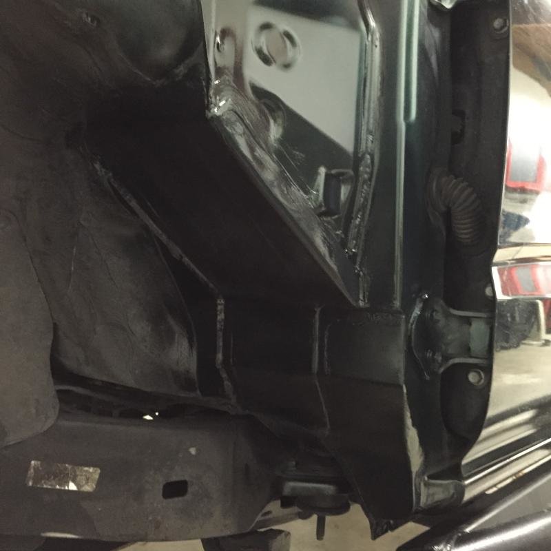

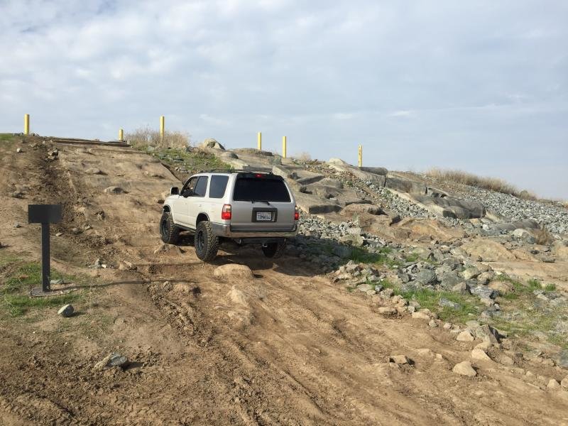

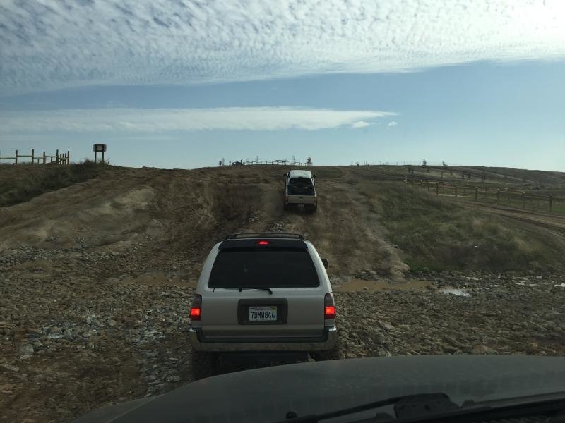

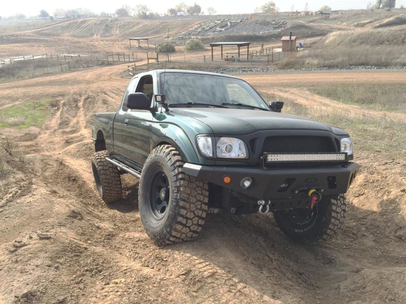

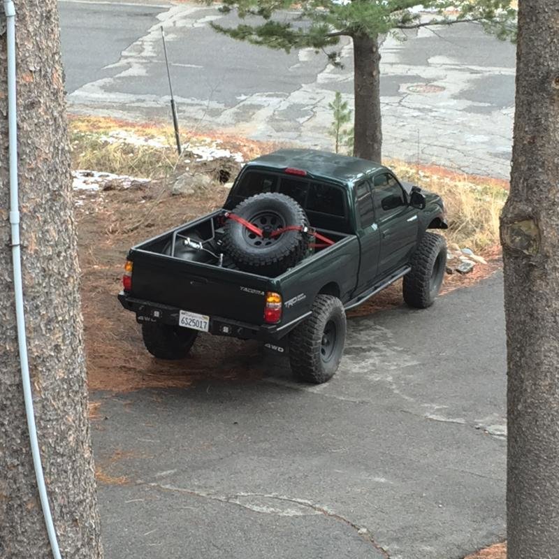

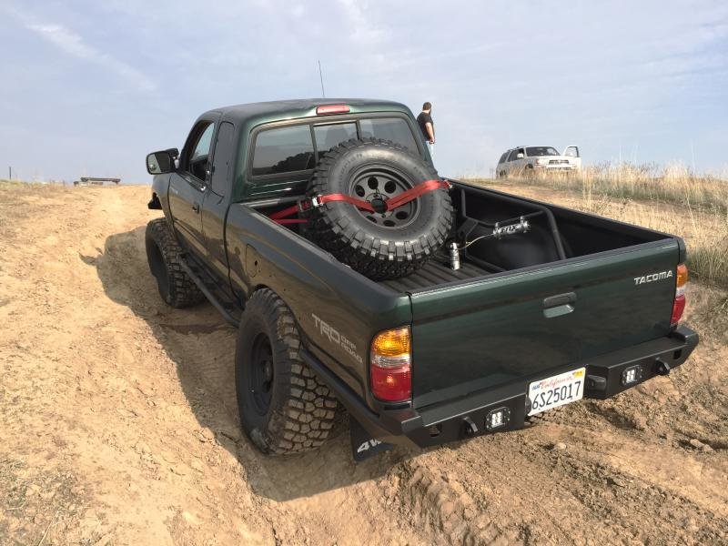

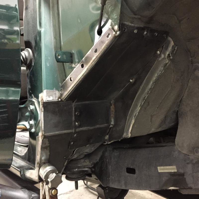

    lots of new stuff! 5.29's front a rear. tubbed the firewall, reverse lights in rear bumper. some recent pics.
    No rain while we were there it was beautiful, there was some mud but you know me! I avoided that shit like the plague, the only mud I got was from being to close to Ferny and getting sprayed a little bit.

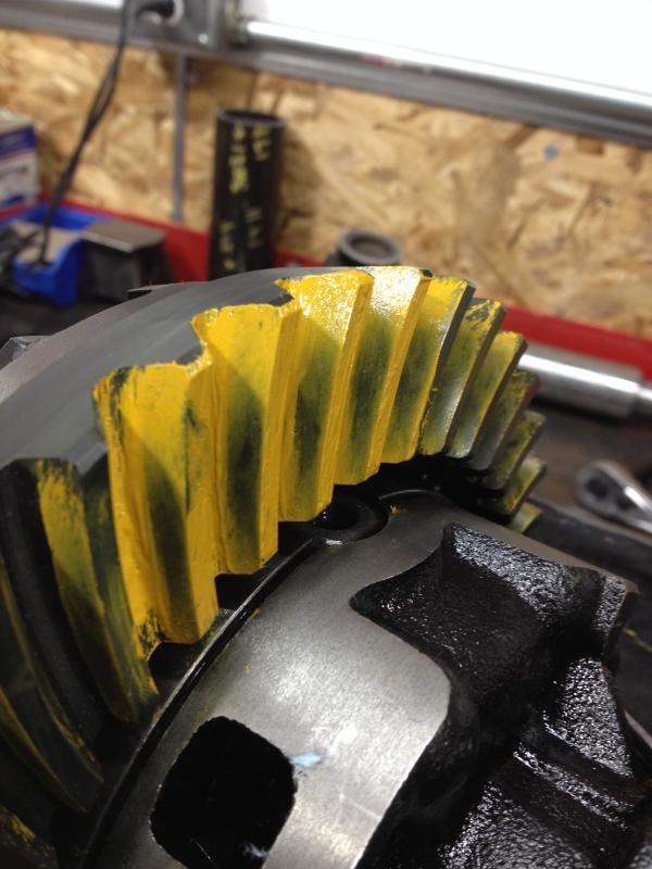

    I didn't go to hard while at PC because my rear 3rd member was leaking a bit, plus I had brand new gears and brand new pads and rotors in front. put 500 miles on all parts since. Bent my front fenders a little bit, got a little hairy on one line but it ended up not being a big deal at all, just needed some spotters.
    I was hoping to wheel a bit in Tahoe but we ended up ripping out my 3rd Saturday morning and re sealing it, we let it set up over night and it was good to go this morning. Glad my friend is a fellow wheeler. We went out in his Runner and roommate's Sami.

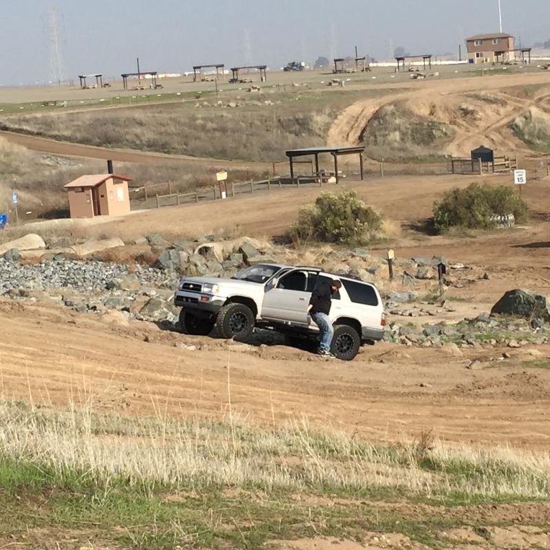

    Only pics I got.
    Brian's rig.
    hooligans

    That's a interesting way to tub... I like it! Way cleaner than mine! Lol did you cut on the body mount much? I trimmed mine but was afraid to hack at it to much

    Truck looks amazing!
    Are you going to be trimming your fenders? Possibly glass up front?

    Yes, I did a little already but the wheeling trip showed me how much I need to trim. No I don't think I'll ever do glass I don't like the look unless long travel.
    Thanks! The plan was to keep it clean and strong, no I didn't touch the body mount at all, cutting into the A pillar is bad enough, this is my daily driver and I would seriously caution anyone from cutting to much on a truck they drive on the street. Some of the guys on here That hack their shit up its because they are trail rigs, but I don't have that luxury.
