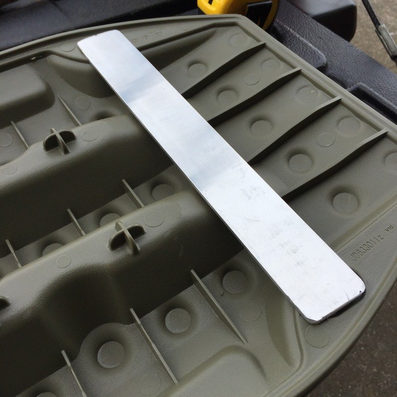

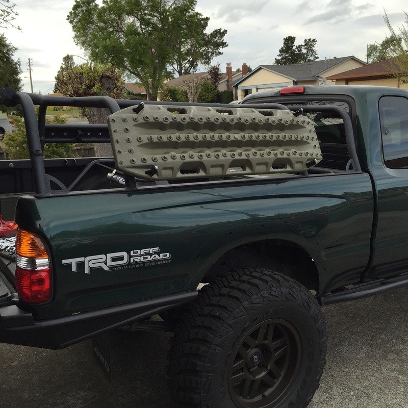

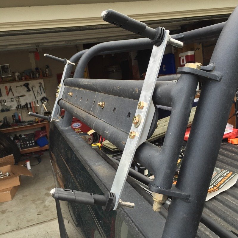

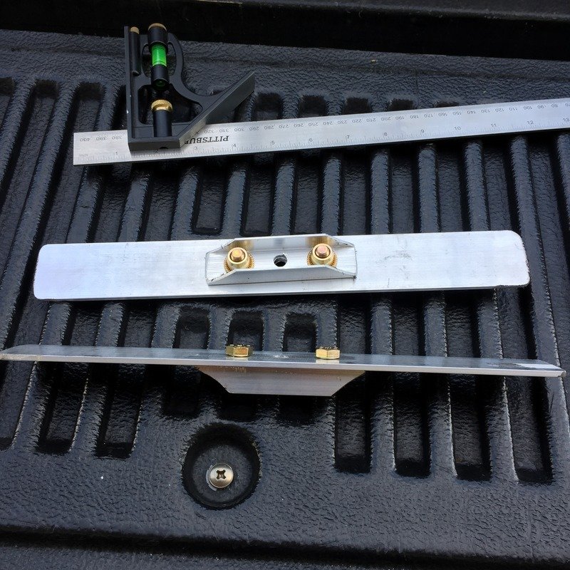

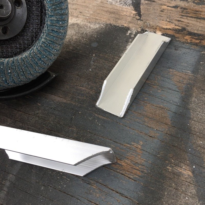

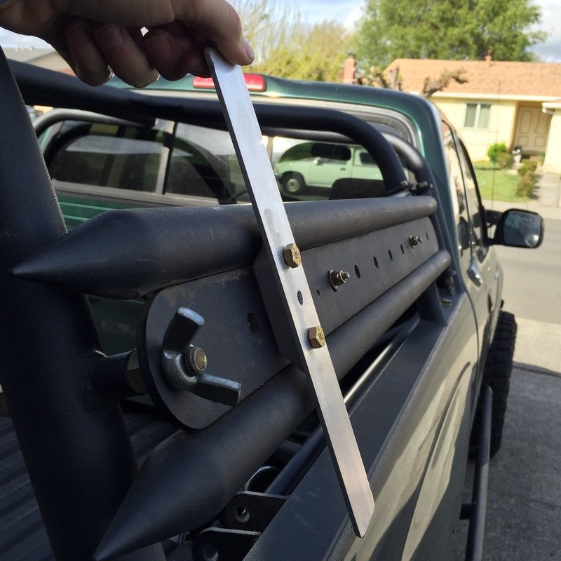

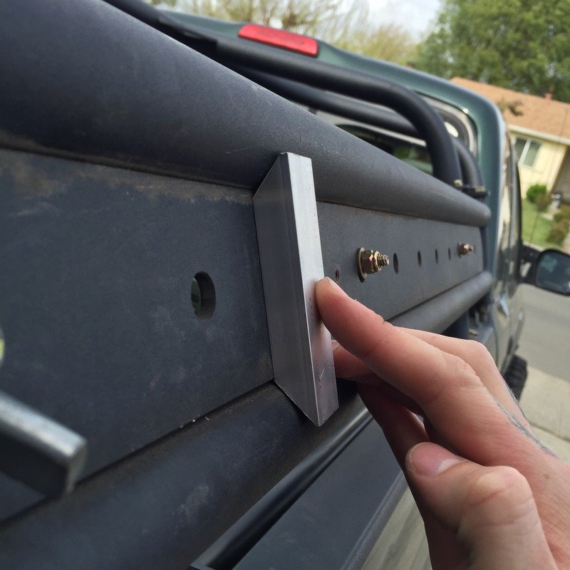

    Got some work in on my truck today but ran out of time for everything unfortunately.
    heres my "writeup"

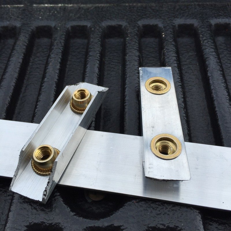

    first off was to make some mounts for the maxtrax, I got some aluminum c chanel and flat bar.
    made a rough cut for the base plates.
    next I rounded the edges slightly, mainly for looks as my fitment was a little off, I'm no fabricator although I enjoy it!
    next I used my riv nut tool and inserted some 5/16-18 nut serts, I love this thing, it wasnt necessary I just wanted to use it, If I had an aluminum setup I would have just welded them together.
    cut the flat bar
    bolted together.
    drilled holes for the maxtrax mounts and put them on the bed rack
    boom! they are done except for paint!

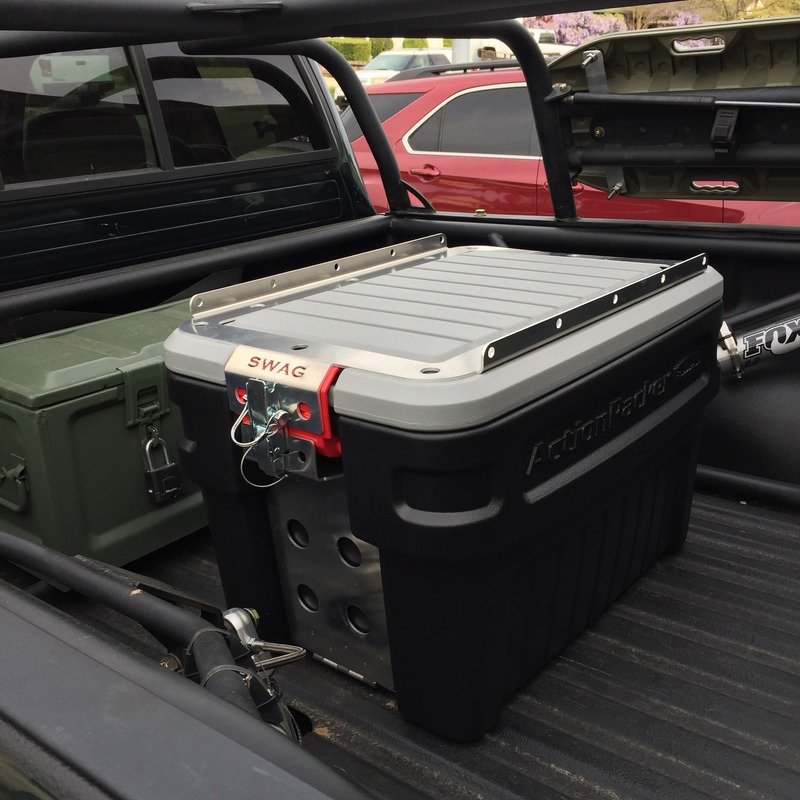

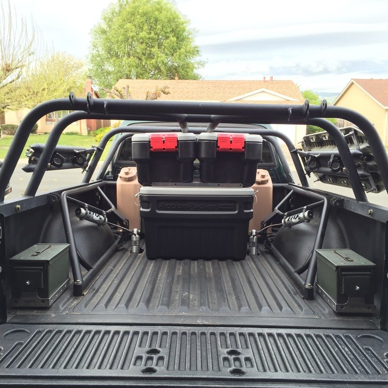

    also started to map out my bed storage for trips, I got 2 of the 24 gallon baja bins from SWAG, threw one together to get an idea.
    my plan is to have the action packers configured like this in 2 rows for a total of 6 altogether, along with the big ammo box thats behind (refer to op) the two smaller ammo boxes, room for a large cooler in front and the two 5 gallon water containers I should be pretty setup.
