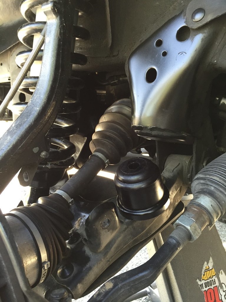

    I like it a lot, the coilovers have quite a bit of preload on them for the amount of lift I needed so sometimes they feel a bit stiff, but they handle the ruff stuff well. I'm adding some wheelers super bumps so I hope that helps a little with the ride. yes they are squeaky as hell, poly bushings squeak a lot even with grease, so do unibals, something you sacrafice for race truck parts.

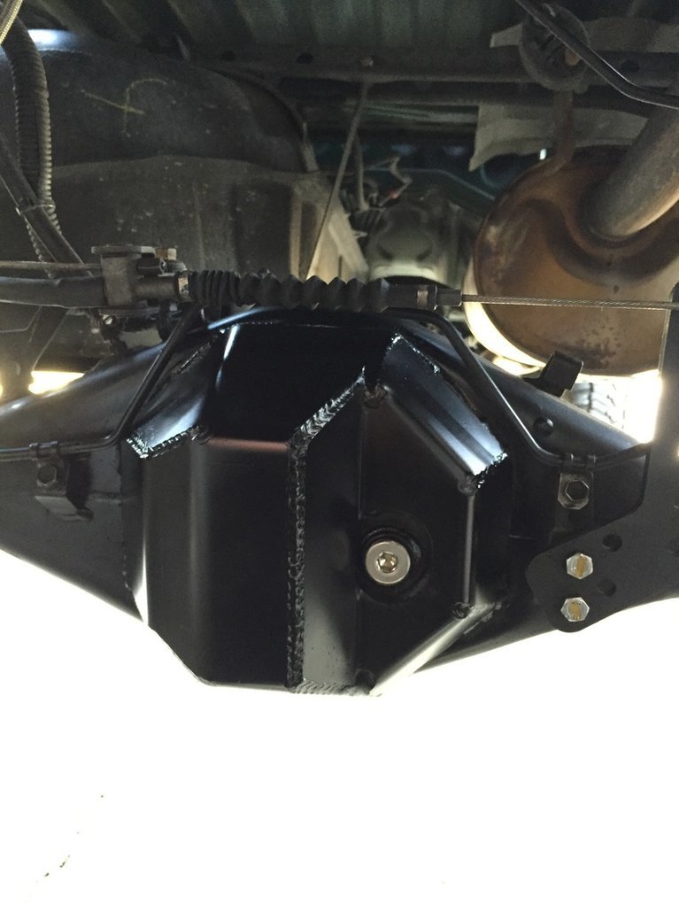

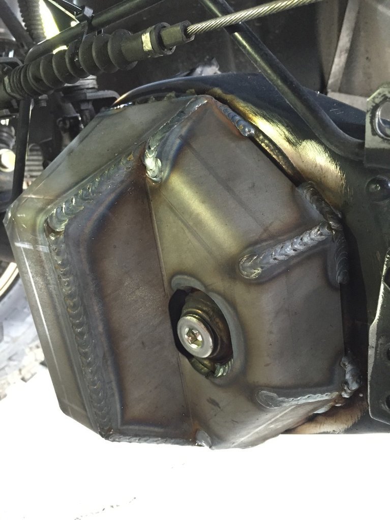

    Lots more mods done this weekend! definitely liking the ride with the wheelers bumps, they are designed for 2nd gens but Dan at wheelers said plenty of guys run them on 1st gens without problems, the problem is they hit the frame at an awkward angle not fully square to the frame.
    adjusted and lubed the e brake.
    wheelers super bumps on the backs of the lca
    marlin diff cover

    Haha nah! The cover itself comes pre welded that wasn't me!

    Diff cover is mean. Been looking to do one of those forever. Cody weld that on?

    Nah my buddy welded it on in trade for a small tattoo! Also I think this may be your first post in my build

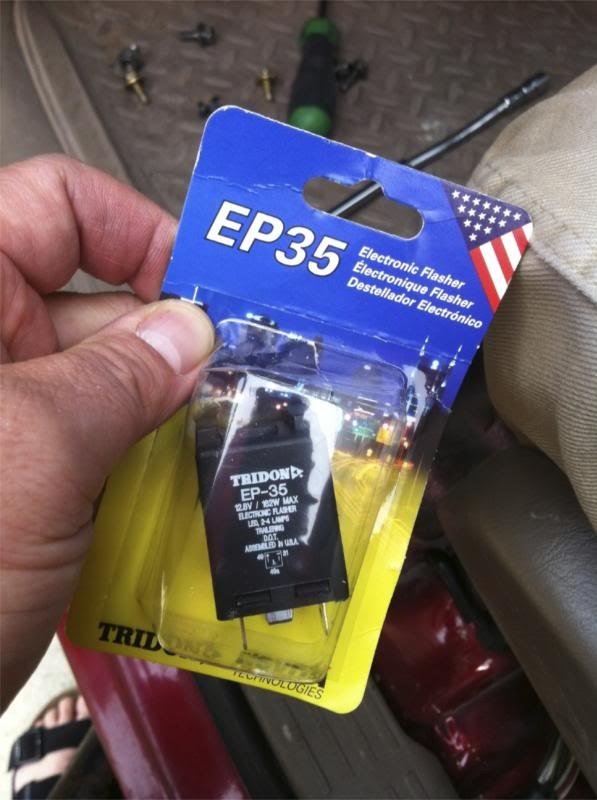

    Hey bro gotta a ? For ya.....were you able to get rid of your hyperlink when you put on the supplied apex bumper blinkers? I tried the EP-35 relay and mine still blinks 100x a sec LOL

    Yes it worked for me? The one that's inside the cab fuse panel?
