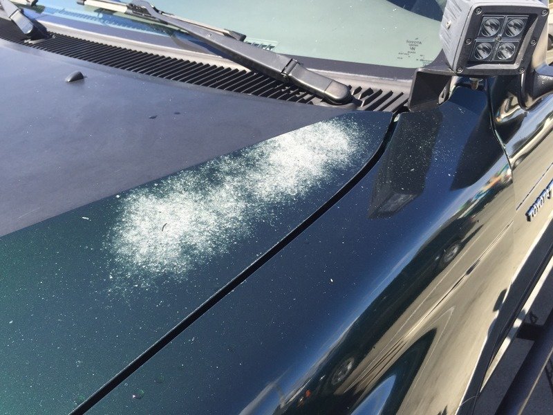

    More of a bandaid than a fix but I couldn't take the nasty clear coat on my hood anymore, wax and polish was starting to make no difference.
    Before

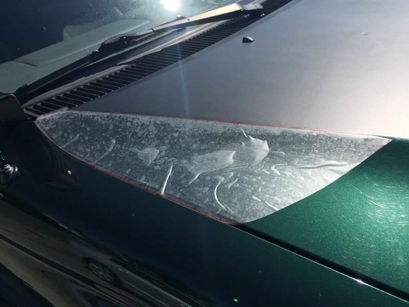

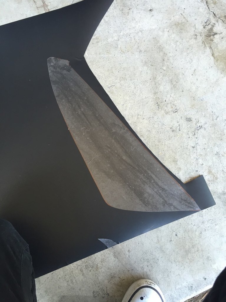

    I started off by laying down a big piece of carpenters contact paper, comes in a roll and is sticky on one side, I traced out a rough shape with a sharpie and cut it out, laid it on top of the spot and kept cutting/tracing to my satisfaction. Luckily for me I did a good job on the original hood blackout so I was able to use the same stencil on both sides they were identical. Use a straight edge for the long straight parts! The butted edge came out nice, it's not ideal but better than nothing,

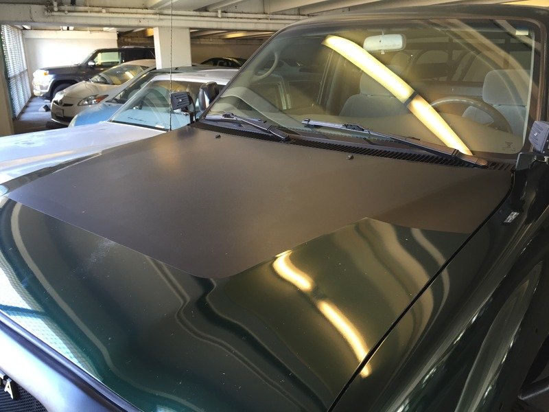

    The next step was to peel that off and transfer it to the 3m vinyl, cut that out and apply with water/squegie, there are plenty of YouTube videos to help you with that step.

    Continued awesome work man! That sucks about the sun damage to your paint, anyway to protect against that besides shelter? Would a coat of wax help protect the rest?

    Thanks! Wax helps a little, but I think most of the damage has been done, I don't think this paint ever saw wax until it was in my hands, stupid previous owners!!!
