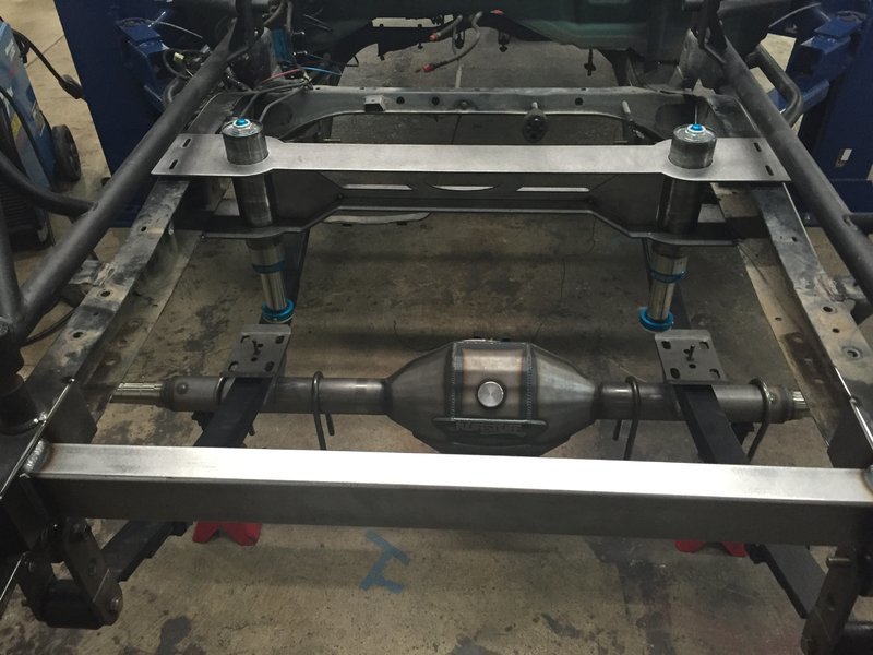

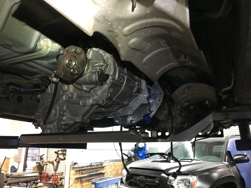

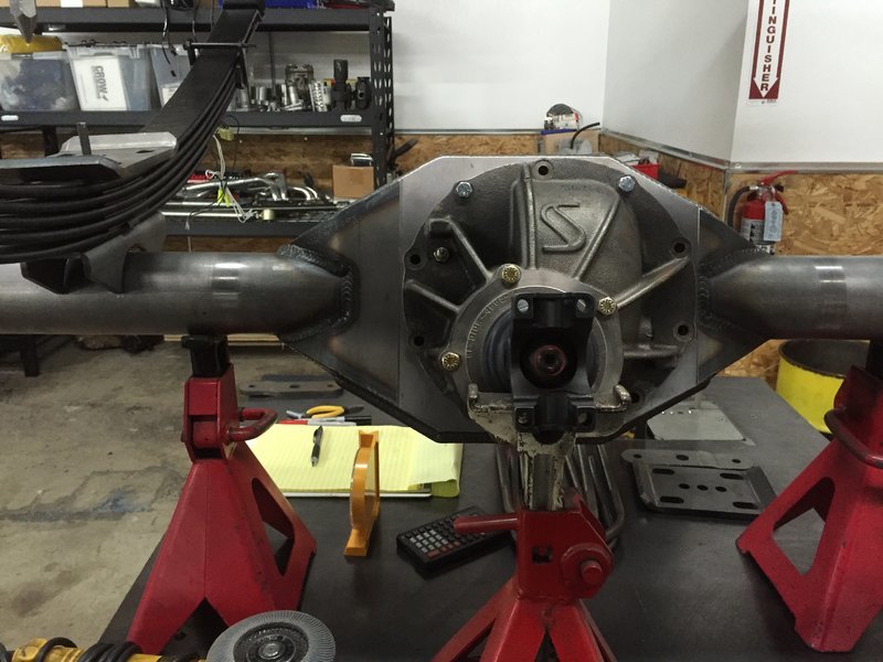

    I want to start this off first by talking about the builder, Cody Swinehart of Quarter Tilt Kreations in Petaluma, you can reach him at 707-799-5747 or Instagram @25tilt_kreations. Cody and I have been friends for a while now and he has helped through every stage of this build from the first IFS stuff to the entire SAS build. He has been a great friend and mentor to me through the whole process and I am very grateful for all his hard work, this dude never sleeps! From the get go I knew I wanted to be a big part of the SAS build, I didn't want to just buy the whole thing and have no idea how any of it went together. I don't have the time necessary (or skill) to make a build of this caliber, never the less I went down to 4 days a week a the Tattoo shop I own so that I could work with Cody 1 day a week on my truck. I knew it was important to see how all the major components worked, hubs spindles, knuckles etc. If shit breaks on the trail I don't want to be that jackass with a high dollar rig that doesn't know how to turn a wrench. I would like to add that I am somewhat mechanically inclined I just don't know the hardcore stuff like Cody does, but thats why I'm here, to learn!
    With a wedding coming and a Moab trip watching @JLee tear it up I decided it was now or never with my SAS build! Full parts list can be found in the updated OP. I have a ton of pictures on an actual camera I will add back into this when I get a chance but this is everything I had on my phone at the time!

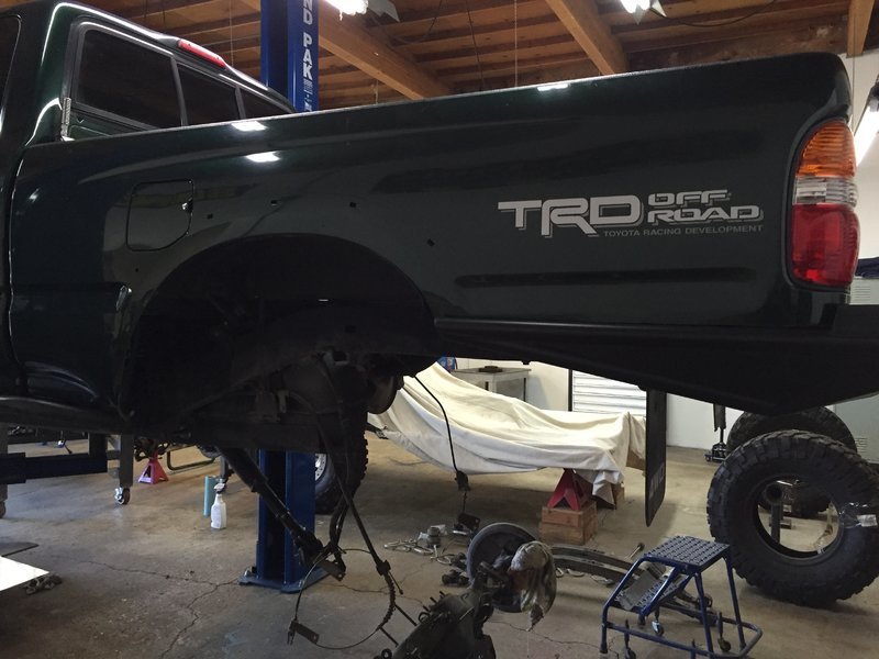

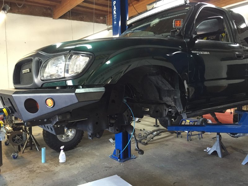

    Starting with the initial tear down and inventory of all the parts I would later sell. I was able to recoup almost $5,000 after selling suspension, diffs tires and odds and ends.
    Bed came, tank, exhaust and cross members came off for easier access
    all the "OLD" IFS parts cleaned up and ready to be picked up of shipped out. I had buyers lined up for almost everything. Thanks to everyone who was patient.
    @akamrkent wasted no time and was there to pick up my 5.29 diffs with ARB in front.
    Cody cutting off the old perches.

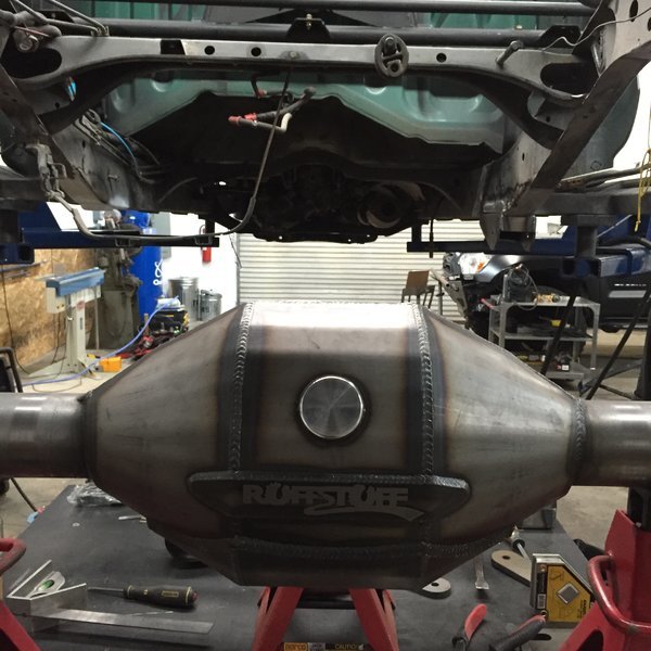

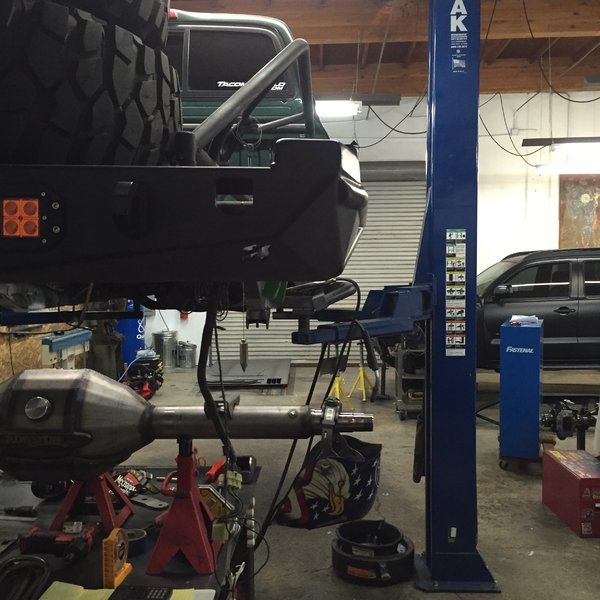

    Rear axle mocked into place.
    Gonna be wide!

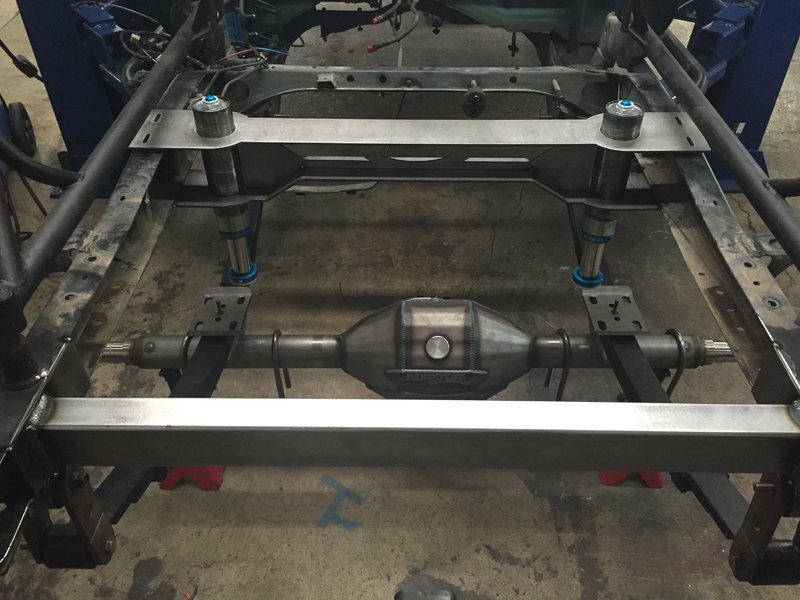

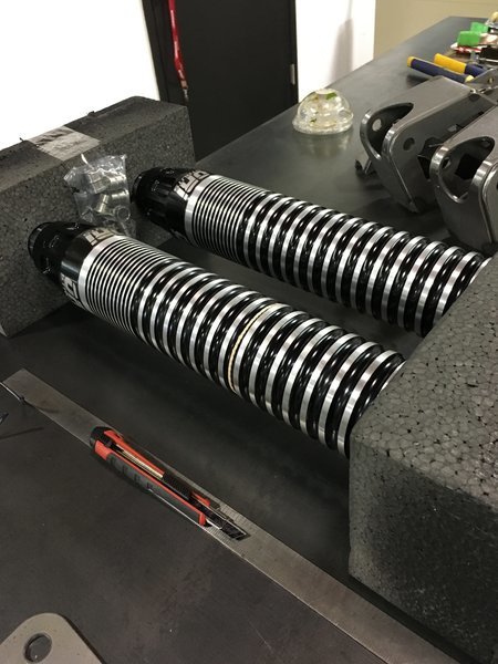

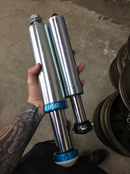

    Bump can crossmember build by Cody. king 2.5 4" and a rear cross member for strength, the rest of the frame will be boxed.
    Ruff stuff u bolt plates and some 63's that I completely restored, all new hardware, business, isolators, and full strip and paint. I had a deaver AAL lying around I added to the pack.

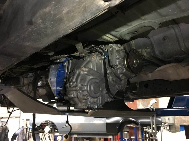

    LC Engineering 38b flywheel and Pro clutch!

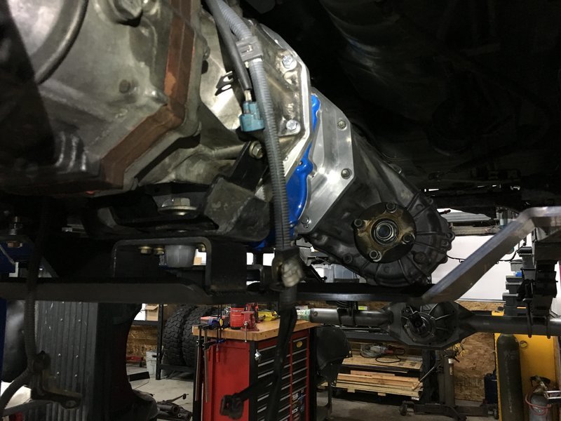

    Inchworm 2.28 crawlbox
    37's! about $3000 in a $2000 truck haha

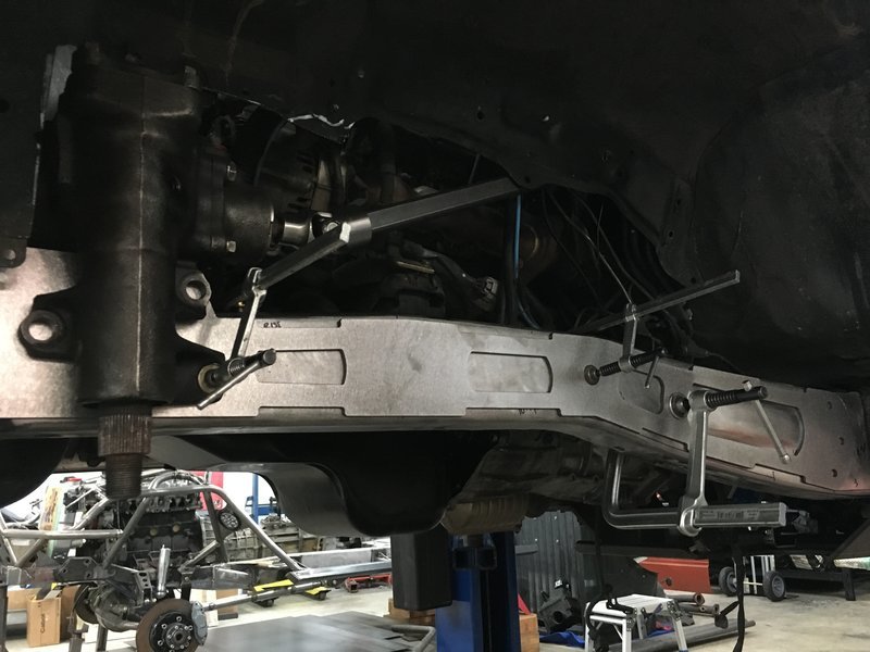

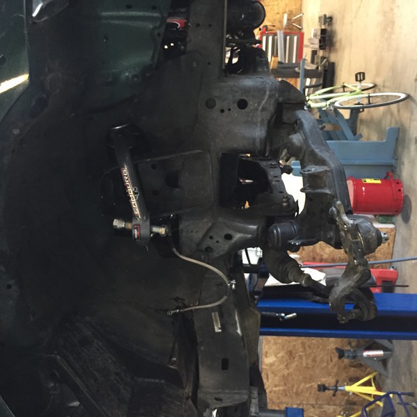

    Took a while but finally got to torching off the front IFS crap
    16'' ORI's came in
    Rad Designs triple stick getting mocked.
    Frame filled and cleaned up with some frame plates and temp mocking of steering box
    Assembling the rear hubs, this was the first time I had pressed any sort of bearing race in, Cody walked me through the process so I would know what to do on the trail.
    Front finally getting mocked up
    All the parts from Solid came in, we are switching the steering arms to the ones from Artec so more steering options. and more BEEF!
    Big shout out to @Bentrodder for helping get my wheels machined, the hubs from Solid were 10 thou to big so we had to machine out the entire center bore of all the wheels, they are a PERFECT fit, I guess thats why its called a machine fit.
