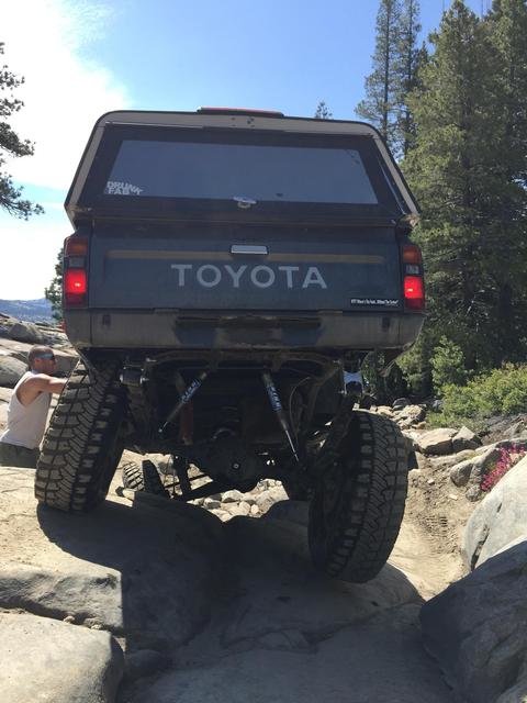

    Take in to account this a much narrower axle (stock SA width) but I love how mine work, if anything they are too soft. Loaded for a wheeling trip my truck sits prerunnered out.

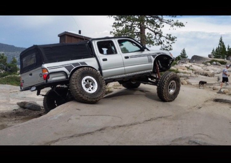

    Man, that is one badass DC. I'm kinda kicking myself in the ass for getting rid of my 63's. O'well

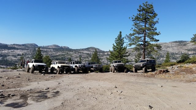

    I'm confused @Blackdawg, you said they ride like bricks and then that they are too soft? The main reason they make my rig sit like that it because of wieght, my truck doesn't weigh enough to make them sit down until I load up, and where they mount on the frame is different. I still have a block in the back, as does my friend with the tan 1st gen. They level tacomas out really nice without blocks though, every truck in this pictures (not sure about the black on though) are on 63s and loaded with gear on our way out of the rubicon.

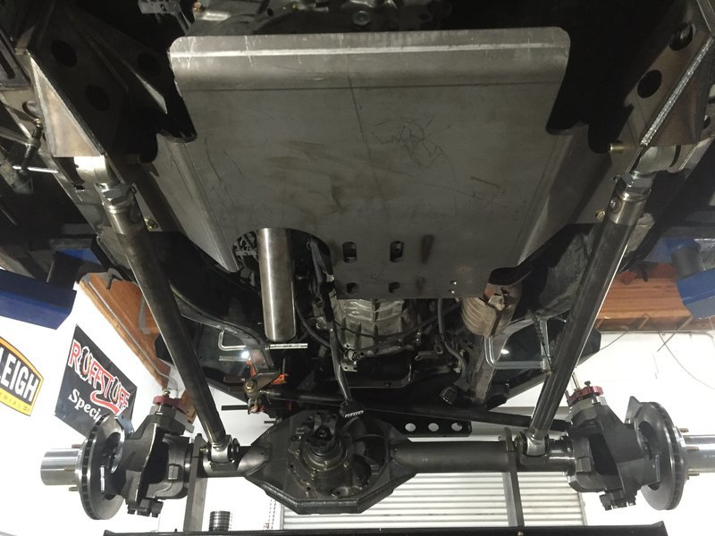

    In other news, frame plates behind link brackets and belly pan mount are in. Lower links are in. New steering arms from Artec came in today, working on upper link and steering tomorrow. We should have a roller sometime next week easily! Rear shafts are on order, still trying to get ahold of RCV for the front shafts... Hi angle driveline is working on the drive lines, shits coming together.
