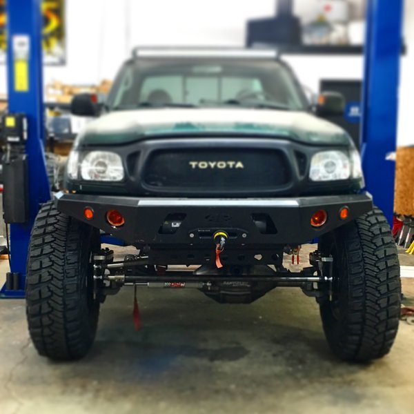

    I'll do a big update soon, here's a shot to tide everyone over.

    :eek::bowdown:

    Damn! Just, DAMN!!!!

    So much win with one picture...

    Looking sharp! It's coming together!

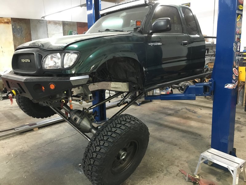

    Thanks everyone! I'll make sure I got that weekend off @joemauma, there will be a shit load of sasd tacomas there!
    Without the rear tires and full weight in the back it's hard to tell what the leafs will do but this is 26" frame height, ride height should look something like this.

    Looks good with the fenders not even cut yeah it looks like you can even go lower and still have good up travel if that axle allows.

    Yeah that flex check was stopped by the tire hitting the bumper haha. Right now it's at 5" of up, a lot of the front height for normal driving is going to depend how the leafs sit. I got some nice kings out back with compression adjusters, basically I can lock them out to carry weight. Hopefully that means I can keep the leaf pack soft and low for 90% of the time and just lock the shocks out a bit when I'm loaded down headed somewhere. Or when I have a shit load of stuff to bring home from the Mall.
