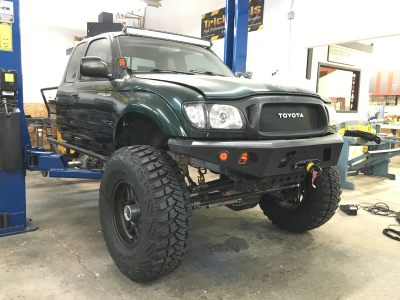

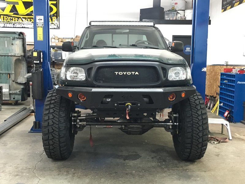

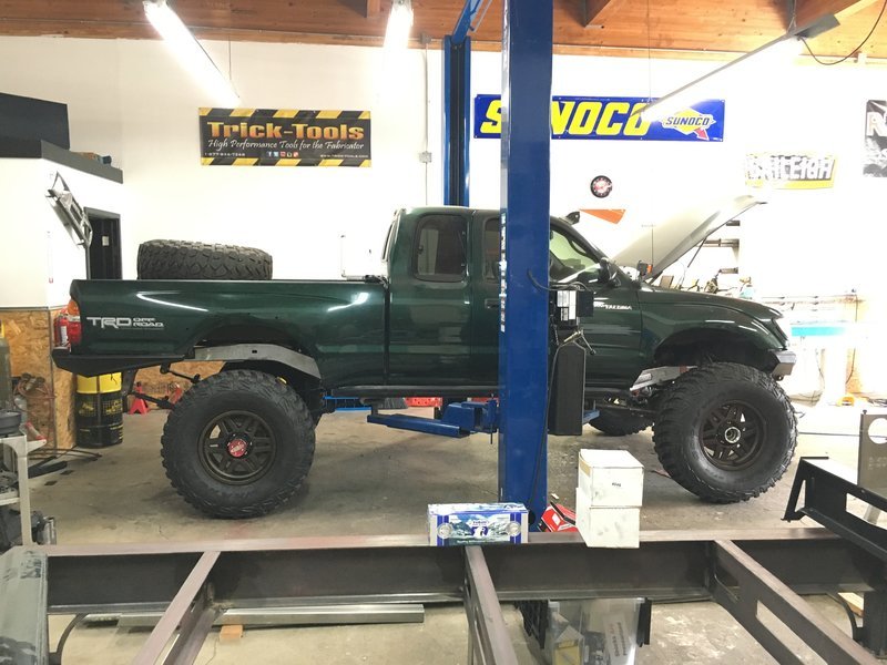

    It's getting close guys! Been away from Codys shop lately, dealing with wedding stuff, trying to move and being 3 months out at work I haven't been on TW much.
    ORI's are in, 1 ton brake upgrade is in, PSC hydro assist stuff is in. The only thing left to fabricate is the rear shock mounts. Also replaced the 6" shackle in this pic with a 4" to lower the rear a bit. Making leafs match links at ride height is fun.
    This is not ride height but it hasn't been together like this for some time!

    You might like the longer shackles since I'm assuming you'll be putting the bed rack, RTT and spare back on. Might be level now, but it would be sagging in the rear with a few hundred pound off on the rear at all times. Looking great though Jimmy! :thumbsup:

    How long are the lowers? What's the frame height at ride height? Uptravel numbers? Just curious to compare tangible numbers to the goals I have for mine. I'm gathering parts to 3 link mine and swap to tons so I'm always looking for info. Fab work looks killer bud!
