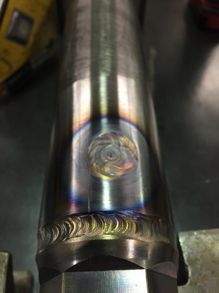

    Some final passes on the steering links. I am not great Weldor. But I try and someday maybe I'll be decent. These came out ok. image.jpg

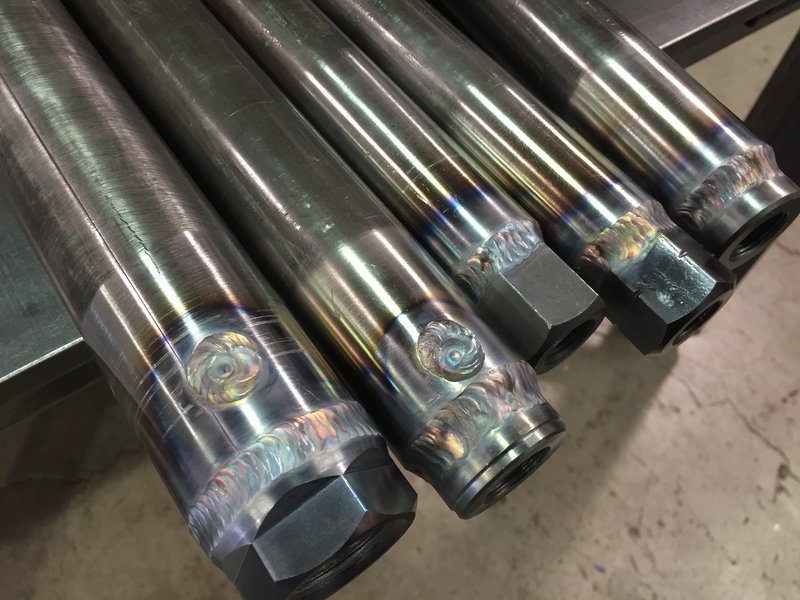

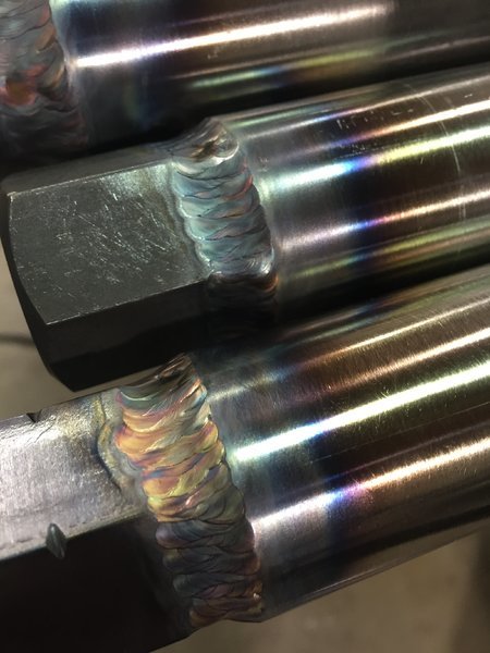

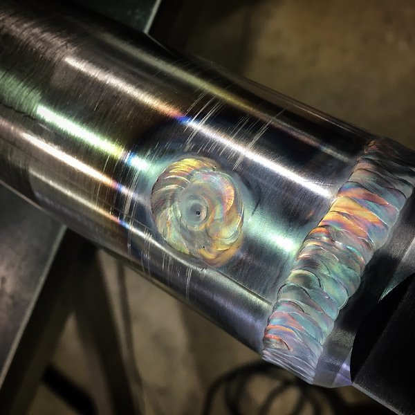

    And all the links are welded. Steering as well. Want a a time line on this. 3/4 days. Root pass and cap weave. All rod ends thread in without a hang up. The bigger links are the lowers. They are 2" .25 wall DOM. The pan hard and upper link are 1.75" .25 wall. And the steering links are 1.5".25 wall. 3/4" heims 7/8 heims and 1.25 ballistic joints.

    Those welds :drool:

    They look good man. If I could offer one bit of advice, when finishing the plug welds don't stop and then taper, taper off as your still moving and your less liklely to get the "asshole" to appear. It happens a lot when plug welding because the gases have nowhere to escape.

    Thanks. Yes I am working on it. More taper less asshole. Got it. :thumbsup:

    "I'm not a very good welder" *posts pics of dimes* :rolleyes:o_O
