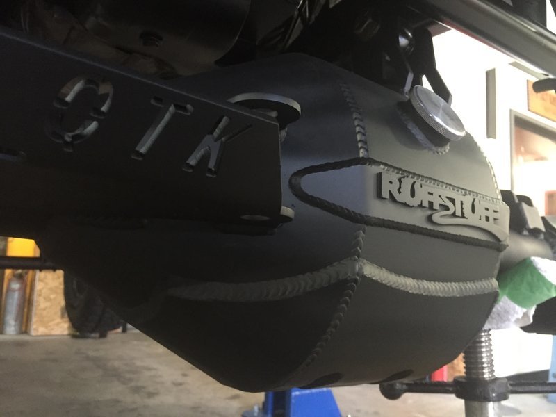

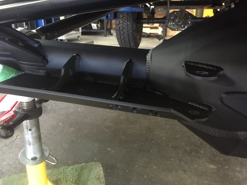

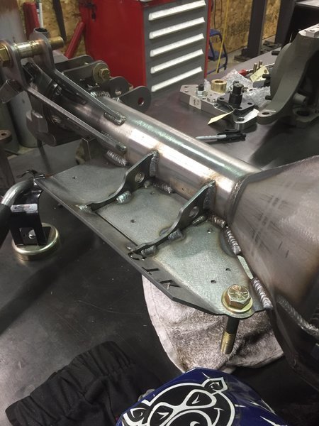

    Did you end up making a skid for the ram? Hard to see but looks like the tie rod would protect it for the most part.

    Cut up and sitting in a pile waiting for me.
    Oh I did. Been working on it since midnight. Went home took a nap came back. Now it's time to glue it on.

    Some shots of the ram mount and skid. It's Not finalized so that nut will be replaced by a custom Machined spacer. It's painted and drying more pics coming soo stay tuned gentlemen. It gets cooler!! image.jpgimage.jpgimage.jpg

    Is there a reason for not having the bolt go horizontal? Not enough room for a another bracket? Would make more sense to do that since it would leave a flatter surface for the skid. I'd be worried about maybe shearing the bolt off on the trail.
    Also any plans to box the panhard mount?

    Bolts temporary. Just a place holder for mock up. You'll see the finish product soon. Horizontal won't work. No room
    That's. 5/8" bolt it won't shear. It's in double shear. With 3/16" plate.
    Pan hard doesn't need boxing. The load path isn't in that direction. The front bracket is double shear the rear bracket takes the load and is gusseted by the ori mount.

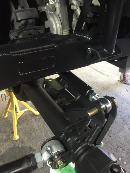

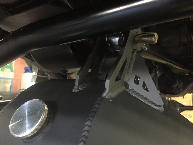

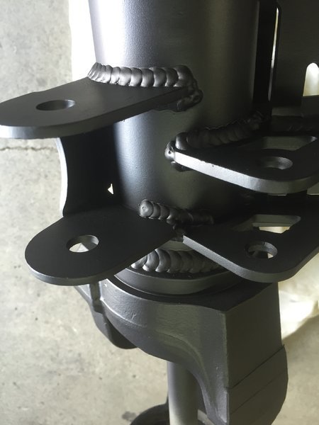

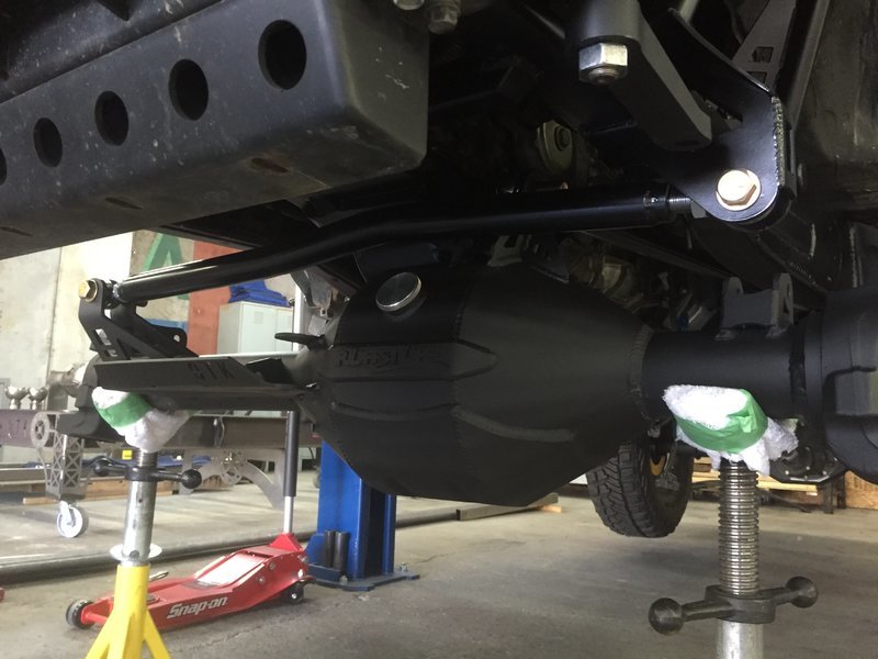

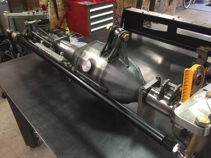

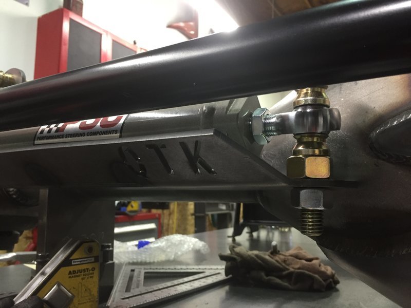

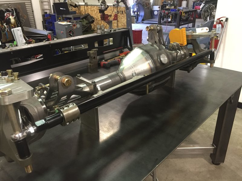

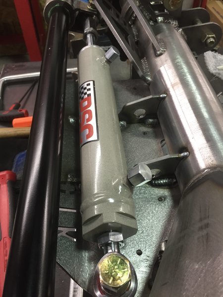

    Thx guys. Getting closer. Here's a few shots of the assembly of the front axle. It marks a huge milestone in the build process when things get assembled. Details to work out still but it'll be no time now. Looking forward to a good rubicon run next month.

    Rags on the jack stands? Total bro' truck mall crawler!
    :D Looking great!
