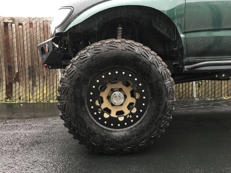

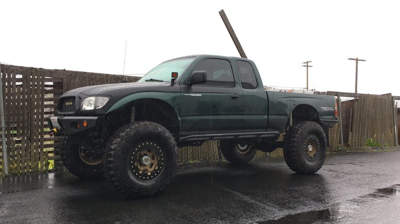

    Cody and I mounted up my beadlocks today, I got some 17x8.5 Trail Ready HDs. 3.5" bs. They are powdercoated desert sand and rattle canned the rings. All in all it only took the two of us a few hours to mount them. I'm very happy with the fit finish and quality of these wheels, worth every penny!

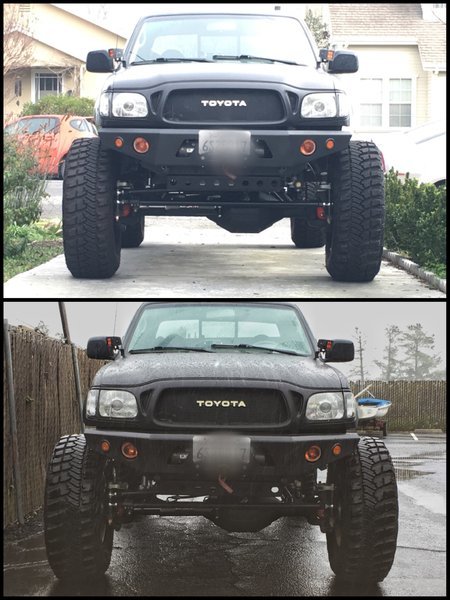

    I gained about 3" of overall width although hard to tell in these pictures, it is much more noticeable in person.
    omaguz, jberry813, Scenekyd and 16 others like this.

    NorCal - Santa Rosa
    2015 Supercharged Taco
    Mostly whatever sweet stuff I can find at Vatozone
    :drool:
    Looks great Jimmy!

    I thought I had a lot of tire poke! Looks good though. What's your overall track width now?

    Thanks Blake, I'm anxious to see your truck in person you've done so much since the last time I saw you!
    I have not measured yet, if I were to guess I would say 79" my axle wms is 67 in the front, rims are 8.5" wide minus the 3.5" bs so add 5" to that per side. Plus a conservative 1" each side for the tire comes to 79" aired down with the extra contact will be well over 80"
    She wide.

    You'll like the extra width, my last build (4 door JK) was 85" outside of tire to outside of tire and it was so nice on off camber stuff. It was a little sketchy on some of the local shelf road scenic trails we have out here in Colorado, but on the hardcore trails around here and in Moab on the off camber ledges and stuff it was super stable feeling!
    I also have a set of 9's (Spidertrax) in the garage that are going to be going under my 4 door 01 Taco once I 'm done building them, my plan is to keep them 69" wms-wms, once you've wheeled with full width axles its hard to go back!
