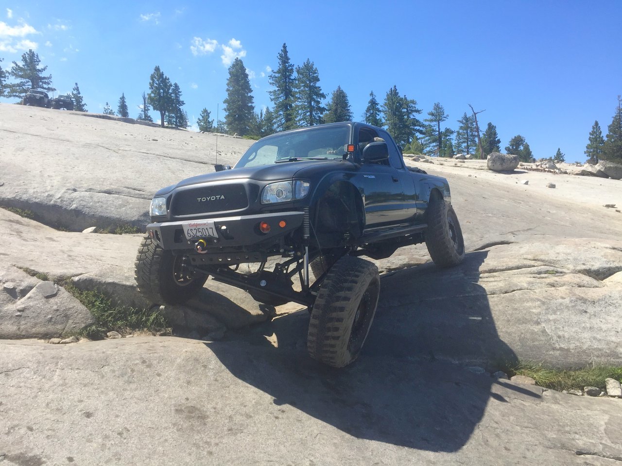

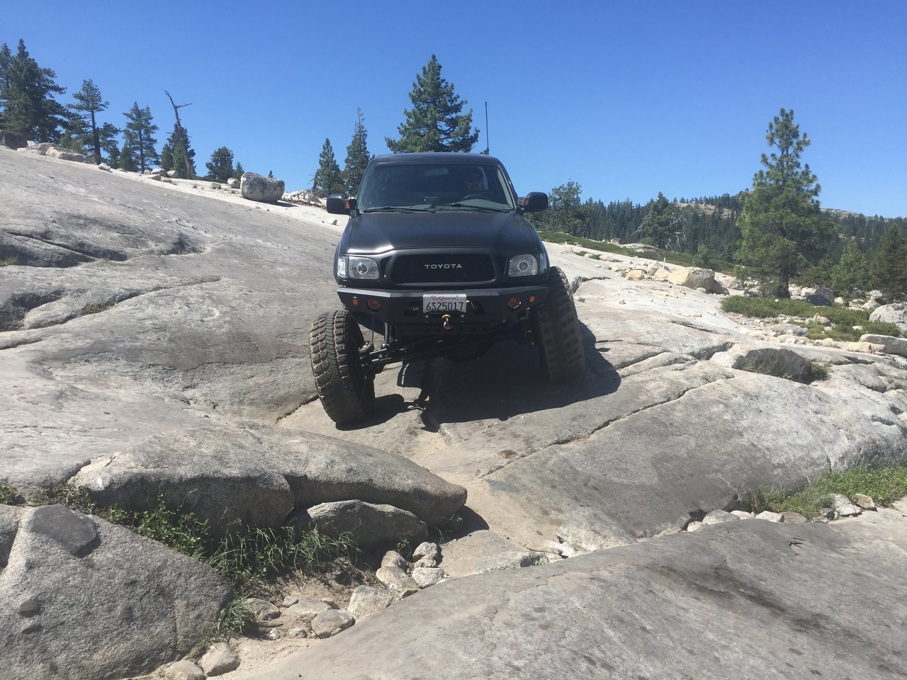

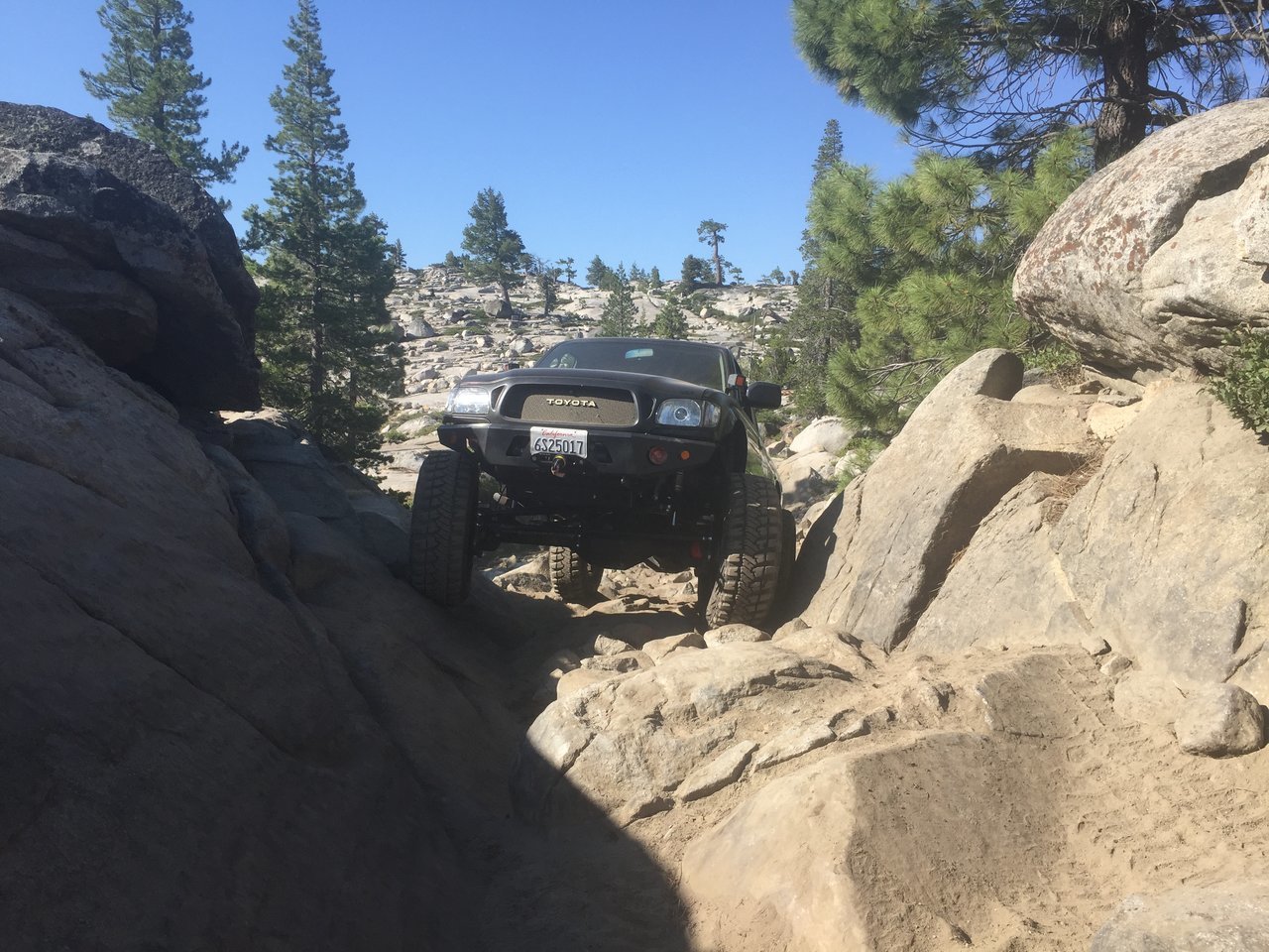

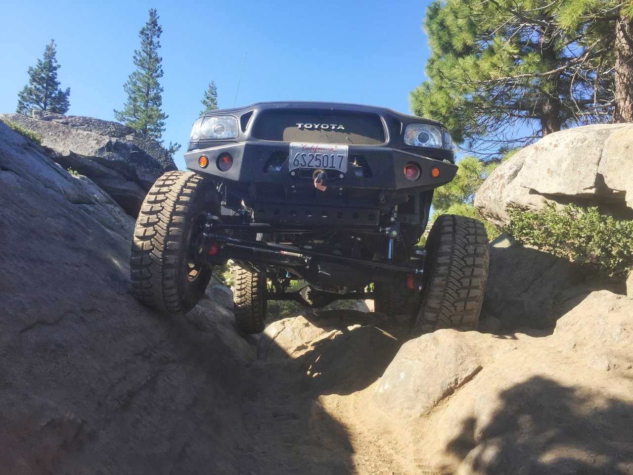

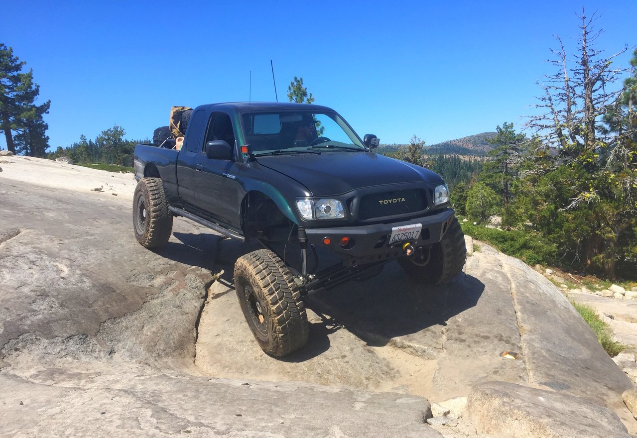

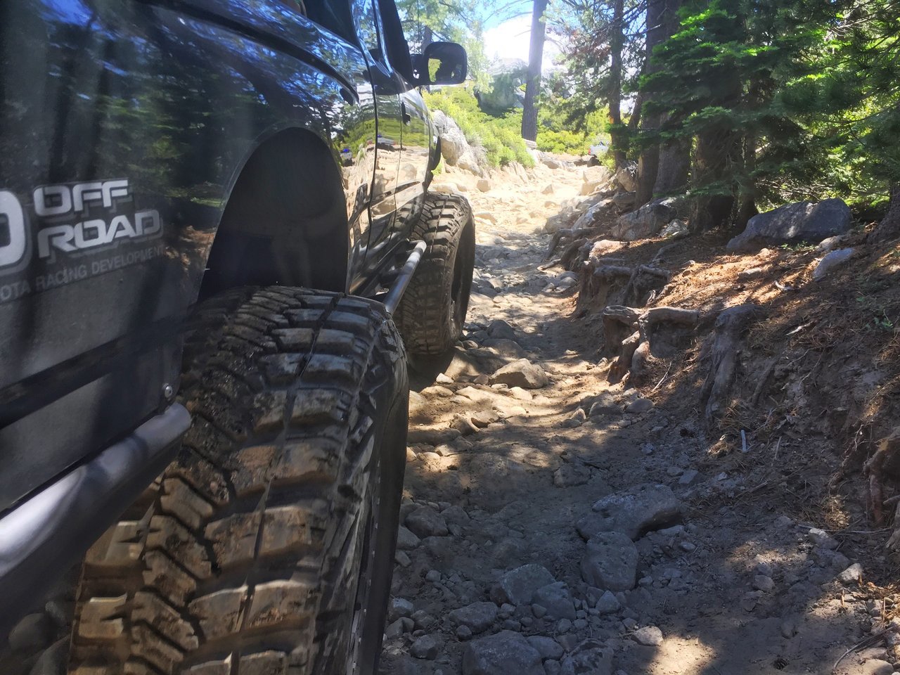

    Rubicon Trip 7/6/16
    Only issue to report is a slightly bent steering ram skid plate and a leaking steering box! Other than that she works great!
    IMG_4848.jpg IMG_4888.jpg IMG_4855.jpg IMG_4852.jpg IMG_1259.jpg IMG_1260.jpg IMG_1261.jpg IMG_1262.jpg IMG_1201.jpg
    jubei, Holloman, tacomgee and 6 others like this.

    She works well, chasing steering system gremlins still, trail gear box won't stop leaking, also replacing the ram clamp with some ears welded to the tie rod. Other than that and some beadlock vibrations the truck was flawless. She will go anywhere you want her to. It funny my buddy was used to being in short wheel base early toyotas. He was spotting me and kept being amazed at what this truck could do. I couldn't be happier!
