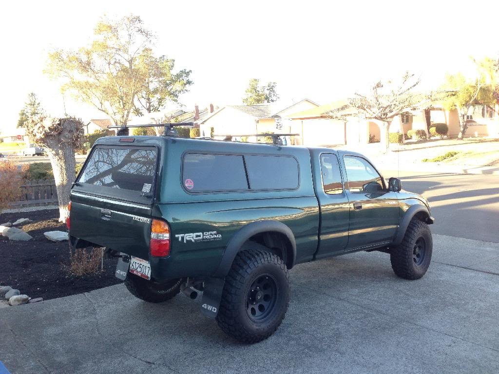

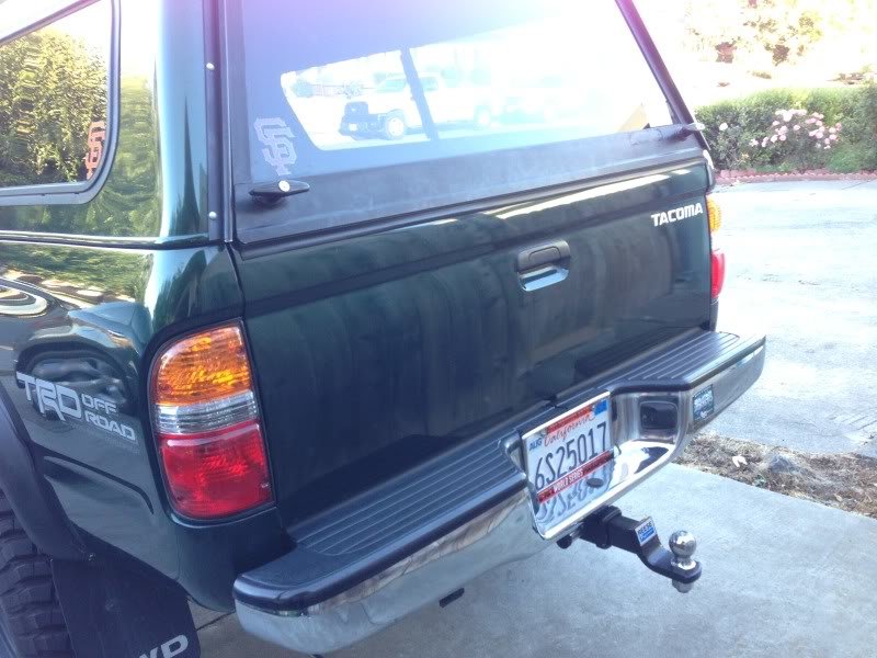

    Freed up some weight in the rear, removed the undersized spare and accompanying brackets, rear bumper, and tow package. Than I relocated the license plate and made a quick bracket to mount one of the license plate lights so I'm legal.
    Curious does anyone know the correct license plate light LED equivalent?
    I should have done this a while ago, went for a test drive and it feels a lot lighter. Also now I am wanting to hack off my tailpipe since it hangs down so much.
    before and after.

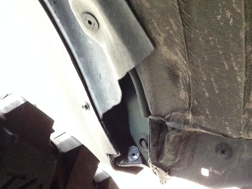

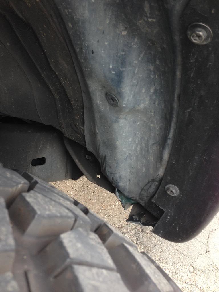

    it depends on your lift, I have a 3inch lift, backspacing is 4inches. They still rub, take a razor knife to the plastic inner fender and beat the pinch weld on the body mount that the wheels rub on. you will not avoid rubbing, but its no big deal, easy fix. good luck!

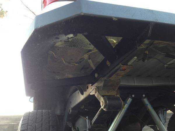

    Hell yeah! I wanted to go high clearance from the second I saw one. Bobbing is on the wish list. Wanting to get into a house soon so I'm trying to hold of on mods for now. My bumper that I built; thinking about adding to it later
    Any idea what style you're wanting to go with?

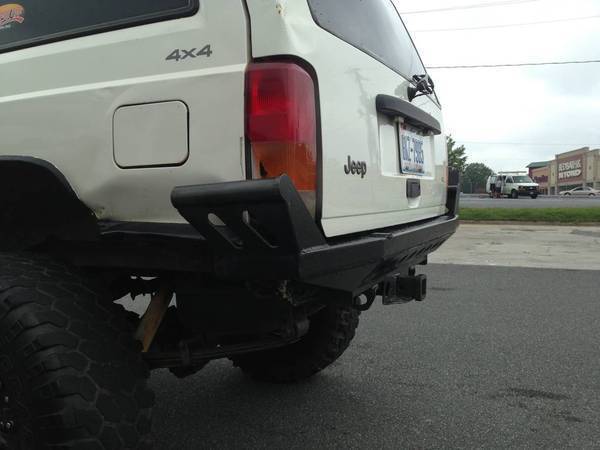

    Yeah I may do a little plating under down the road but I only had so much time to get it done. Like my buddy's jeep:
    I actually have the plates already cut and in my toolbox just chillin... haha. Some people can pull off swingouts but I don't think I'd like one on my truck, but go for it! And the license plate holes weren't too bad, I mean I cut the shit out of the bedsides.. what's 3 holes in the tailgate? And dad dropped his 800lb four wheeler on it a few years ago so it bent to hell already. I might do a tire gate but we'll see
