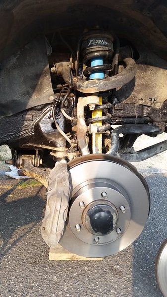

    Changed the break Pads rotors, and driver hub/VC
    I also Installed Tuff Country Uni-Ball UCA's

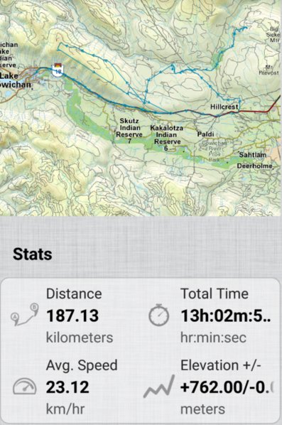

    Lake Cowachin Trip - September 2015
    A short While ago, Shane (A local to the area) offered to take me an a few friends out to check out some areas by Lake Cowichan. The access was off a cut off under the power lines. We checked out various camping spots near the river, as this area is popular for recreation enthusiasts. We also saw a recent fire, which looks like it could have started from a vehicle (vehicle was burned as well - This was right under the powerlines.... I know Shane has the GPS Route for the majority of these, but I must say having him show us around was a major help as this allowed us to avoid some technical features, and helps us not get lost in all the winding roads that are present here. He also took us up to a viewpoint at the top of a logging clear-cut.
    The access is up the back way and through an older "stump" forest from previous logging activity. Shane flew this area where I slowly creeped behind. I did not have sliders at this point, so I was pretty nervous.:turtleride:
    http://www.christiantisdale.com/
    This was likely the most technical strip of trail I have ever ridden before .We didn't take too many photos as we were looking at trying out Video (coming soon), but here are a few snapped while up there (more soon)
    We camped the night by the river, in a spot recently affected by a mudslide. The drainage ditches on the old access roads were likely to blame.
    The next day pushed on to Mt. Prevost and Labour Day Lake Near Nanimo (See Post TBA)

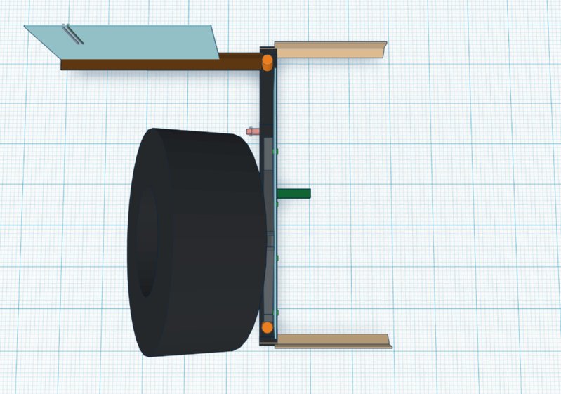

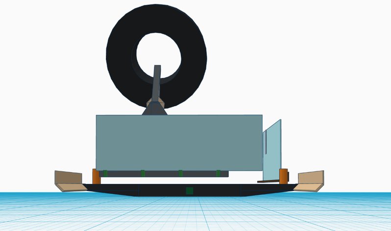

    Was playing around with some free online CAD softwear today trying to think of designs for a rear HC Bumper with swing out. I know on my last trip near lake cowichan I found myself hitting the trailer hitch quite a bit.
    I started with Shmellmopwho's thread for reference, but decided I wanted to also have a Dual Swing Out, along with Dual Tables for additional space for cooking. I still need to add the Jerry Can holder onto the swingout which currently only has. This also shows a 35" tire to scale almost, and both of the tables fit underneath. The tire also does not extend past the vertical line made with the tailgate to allow for a topper to be added as well. Any Suggestions are Greatly Appreciated!!!
    Color notes:
    Black - This is a 69" 4x4 Square tube. The bottom side will be cut to allow for the angles shown. Its has 2 indents - the first is a 2" drop by 2" indent towards the center from the corners. From here the final indent drops the other 2 inches, but indents another 1.5 feet
    Grey - 2" Square tube
    Light Blue - this will be my table top surfaces. Im thinking aluminium to save weight and they will be on hinges. The table which is on the swingout without the tire will have slots cut out in it to allow the shown added support for the tire holder (still need to add more support I know). The size of the eating surfaces will be roughly 18" (tire side) and 22" (other) so thy dont go higher then the tailgate
    Tan - This will be material used to help support tire carrier, as well as the plating used on the side once the fenders are cut off. not sure on thinkness yet.....
    Light green - these little triangles will be used as supports for the table
    Light Red - This will be my recovery points. Planning on doing it like in the one references.
    Dark Green - Standard 2" hitch receiver
    Brown - This L shaped Bar will be the main support for the second table / jerrycan holder, and the L design should tuck nicely under the 2x2 tire support and about the 4x4 main part. I think I will need to modify it a bit on hit its mounting to clear the 2"tube fully.
    Side view With Tire swingout table supports shown
    :welder::notsure:
    Im hoping the dimensions work to somehow make it where the tire mounts mount in different positions to allow a sled deck position...
    I also started to make some Benson X Tool / Hi-Lift mounts to attach the the rails in the bed. Should have 3 sets of each after I'm done (only half shown) for extras for friends.

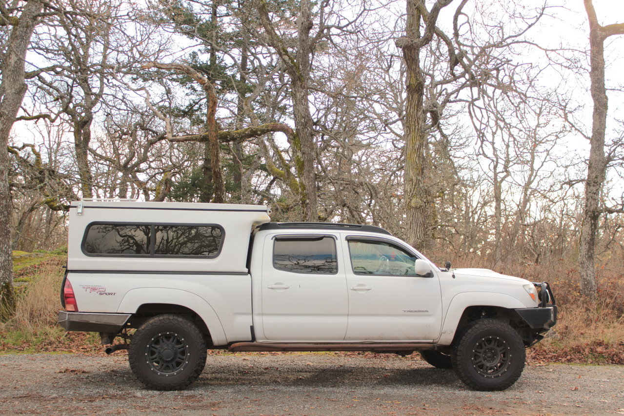

    Trip reports have been lacking as its been since last time i drove her was early dec before i noticed the cracked LCA and installed the coilovers... hopefully soon once I get the spanner wrench to adjust coilovers, an alignment then can get to some new spots..something
    Although I rented a U-haul and picked up a topper!!!

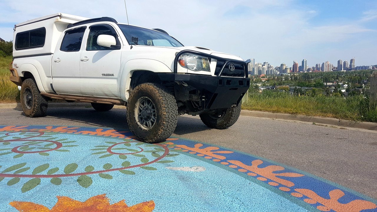

    Got my bolt-on sliders installed
    And then drove back to calgary the next day.
    Where i spent a bit of time doing work on houses, broke my camera, and found cool parking spots
