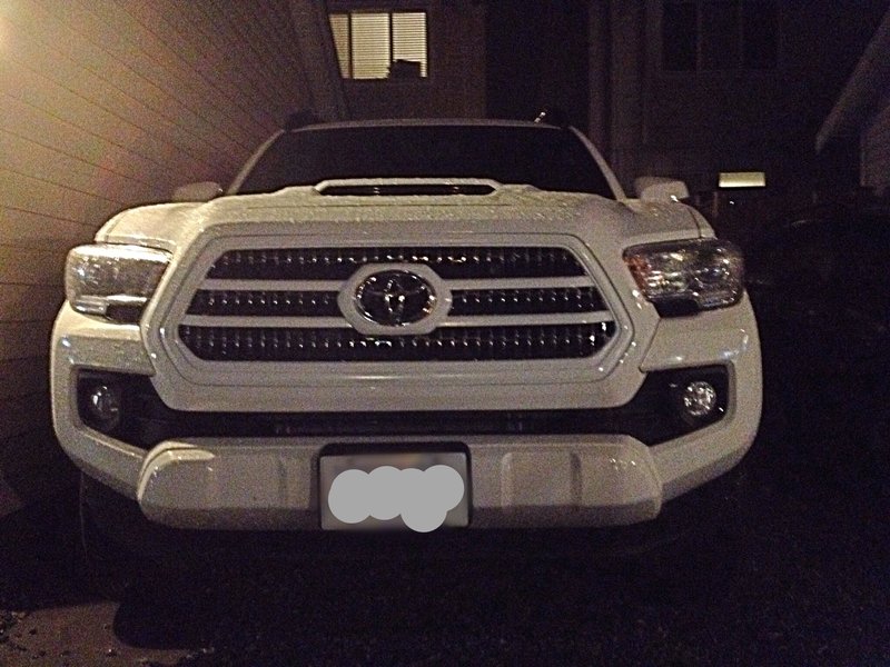

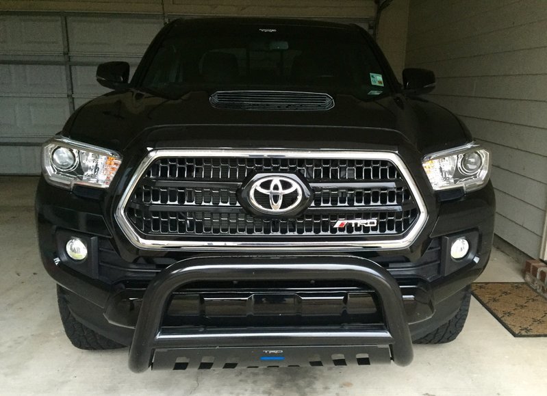

    So I figured if I screwed this up, I would just plasti-dip it and probably get an after-market grille down the road. I am no paint expert, but have quite a bit of shop experience, so I wasn't too worried and wanted to do it right. I think it ran about $70-ish with factory paint and clear being the high dollar items.
    Here is what I used and why.
    Denatured alcohol to clean any surface before painting.
    Adhesion promoter to make the stuff stick to the chrome.
    Flat black paint and flat clear coat for the gridwork part.
    BBP spray from automotivetouchup.com
    Some badass clearcoat. This is expensive 2 part, but worth it.
    First : De-gloss
    I spent quite a bit of time on this part really getting into the gridwork.
    Next, clean up with alcohol, spray adhesion promoter then flat black.
    FYI, mask first then spray the adhesion promoter. If you mask over this stuff, your tape will stick and leave a ton of residue for you to clean up ;).
    Next, flat clear coat a bunch of coats. I did 3 flat black and about 5 clear flat.
    Next. mask and spray BBP....after cleaning up a bunch of tape residue. I did 3 coats base and 2 clear. I would have done 3 clear, but I nailed the finish on the second coat and didn't want to risk a third since I wasn't sure how much was left in the can.
    Clearcoat then let it cure. USE a respirator mask with this stuff if you don't bother with anything else. IT is really nasty stuff. I ran a razor blade lightly around my masking before taking it off so I wouldn't get any pull-up.
    Final product back in the shroud.
    I think it turned out really nice. In retrospect, I probably would have painted the whole thing with the flat black and then masked it off. Also, I busted the clips on the emblem, but just epoxied it back on at the tab locations.
    Definitely better than the braces.
    Edit: Another user asked about removing the grill, so here is a brief description.
    There are two screws and two-reusable pop-out pins that hold the shroud in (all on top). The reusable pins come out by prying up the center with a small screwdriver which releases the pin. There are several wide unbarbed tabs that hold in the bottom of the shroud. Once the 2 screws and pins are removed, you kind of have to work the bottom shroud tabs out with a bit of wiggle/pulling. They are pretty durable and easy get out.
    The outer trim ring is screwed on with about 8 screws and also has barbed tabs. Remove the screws, and it has about 5 or 6 tabs that have to pop out (they are a bit more chrome than the others). They will want to snap back in until you get a couple started, then the rest come out easier with the help of gravity. You could also stuff a piece of cardboard in once you get one out to keep it from snapping back.
    The grill itself has several barbed tabs that need to be carefully popped out. Just be careful and use fingers rather than tools. I overbent one tab on the trim ring, but between the screws and other tabs, it literally didn't matter. I just bent the barb back for looks

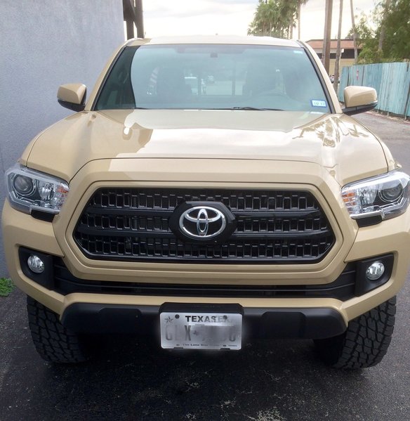

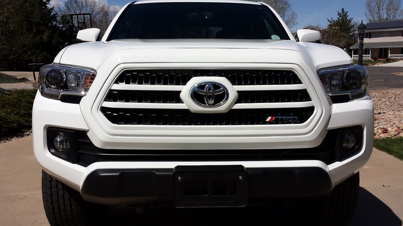

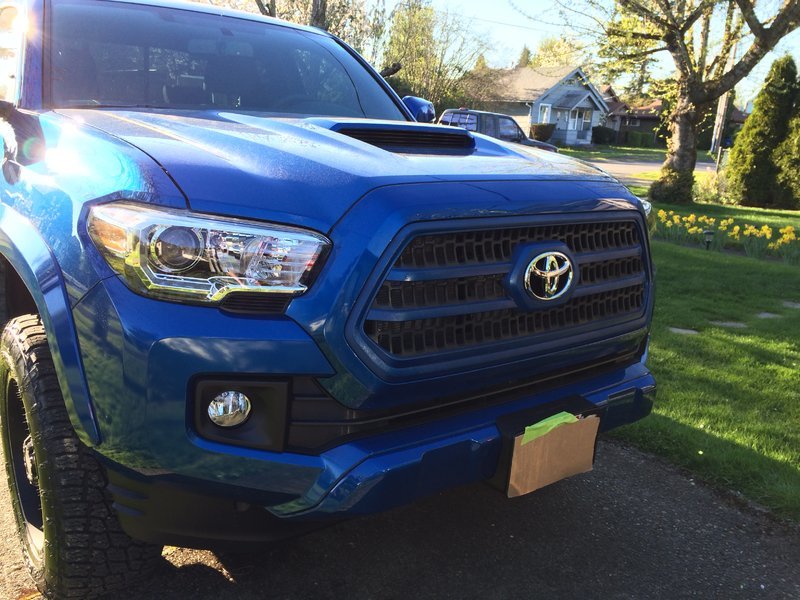

    Thought I'd include a few from down the thread--some colored, some just paint:

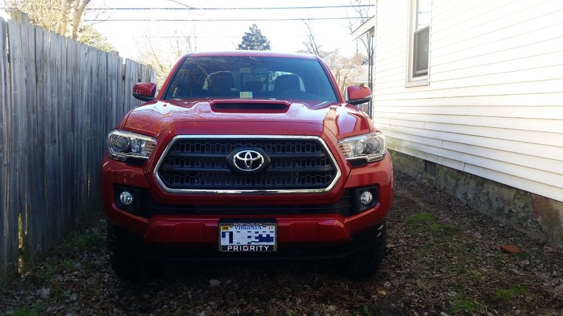

    Did mine today. A little different.
    Here is before.
    wahoobie, 69TACO16, fshams and 16 others like this.
