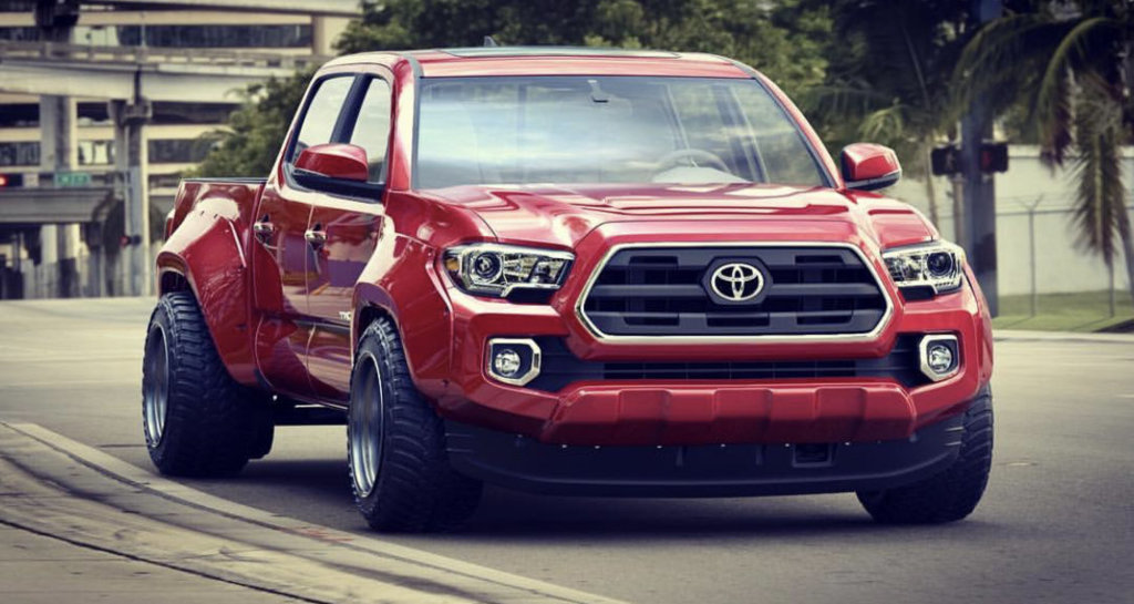

  17. May 8, 2025 at 9:31 AM
    #77
    Nirango kid
    Nirango kid Well-Known Member
    Jun 17, 2021
    #368856
    1,635
    Gilles
    Ontario
    2021 Tacoma TRD Sport Premium in Barcelona Red
    I love the looks of my 2021 TRD Sport and would not trade it for anything else as it was just made for it.
    Here is a pick of a different kind of grill. No mine got it online somewhere. sharp looking truck
