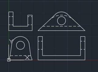

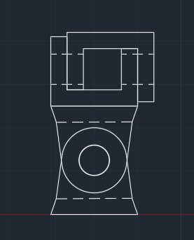

    so just to keep you posted, when I sent the prints to barnburner, he noticed we should thicken the metal and have smaller hardware on the mounts V1
    This really bothered me because it increased the overall height
    So my overly perfectionist side got working and I found something pretty clever.
    The bottom mount now has a weird shape with widening plate (otherwise I could not cut from 1" tubing), and the top portion is now 100% weird, but it works on design.
    I was able to reduce overall height to 2.1in while beefing up to 3/16 metal and 5/16 hardware using a full size washer
    the overengineering takes time, do it once, do it right.
    Look at this baby, notice how the two "ears" of the top mounts are now not the same height...
    Oh and it keeps full 90 degrees adjustability so you can use the mount for bed rails for a bed rack and pitch, roll and yaw adjustment.

    Looking good. I definitely like the low profile look and function. I'm looking to bring my RTT down at least 3" maybe 4.
    Thanks for update...still patiently waiting :D:frusty::thumbsup:
    "Do it once, do it right" :amen:

    Pretty inovative. What side connects to the rail vs the Tracks on the cross bars? Is it safe to assume the part on the lower portion of the diagram connects to the tracks on the canopy?

    You've got it - bottom on the track, top on the crossbar.
