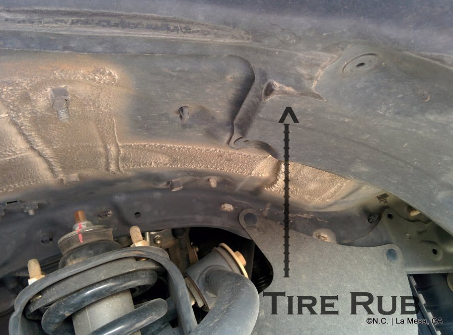

    The time has come for me to beat my pinch weld flat for the front fender wells. My tires are rubbing and it's driving me nuts.
    I have noticed at least three methods based on my searching here.
    Pull plastic fender liner out and:
    1. Beat the pinch weld flat to the inside of fender well
    2. Beat the pinch weld flat to the outside of fender well.
    3. Some people cut / notch it in sections and then beat it flat.
    My question is are any of these methods better than the other?
    I completed this job in July 2016
    SEE PAGE 3 NOW FOR PICTURES

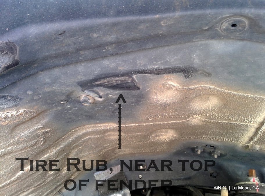

    It wasn't until yesterday I realized how much rubbing was occurring on the trail. Not only are tires rubbing the pinch weld, they are rubbing the top of the fender liners too.

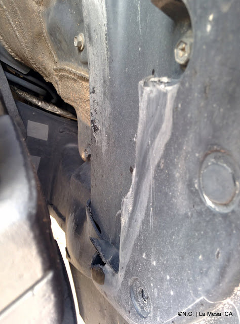

    Lower pinch weld / Mud flap

    That lower point is exactly where mine was rubbing under compression, but I did some trimming at the lower fender flare and I'm not running front mudflaps (not sure if you got a chance to see that). As for the rubbing at the top of the fenderwell, you have tall tires and a heavy truck. Might be time for more lift or heavier springs. Or you could just slow down a bit on the trail.
