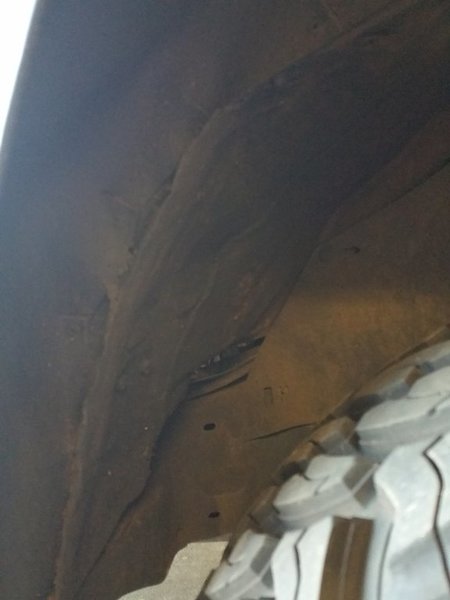

    Thanks for the picture. So you just beat it flat to the inside then and seam sealed it. Thank you.
    Welcome. You know me, probably end up writing up somethin. ;)
    ;) I don't know man. I know I love my truck and I can't wait to beat that metal outta the way. I just want to make sure I do it right the first time. :thumbsup:

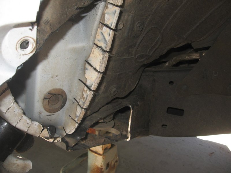

    Here is @n0rth 's pics from his build.
    He doesn't say exactly what he did here, but it looks like he cut it then alternated the folds (one in, one out, repeat, etc.)

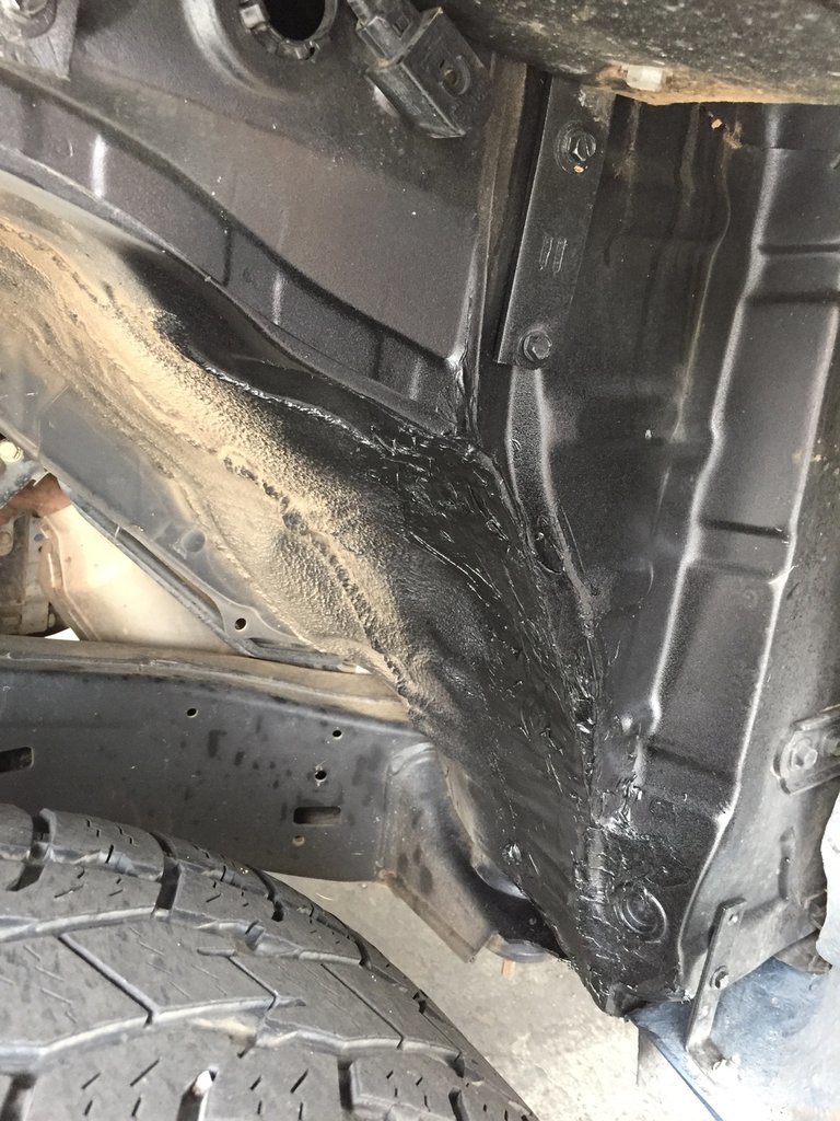

    Before
    After
    No rubbage on my end after

    The idea was to leave as much metal in place for strength but get rid of the pinch weld, by alternating the thought was it locks it together. Haven't had any leaks and the dupli-cote rattle can bed liner wore off years ago.
