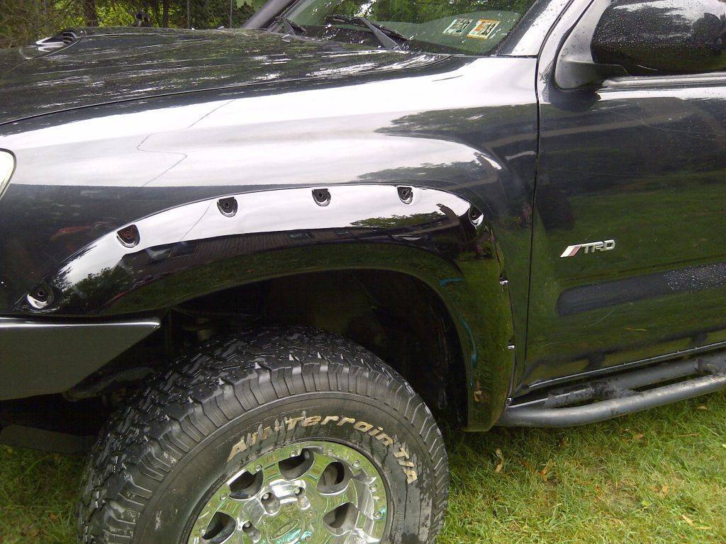

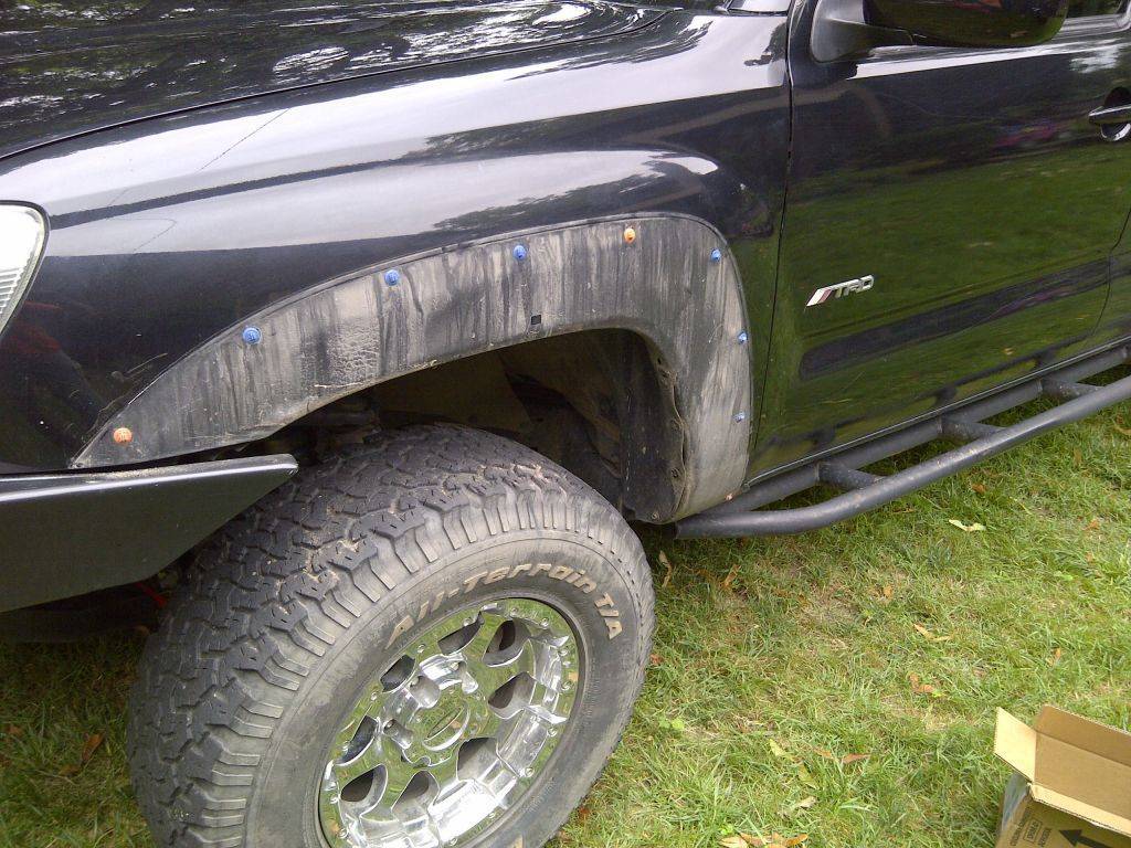

    Took some time & removed all of the stock flares and inner fender lining on the drivers side.
    Two things of note on that:
    First - a TON of yuck was jammed in the "dogleg" of the fender...
    Second - Somewhere in Japan there is a mechanical engineer laughing at me because he designed those maniacal fender clips.:mad:
    I ended up just cutting most of them - fuck it.
    I had done this prior with the passenger snorkel install so I at least knew what I was getting into.:rolleyes:
    Here are pics of the process:

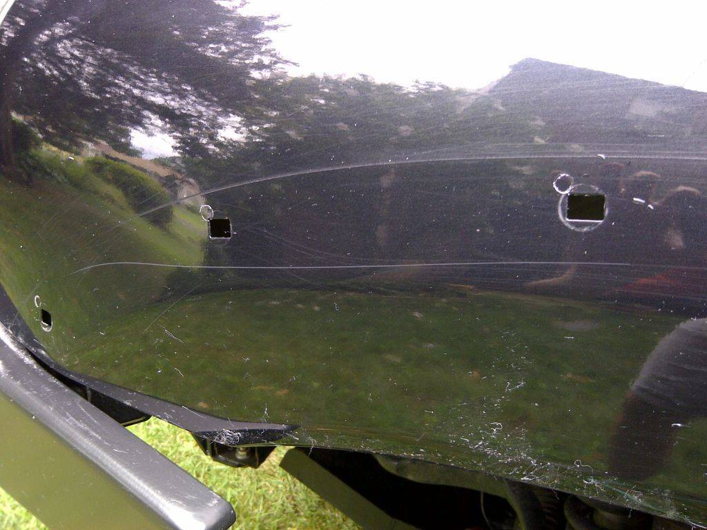

    I took the yet-unaltered flare and test fit it to the fender in order to get an idea of where I'll need to be drilling...
    They do not have an identical coverage to the stock ones...
    I took a straight pic and as gently as I could marked where the flare holes will line up on the fender:
    They are close but it really won't matter in the end because the flare will cover any screw up...;)

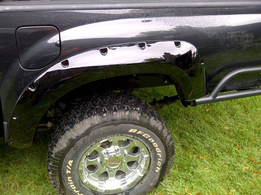

    The rear was pretty much the point of no return...
    Due to the fact I have already chopped 8" off of the bedside for the HC CBI rear hybrid the flares will have to be cut to match.
    This pretty much locks me in to building these specifically for myself... :eek:
    With that thought firmly in my head I proceeded to measure & cut the back of the rear flare and fit it in place:

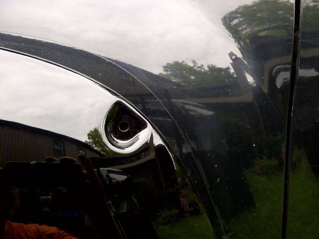

    I did the same thing as the front and marked where the pocket holes line up:
    They are much further off in the back but once again - that won't matter...
    Once concern is the bedside support to the front of the rear tire. I did not snap a pic of it but you can kind-of see it in the one above. It seems clear that if I remove 2" from the fender that it will no longer be able to attach. I'll have to work out a way to move it further forward - I can't see eliminating it completely without having a floppy bedside as a result!:p
    I plan to pull apart the passenger side tomorrow time permitting.

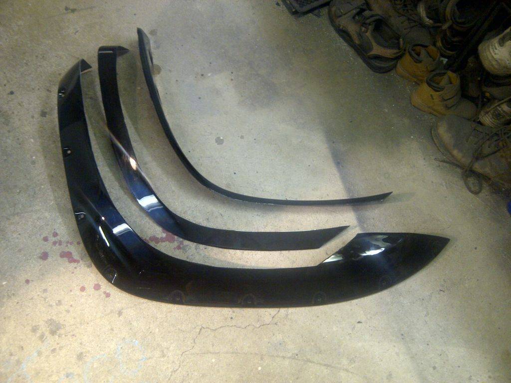

    I quickly sectioned the drivers side front... I'm just really trying to work out in my head how I want them to look. The fronts will be more complicated than the rear because I'm trying to integrate the flare with the Elite bumper. Therefore it will be "fatter" in the front an the section will cut away on an angle.
    Here's the 2" strip from the flare:
