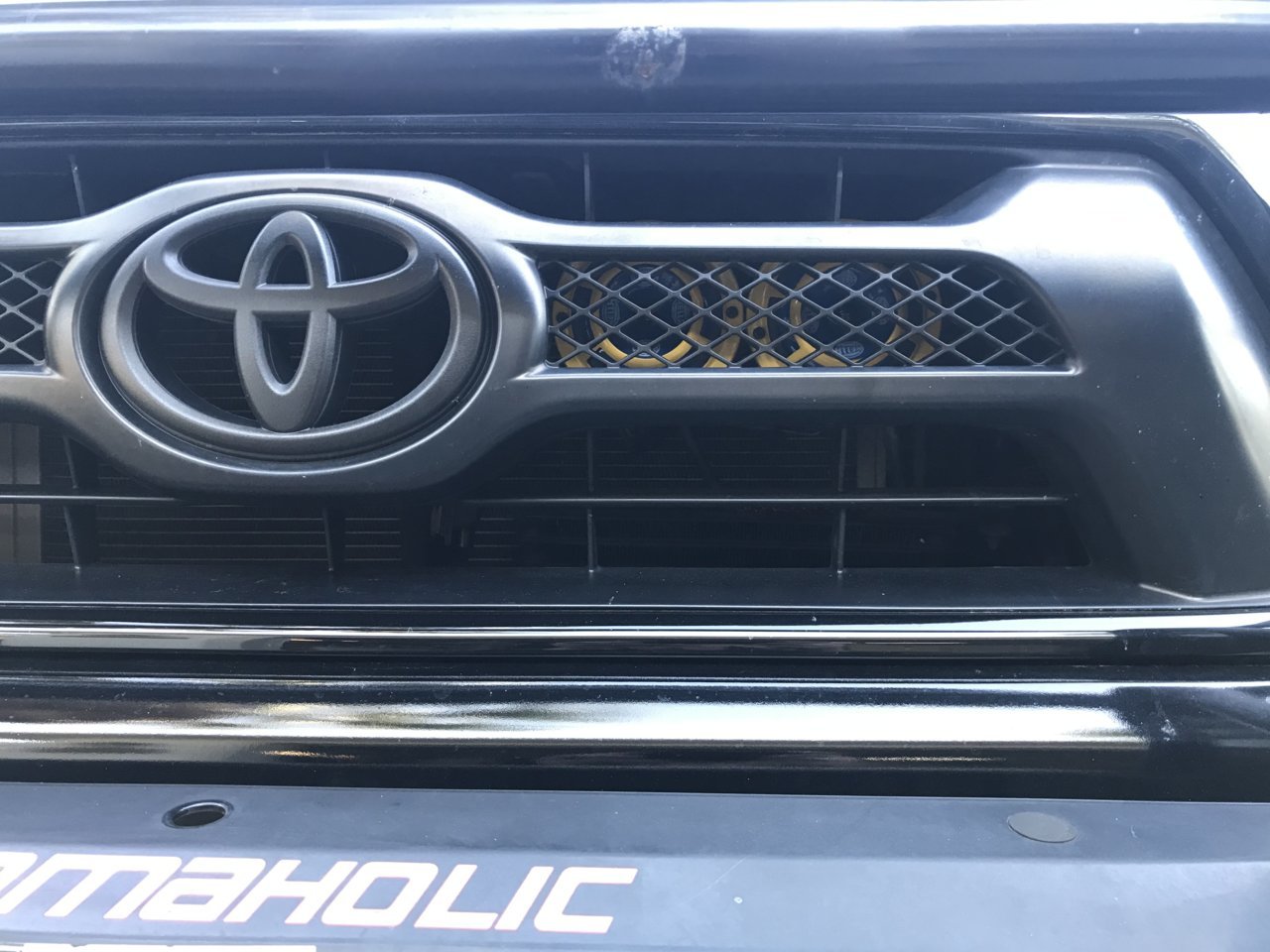

    This is today's morning install for my Taco.

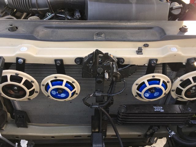

    32714637-4E02-4771-897B-2A669EF5BC02.jpg Sharptones ready for Florida Bluehair Battle!

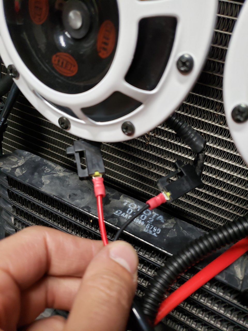

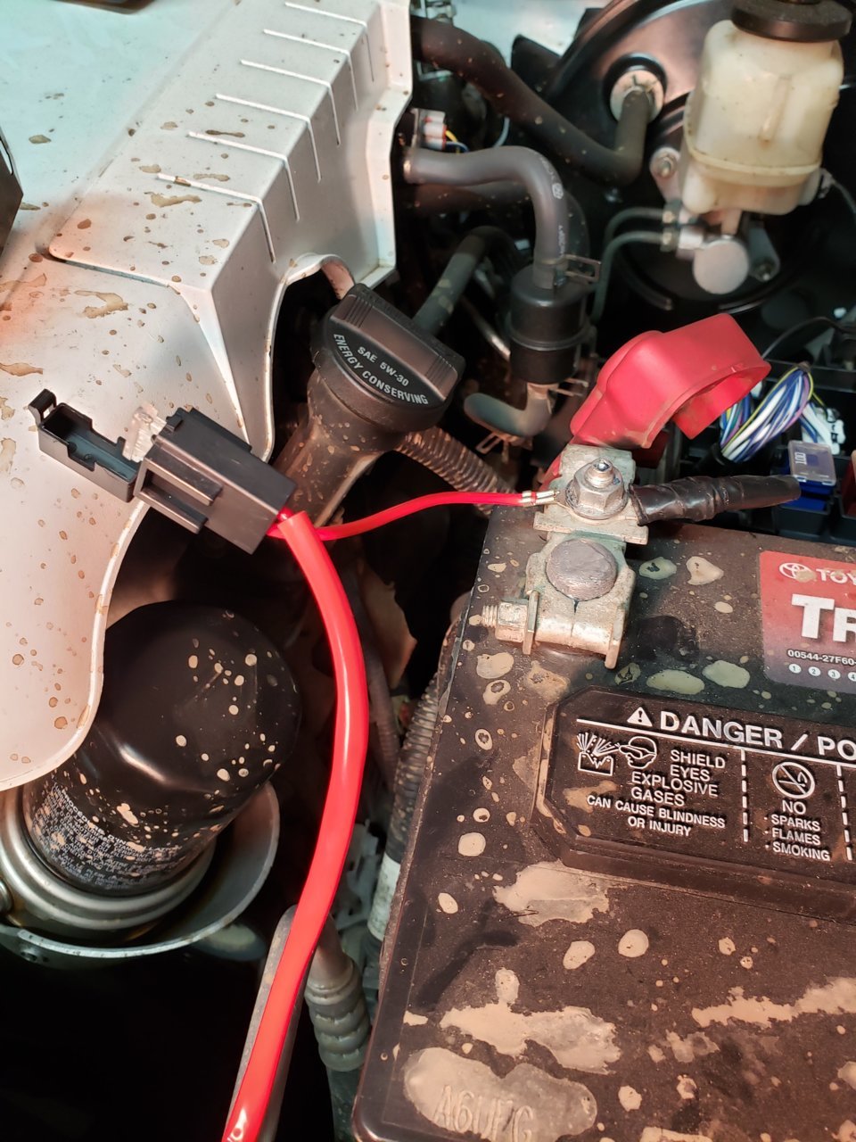

  15. Oct 10, 2020 at 5:00 PM
    #35
    Dmeezy333
    Dmeezy333 Well-Known Member
    Jan 17, 2019
    #279681
    430
    2015 White Tacoma TRD Sport

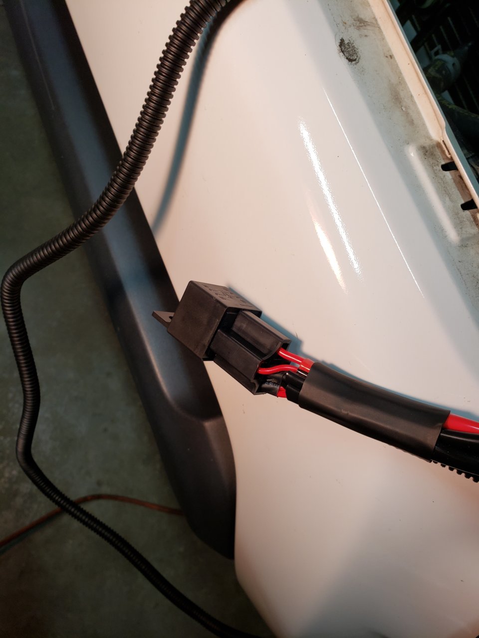

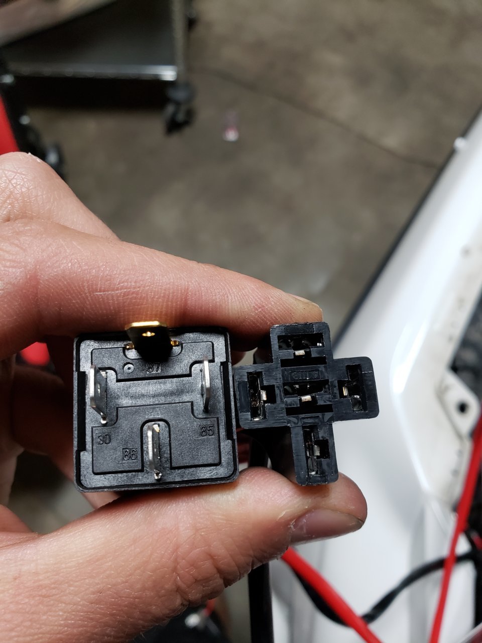

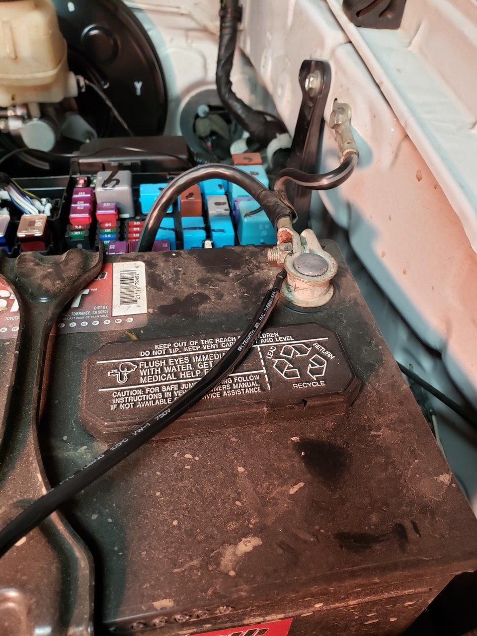

    Can someone please tell me, i dont know what I'm doing wrong. I have the Supertones with a wiring harness I got off of Amazon that has a relay. I have everything hooked up and still nothing... Please help. I'm using male connections to go into the stock harness because I don't wanna cut them off. 20201010_185414.jpg 20201010_185445.jpg 20201010_185452.jpg 20201010_185456.jpg 20201010_185502.jpg
  16. Oct 10, 2020 at 5:03 PM
    #36
    MESO
    MESO Major Modder Vendor
    Feb 16, 2015
    #148809
    16,292
    State of Jefferson
    2016 DCLB TRD HELLCAT SWAP
    If I recall I don’t think there is a ground connection up there so your first picture has red into stock connector and black into stock connector. Double check where that black wire is going if not a good ground, connect it to metal chassis.
    Skydvrr likes this.
  17. Oct 10, 2020 at 5:05 PM
    #37
    Dmeezy333
    Jan 17, 2019
    #279681
    430
    Okay. So connecting the ground to the battery isn't good enough? Just wondering, first time for something like this.
  18. Oct 10, 2020 at 5:21 PM
    #38
    SubaruTheTacoma
    SubaruTheTacoma [OP] SubaruTheTacoma
    Mar 1, 2019
    #284929
    468
    Rhys
    USA
    2017 STI Off Road
    HELLA Horns BP-51 ARB Summit SCS Ray 10 And many many others
    I would double check the harness from Amazon
    I’m guessing this is a ground issue like Meso mentioned

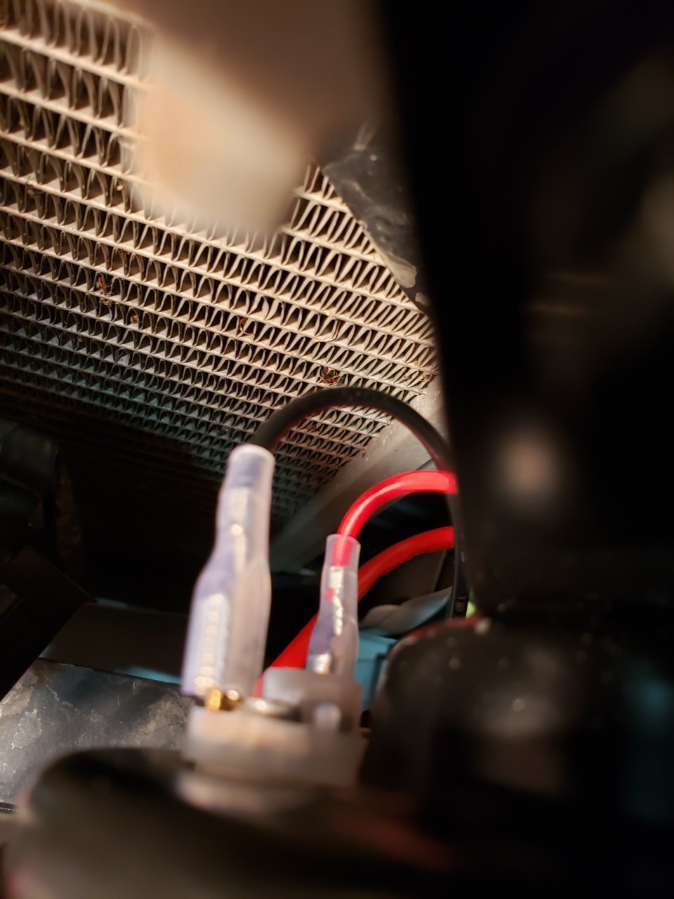

  19. Oct 10, 2020 at 5:27 PM
    #39
    Dmeezy333
    Jan 17, 2019
    #279681
    430
    One thing that I noticed is all the ground wires are going to this middle connection but that doesn't connect to anything.16023760109252332434462087308119.jpg
  20. Oct 10, 2020 at 5:38 PM
    #40
    SubaruTheTacoma
    Mar 1, 2019
    #284929
    468
    Rhys
    USA
    2017 STI Off Road
    Ya looks like wrong / bad relay harness
    good ol Amazon can be like that sometimes.
    when I got my horns they came with a relay from hella did yours?
    If you have it I would use that one if you are going to incorporate a relay.
    or maybe if you wanted to risk it for the biscuit you could use that harness you have for the + connections and then build a ground harness like in step 2 of the Original post and use that for the grounds.
    I’m not 100% that would work but it might be worth a shot and i think I saw a fuse sooo chances are your truck won’t explode.
    @MESO might have a better suggestion
