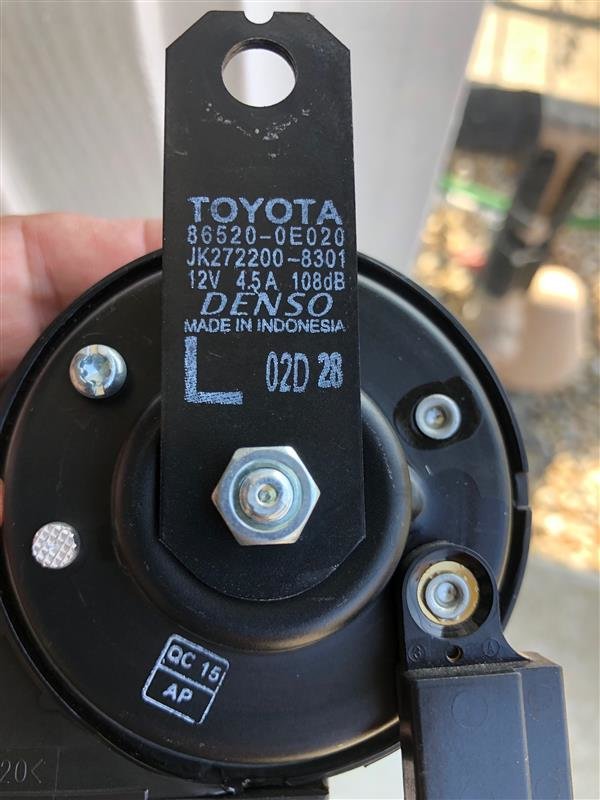

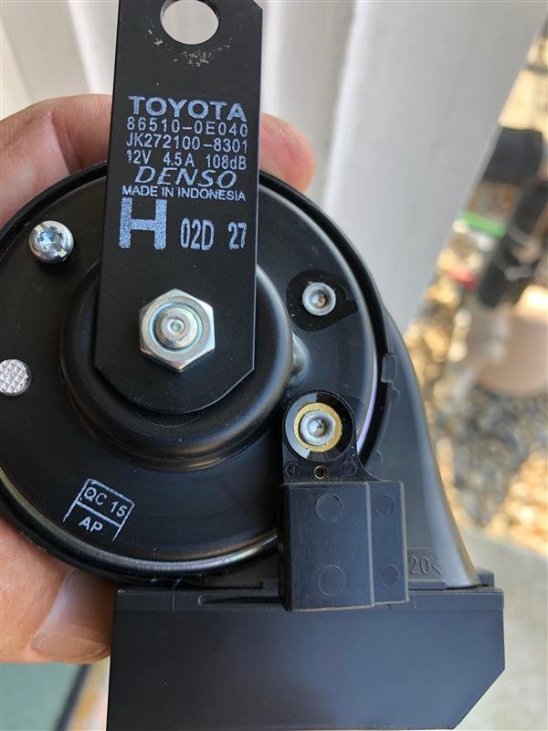

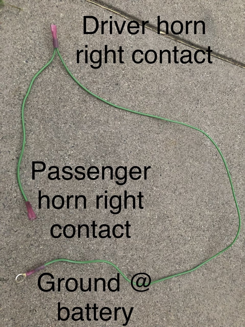

    Guy
    2020 SR5 4x4 v6 w/predator package & midnight black metallic
    TRD Skidplates (Front/Back) Predator XP package

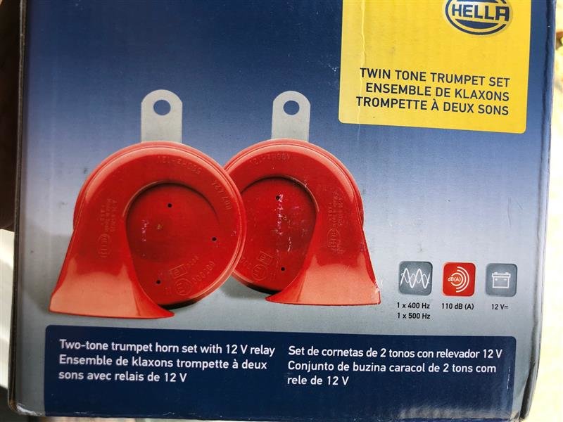

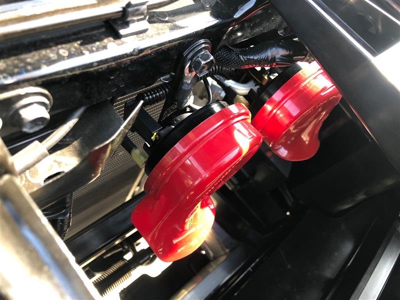

    I just replaced the stock horns with the Hella Horns and then grounded them and re-used the original harness wires. They sound a lot louder and are dual tone as well. I believe the stock horns are not dual tone - but the Hz is not listed for the part numbers - so it might be the same. All in all - they are 4 DB louder (as a pair) than the stock horns.
    74b29269-172a-4f7d-adf0-69a11ba512cd.jpg c5f2a7cb-295c-4e54-835e-13b6808a2673.jpg
    bc57fd80-5bef-4cc6-95f0-b13493ec0481.jpg 294f39e7-d130-4f4a-a921-331947447d8e.jpg
    El Tano and Dmeezy333 like this.

    Does anyone know what the Hz is on the High and Low?
