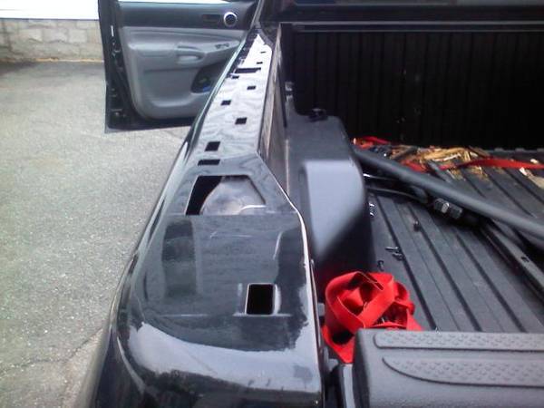

    Not the best pics, but this is what is under the plastic caps. As I recall the metal feels flimsy. I would want to reinforce it. The fender rolls over the top and bolts to the plastic bed where the rail goes on. Was thinking of doing something similar with the angle iron but inside the fender.

    When I had my tool box mounted in my bed I drilled through the top of the bed sides and used a piece of 2"x4" flat steel stock under that thin metal to give it enough strength.
