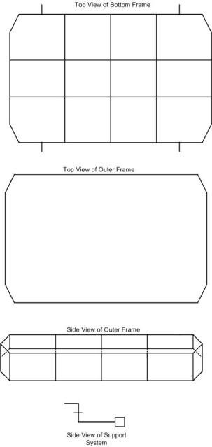

    I sorta have a blueprint made I'm adding in the measurements now

    sick man, i can't wait to see how it turns out. are you ganna make it the same size as mine? also one thing to take into consideration; remember how with basket at the same level as the rails, you won't be able to fit a cooler under it. unless you have a cooler lower than mine. cuz we ran into that problem at my house.

    Yeah its going be the same size.
    Oh yeah I remembered that because I'm making it so I can side this hardcore plastic tub under it to hold my new camping junk. Its like a Action Packer but bigger stronger and cheaper then the xl one.
    Can you tell me how wide the part is where you mounted the hi-lift whenever you get a chance.?

    How wide is the part that holds the jack. like the width of your jack basically.

    it's about 1". but u'd be better off going a little wider, cuz the jack is just as wide so it gets jammed in even when i un-bolt it. like a 1 1/4" would be good
    and don't make them too tall. the one next to the base can't be more than 2 3/4"
    but i made mine a little more complicated then they needed to be
    i made an H so the jack sits in the hopen top and rests on the horizontal piece....not sure why i did it that way. so the overal hight it 3 3/4, by the jack only takes up 2 3/4"

    Cool Thanks.
    You know how you welded the spare holder on to the frame? I think I'm going to make it so it can be a bolt on so if I want to use the basket for other stuff I can take it off and not have it sticking up.
