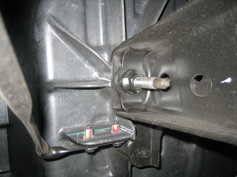

    i was going to carry something in my truck the other day and i did not have any thing to strap it down to up by the cab. so i got some tie downs coming like the truck comes with by the tail gate. im going to use the bed bolts that holds the bed down. i seen other people doing it but they say the anchors dont move. so im thinking of installing a bushing where it holds the bed down and the Tie Down Anchor will be able to move. so the bed bolts will be tight. my question is are the bolt long enough where they come down out of the nut. the spacer will only be 1/8-1/4 long.
    i have a bed cover so i cant use the Cleats to hold stuff.

    This is actually a good idea. You may need to enlarge the hole in the tie down anchor plate to fit around the bushing of course. The bed bolts have a lot of extra thread:

    There's about an extra 1.5" on the bed bolts to spare

    nice pic!!! i 've been wondering about that too but haven't taken the time to crawl under my muddy truck.. :anonymous:
