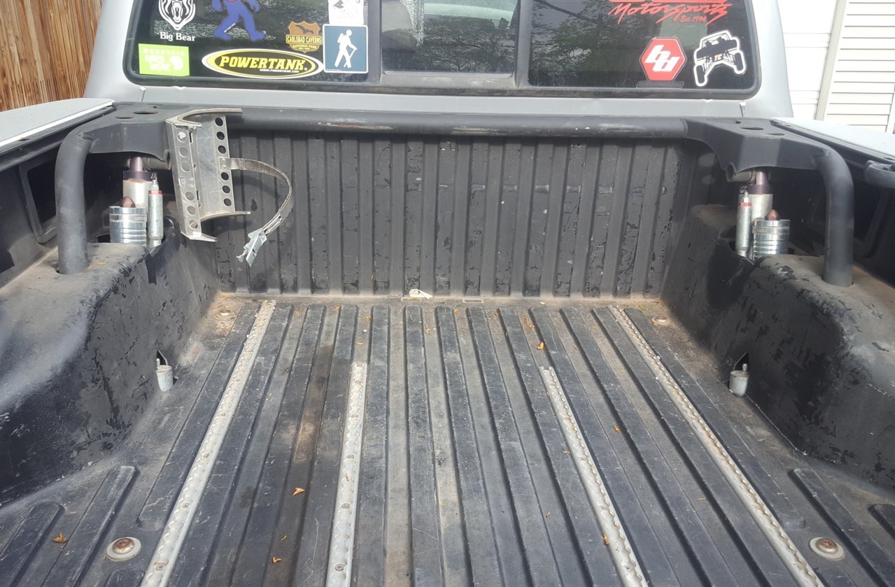

    I still put two full size dirtbikes, fuel and gearbags in

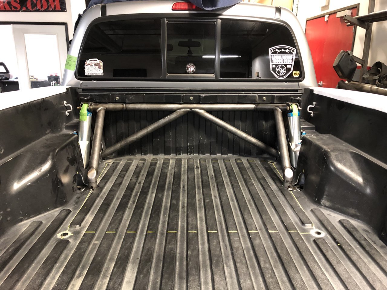

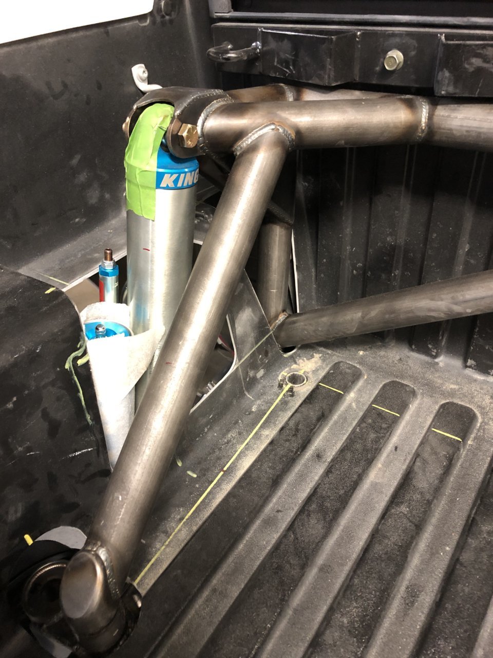

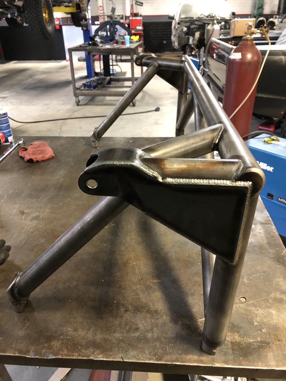

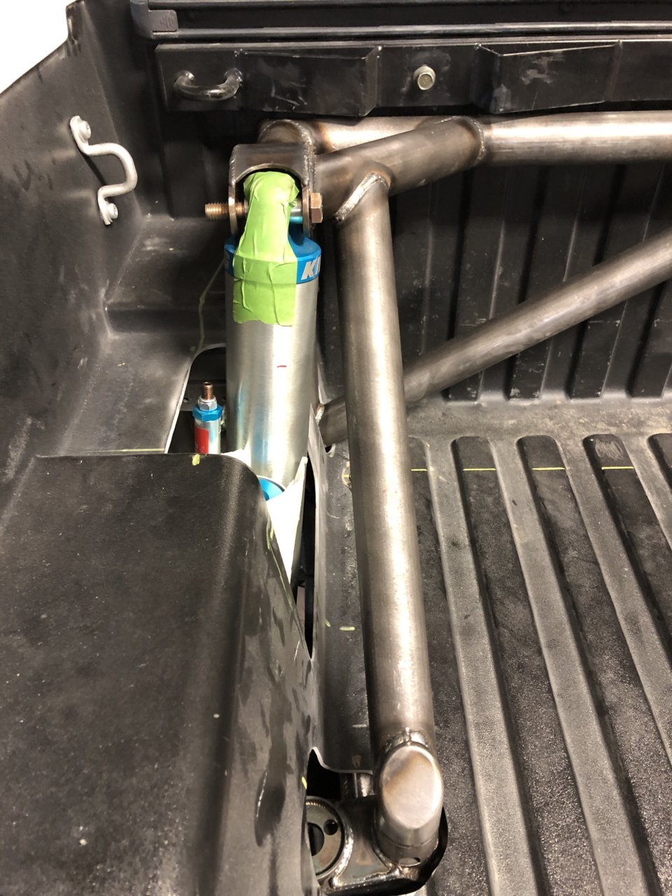

    I heard you guys like bedcages :bananadance:. Here’s mine that SMP is building :bowdown:

    I really like that keeps the majority of the bed still usable.

    @nate232 thats a nice setup bedcage you got back there.

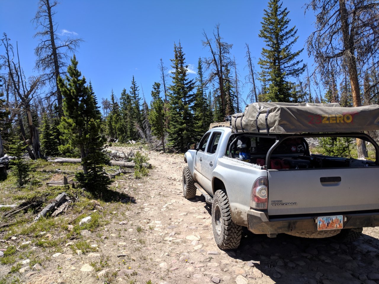

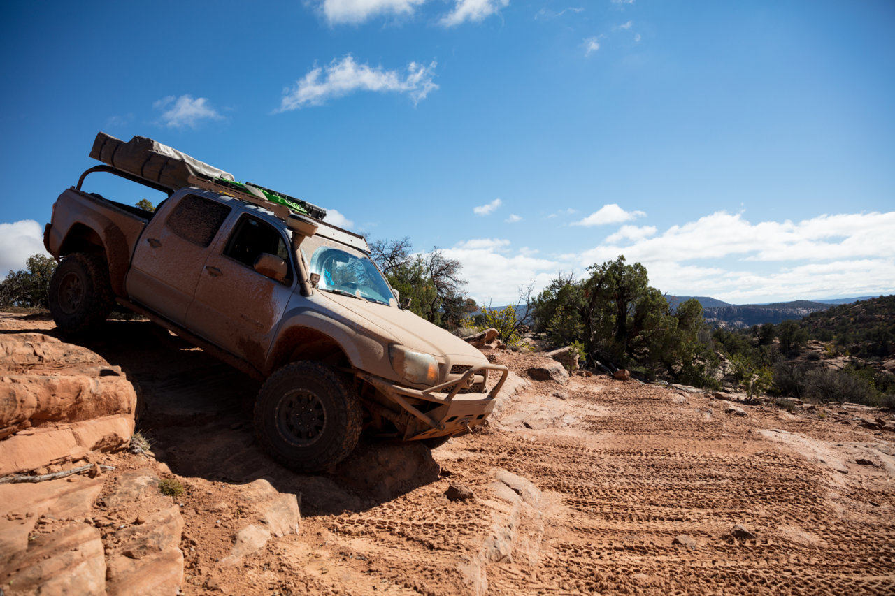

    Here is my Cage, originally done by Solo Motorsports when I lived in California. Bed is 100% useable. Frame is boxed from the cab back. I also run a full size 33 (255/85/16) tire under the bed. It is actually shifted back so it doesn't hit the rear axle at full stuffs. I also designed a bed rack for my tent. It bolts onto the bed cage and then to the factory D-ring locations near the tail gate.
    Probably the best mod to the truck bed has been the L-track that is in between the channels of the bed. I use them from general home projects to securing camping gear.
    I have Mud flaps now, so the truck doesn't look like I murdered something when I drive through mud.

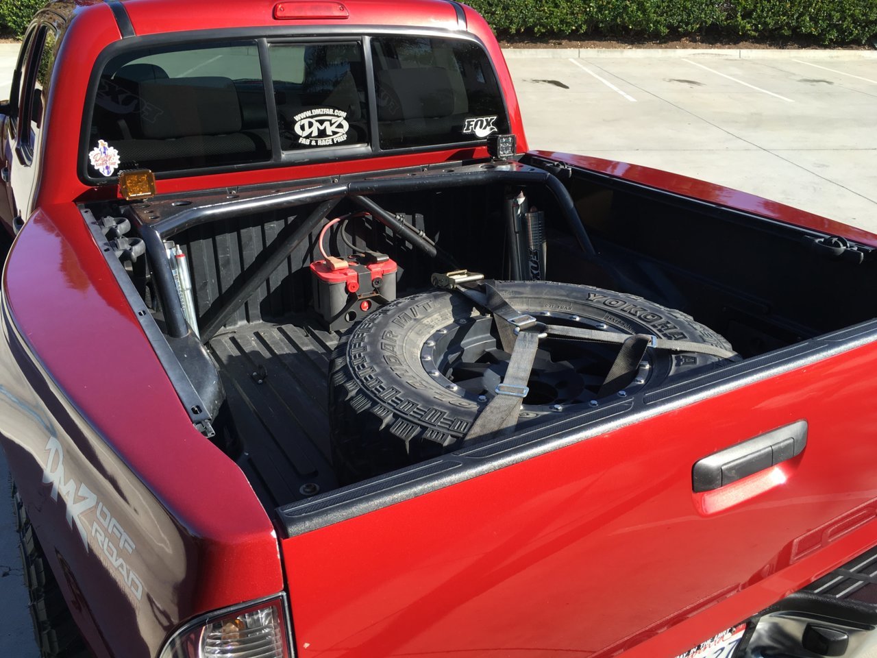

    DMZ bed saver
