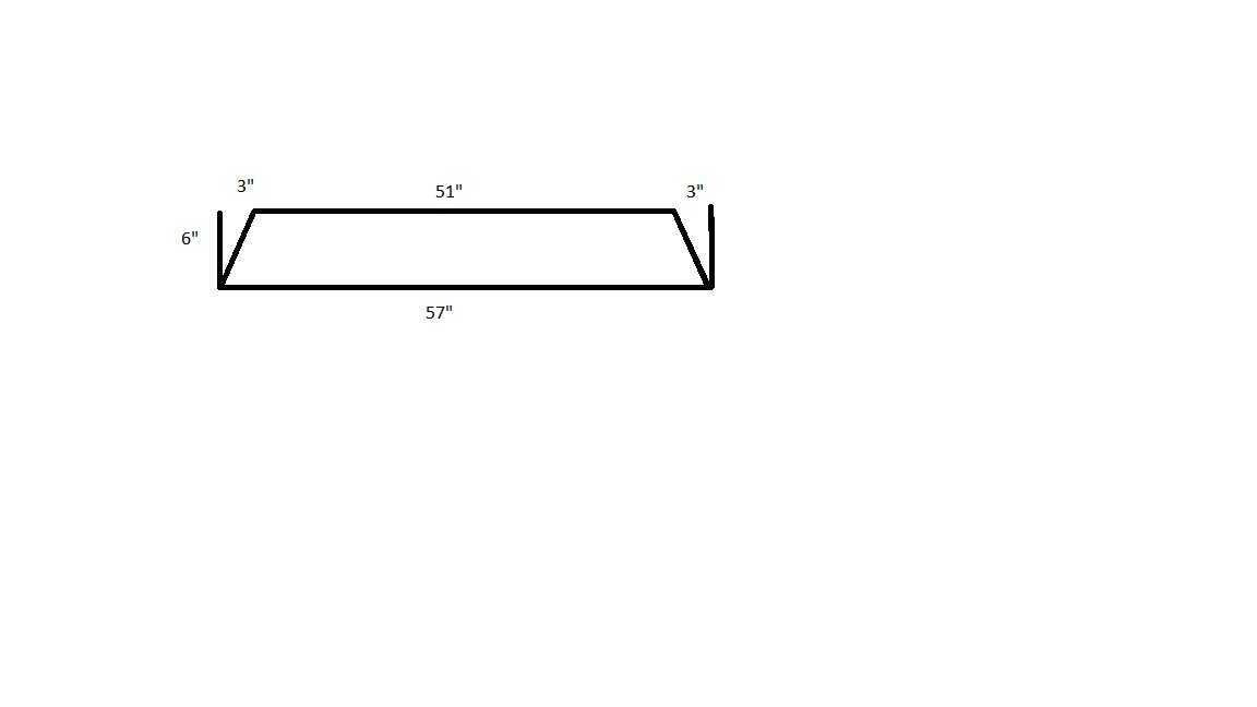

    Not sure if this makes sense, but this is what i want to build. Just don't know how to figure out the angles of the uprights of the length they should be to rise the bar 6 inches above the angle iron which will be and the bottom of the angle pieces. bar.jpg

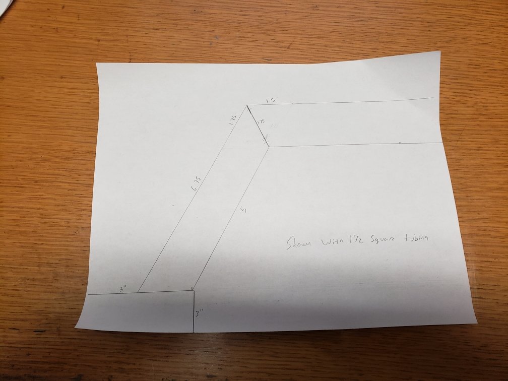

    That upper angle should be ~116.6 degrees (arctan(3/6)+90).
    That lower angle (right wall of the tube to the right wall of the angle) should be ~153.4 degrees (arctan(6/3)+90). The actual cut angle on the lower left corner should 63.4 degrees from the left wall of the tube.

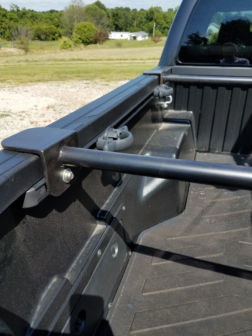

    These are how mine attach to the Bedrails.

    Thats how I plan to attach mine, but they will extend up by 6 inches.

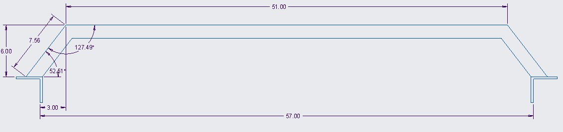

    Sorry, keep deleting it thinking I got the measurements off. Here it is again, with angles.

    will the top bar come out at 51"?
  14. Feb 21, 2019 at 11:46 AM
    T6A1C9O
    T6A1C9O Well-Known Member
    Nov 25, 2016
    #203232
    297
    San Diego, CA
    2017 SW DCSB TRDOR 4x4 w/Tech
    To get to the 57" mounting face width that angle might actually need to change. Let me do some tinkering and I can get you the angle to keep 51" and 57" lengths.

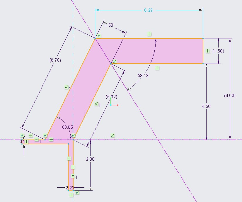

    This should hopefully get you there. My original angles assumed the centerline of the tubing was angled 3" to the right, which isn't really accurate.

    What angle should I set my saw to to achieve that? I could always blow this up and trace that way too.

    For the upper angle, you want the area of the faces to more or less match, so you have to cut the total angle in half (~63.75 degees). My fab skills are almost non-existent, but from my limited understanding you'd be better off rounding down to 63 (or even slightly smaller) to allow for expansion during welding.
